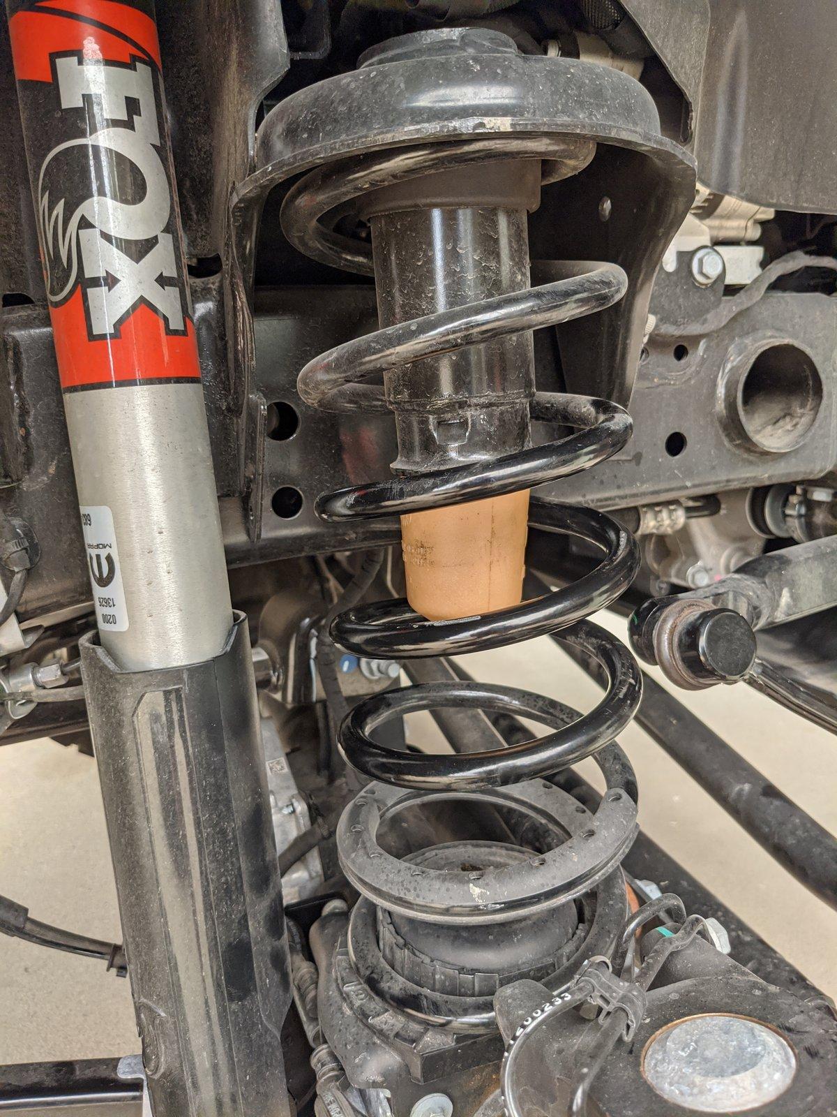

Pulling the tire after disconnecting the swaybar on the passenger side, I noticed there didn't seem to be any reason I couldn't squeeze the factory bump stop out. Then I lubed up the TF unit, shoved it through the springs, and jammed it in the socket (silicone spray). I had to use a torque wrench with a big flat head to lever the bump stop up, and a channel locks to wiggle it round, but it eventually seated into the socket. The driver side was easier because I could run the channel locks right handed. It's REAL obvious when the bump stop seats.
Before:
Jeep Gladiator Terraflex Progressive bump stop kit - ridiculously easy to install IMG_20200912_142732

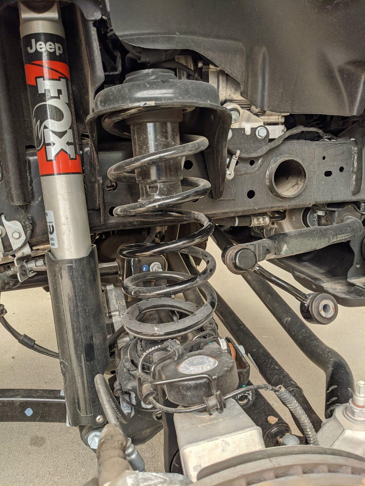

After, with minimal fuss:
Jeep Gladiator Terraflex Progressive bump stop kit - ridiculously easy to install IMG_20200912_144845
Metalcloak apparently has the same kind of deal, so it doesn't really matter what you use, but upgrading from the OEM units is a trivial exercise.

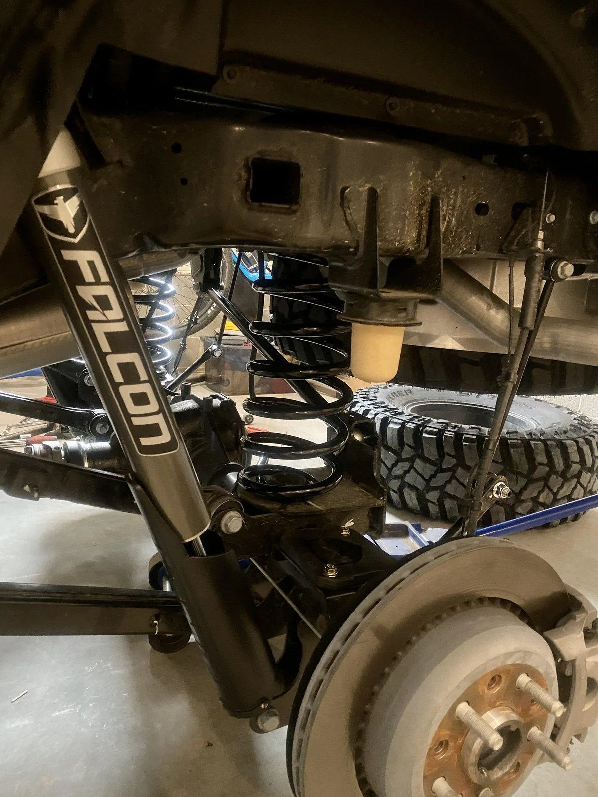

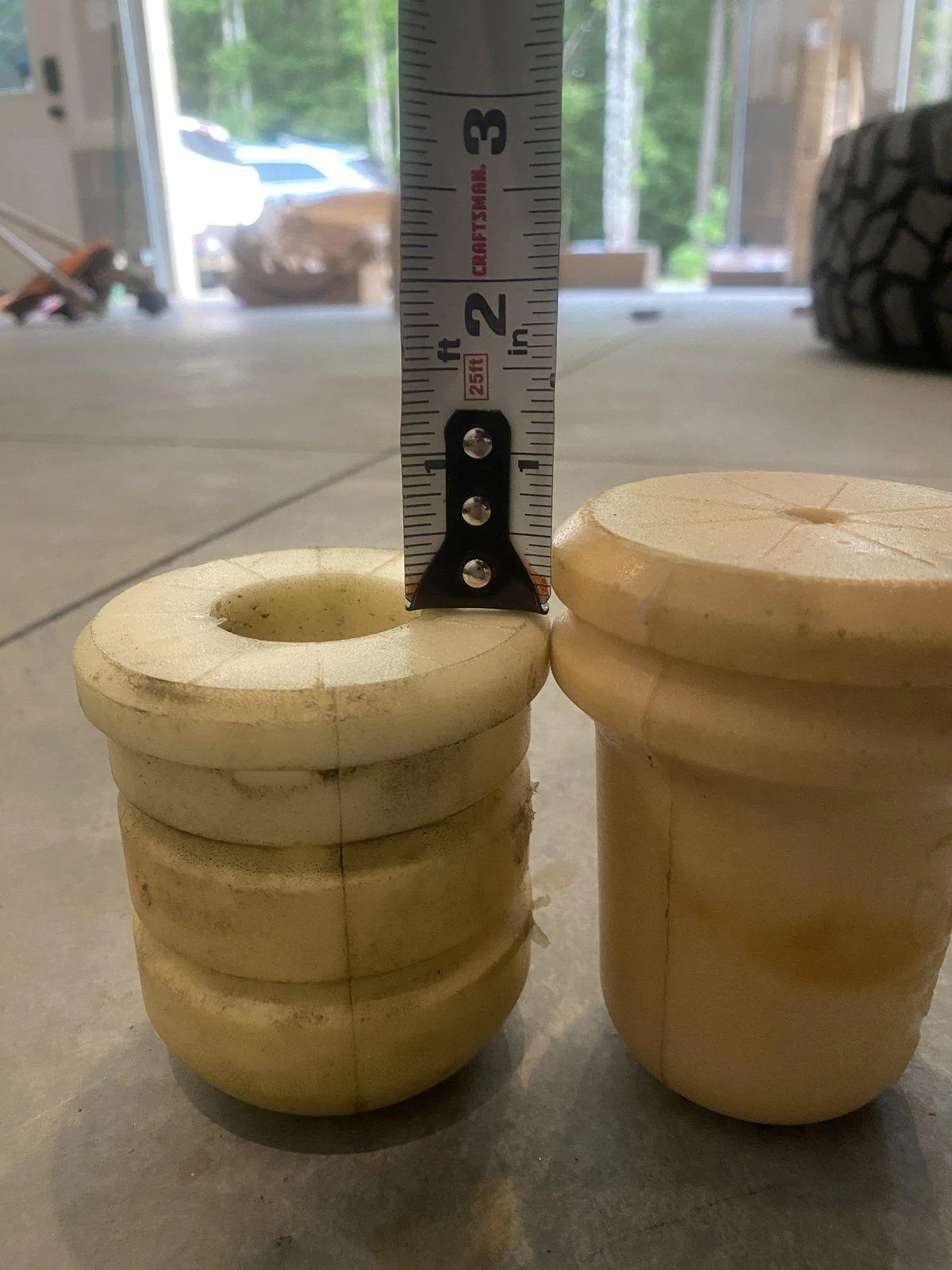

Anyone else running the rear Teraflex bumps? Im confused because they say they are 1.5” longer than stock.
Well, my tape measure must be off? Are the FACTORY Rubicon bump stops longer than the other variations or something?
I’ll call Teraflex tomorrow.
