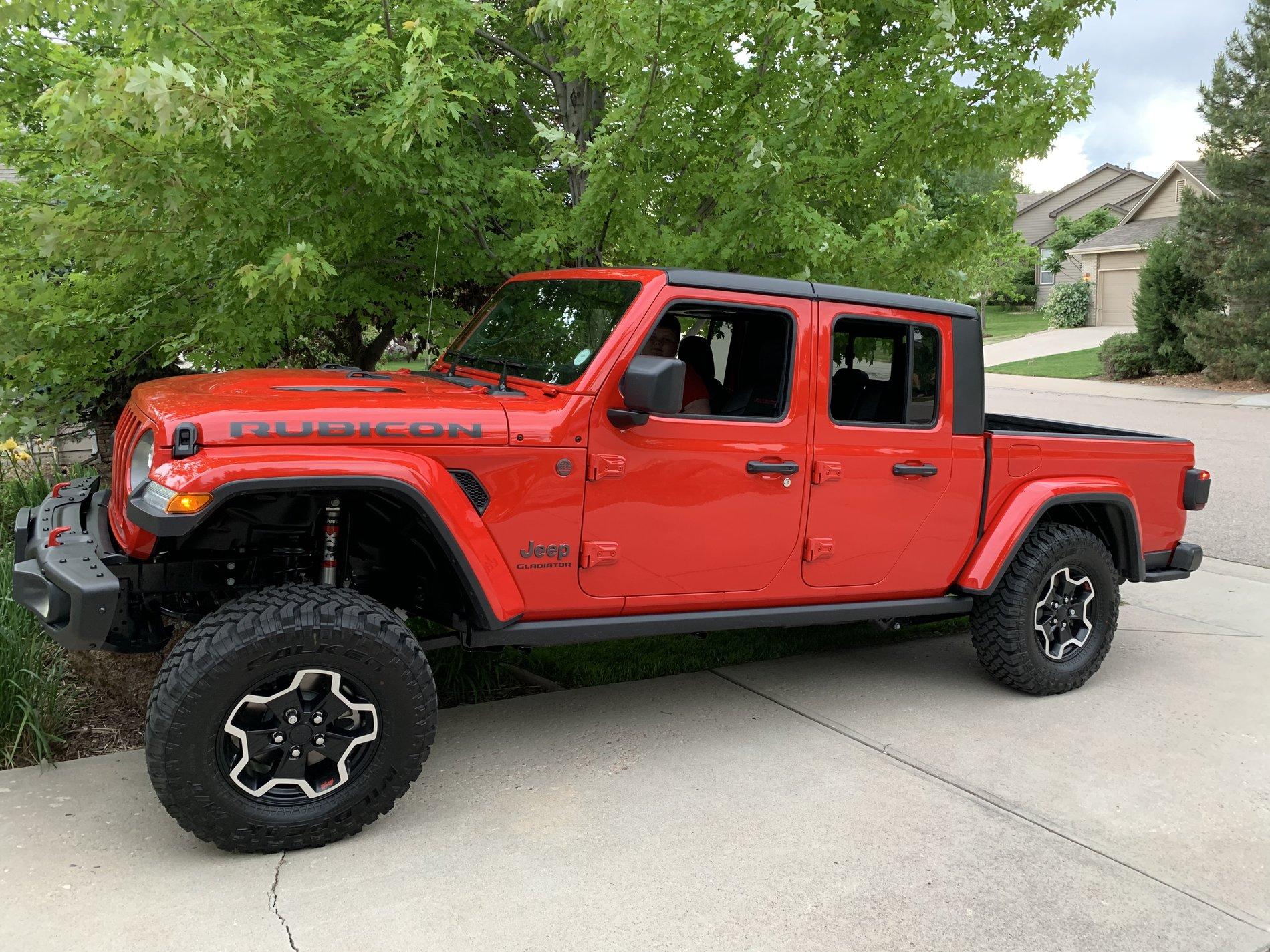

My build is very particular and might be different than what you build. My build is designed for not just off-road, it’s built for on road. My opinion is that jeep dropped the ball on some the most important features and I have upgraded those pieces to make a truly performance geared rig. I haven’t gone overboard but there is many key things that affect the comfort, steer ability and handling (these are the main things everyone complains about!) I will say it and say it again… you bought a $40k+vehicle and you need to fix the things before or during when you doing lift components. A complete lift includes steering components… period. Again IMO****
And now… my build…
The royal mods to her highness… The short version… updated 07-23-22
Metalcloak 3.5” gamechanger lift, undercloak full skid plates, rear diff skid plate, front/rear durospring bumpstops, front and rear diff covers, overline rock rails
Rockjock antirock rear swaybar
Rockhard front LCA skid plates, rear LCA and shock skid plates
Artec FAD skid plate
Rusty’s rear frame LCA skid plates
DRT Fabrication hitch skid
Redline Tuning hood struts
Falcon 3.3 sp2 shocks in longest length
Falcon Nexus 2.2 steering stabilizer (JK version)
Teraflex JL/JT crankcase/pcv valve system
Steersmarts tierod, flipped draglink, trackbar and raised trackbar bracket
Synergy sector shaft/frame brace
EVO front axle truss
Adam’s 1350 front driveshaft
Volant CAI with power core filter
AFE Mach force-XP high tuck catback
Warn winch plate
Smittybuilt x2o 12k synthetic winch
Factor55 grey e-link
Maximus-3 red fairlead
Mictunning 20” led lightbar
JCR falcon 3.3 ready front inner fender liners
Tazer mini
37x12.50r17 Mickey Thompson Baja boss at’s (former Nitto ridge grapplers)
(Former Dirty life DT-1 17” grey wheels in DOT mode)
Black rhino sentinel in black -18 offset
Apex rpv air down valves
37” BFG KM2 spare
Pixel decals matte black hood blackout
Matte black fender vent blackouts
Bestop premium twill sunrider
Oem twill soft top with tinted rear window
Uniden cmx760 cb and external speaker
Firestick NGP 3ft cb antenna with hood mount
Midland MXT275 gmrs unit with ghost antenna on an Amazon bracket
ARB twin compressor with passenger underseat mount
Rugged ridge hard trifold tonneau cover
Rugged ridge entry guards
Rugged ridge rear plastic inner fenders
Quake led smoked drl fender chop brackets
AVS wind deflectors
DYI unistrut trail rails
Builtright Industries side Molle panels with brackets
Teraflex unita trail rails cleats
Escort max cam 360 radar/dash cam
Bulletpoint rail with cell phone & GoPro mount
Idrive throttle controller
Red/black paracord grab handles x6
Split rubicon fenders with homemade aluminum washers (they bolted down now)
Oem 392 wrangler heated steering wheel with paddle shifters and colored red thread.
Threedom paddle shifter covers
Oem steel steering gear and pitman arm. (Pulled the aluminum out for spare)
Various stickers
eBay steel bumper bar
TMC customs derlin hinge liners
Kickbax foot peg/mirror mount with rugged ridge mirror for when doors off
Amsoil synthetic atf in transfer case, severe gear oil front/rear differentials
Now please … allow the queen to stun you from her days of starting her reign as a queen… to how she sits atop of her throne now.

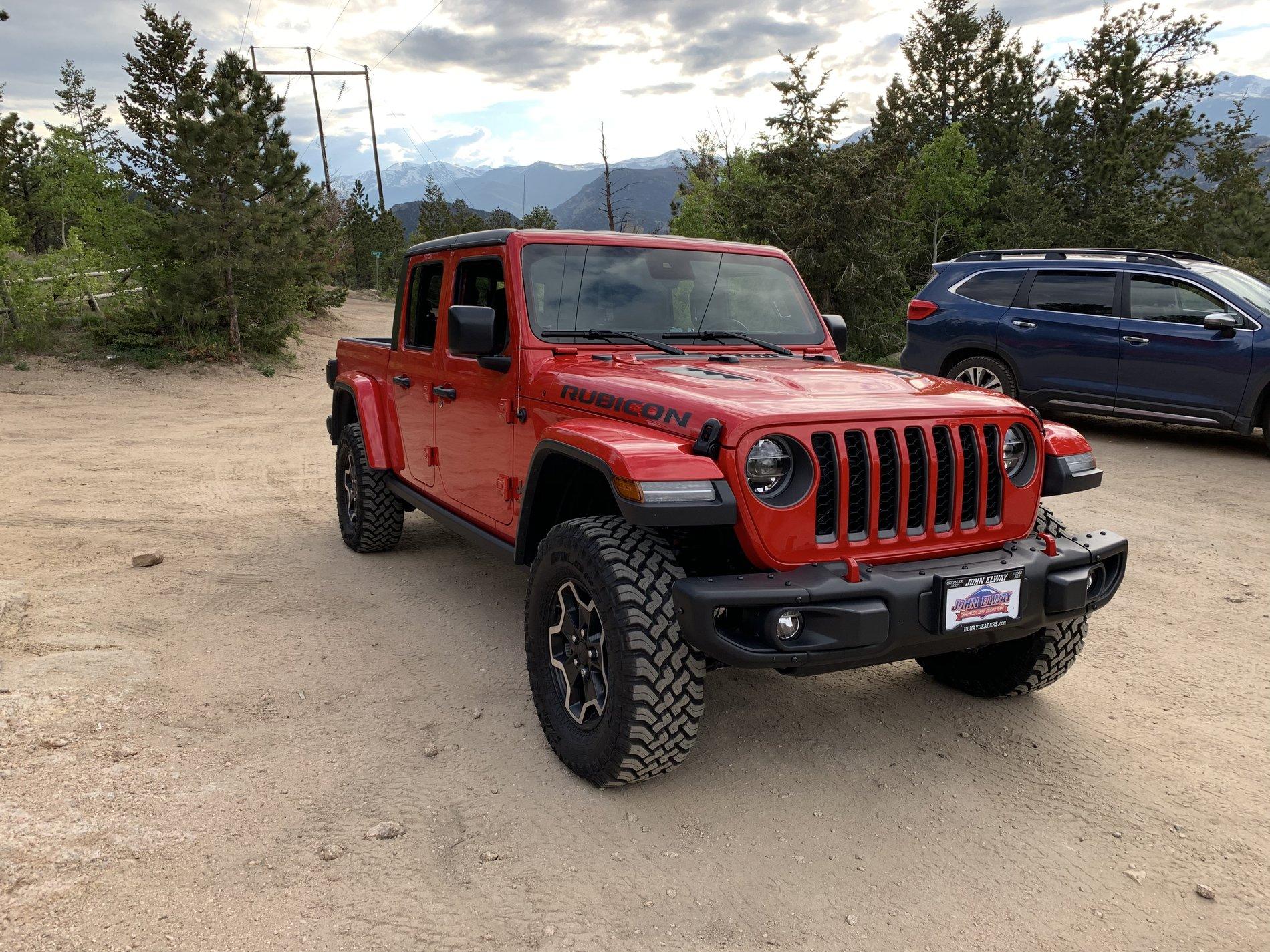

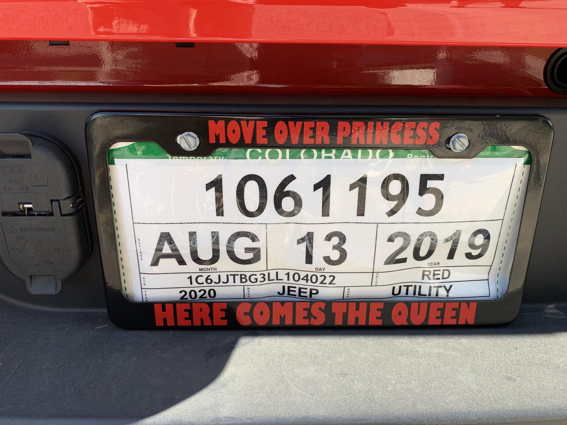

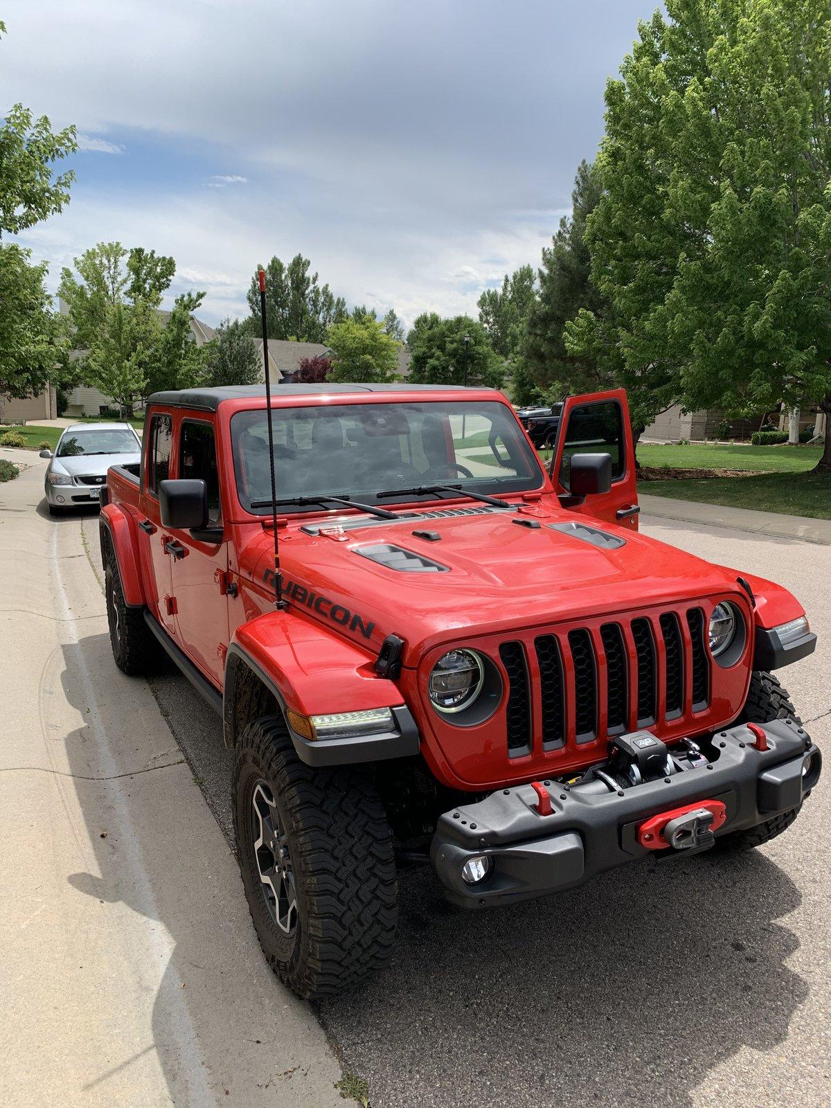

2020 Jeep Gladiator Rubicon in firecracker red.
She’s a beauty and my 4th build of a Jeep.
Definitely going to keep it simple but done the way I want it.

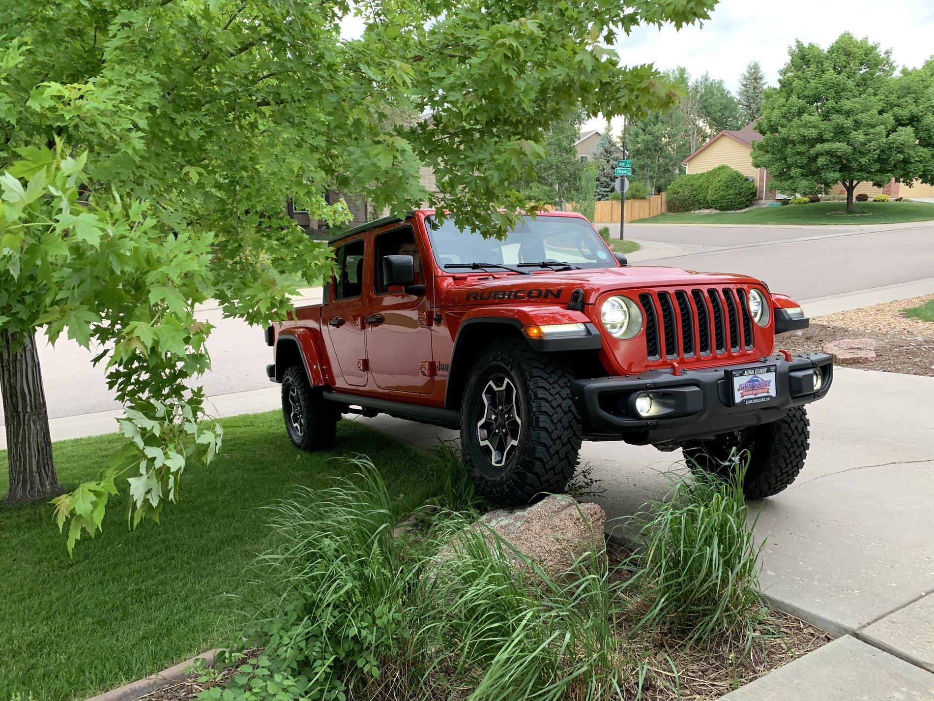

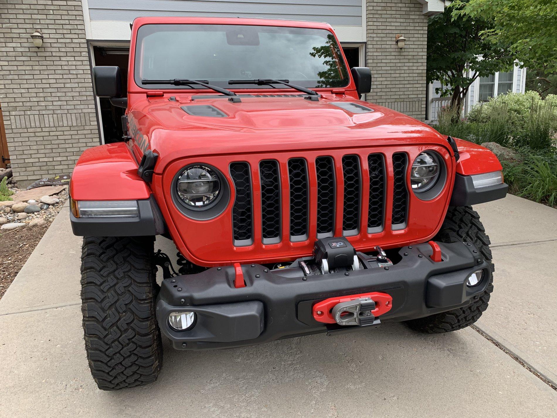

Day one... coming home.
Jeep Gladiator The “Red Queen” -build and journey 1B4294A4-7C54-40F5-87D1-A54D3A0968E6
Jeep Gladiator The “Red Queen” -build and journey 8C81F2EC-8575-49CE-A9D9-604B670468A3
Jeep Gladiator The “Red Queen” -build and journey C4CBBD4F-5D9E-4F74-A6E8-9C5391340222
Jeep Gladiator The “Red Queen” -build and journey B0546EAB-936D-403B-9229-82082D814E59

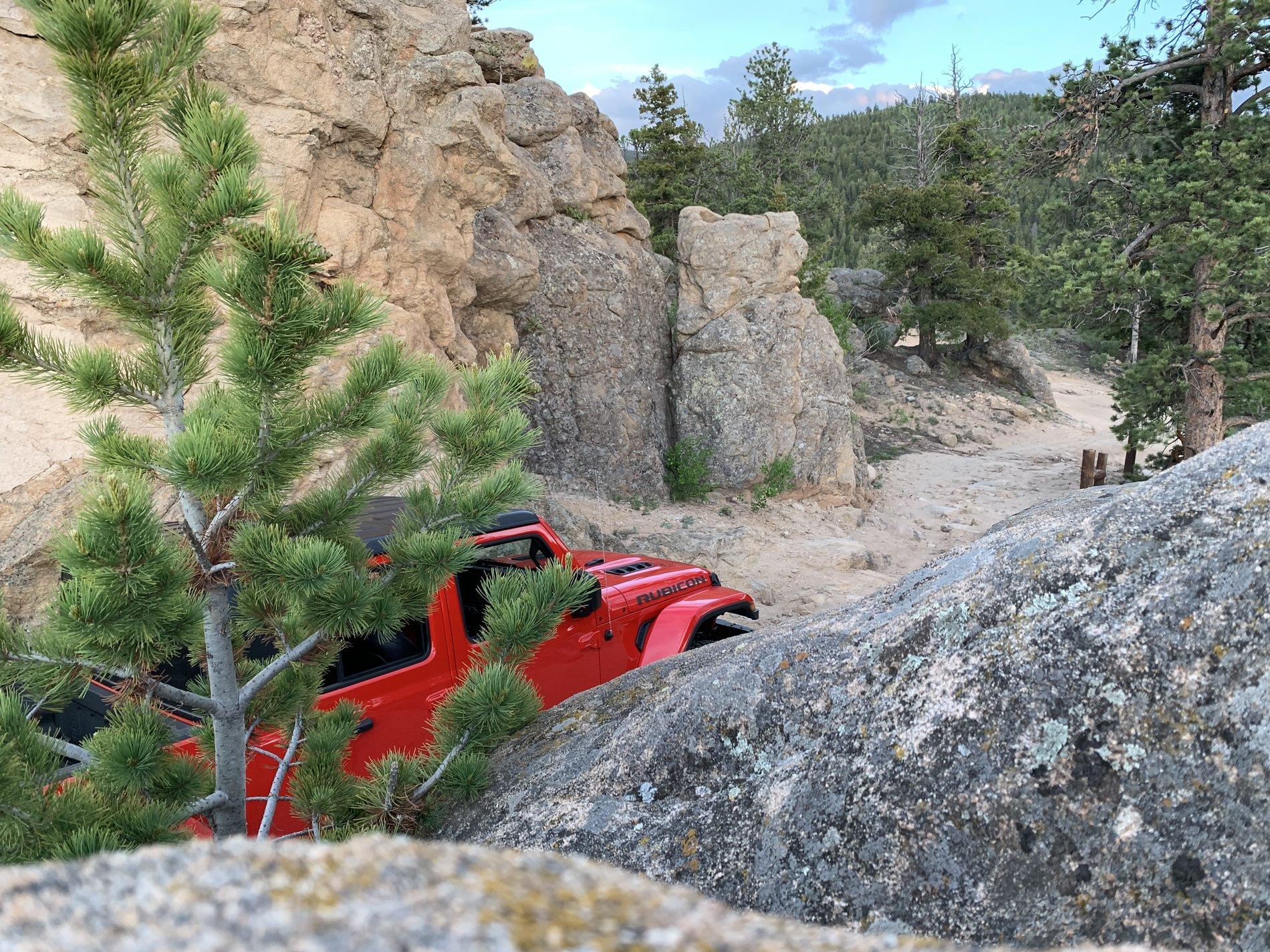

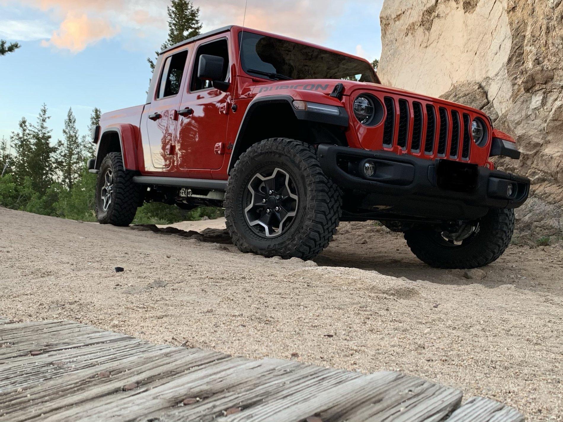

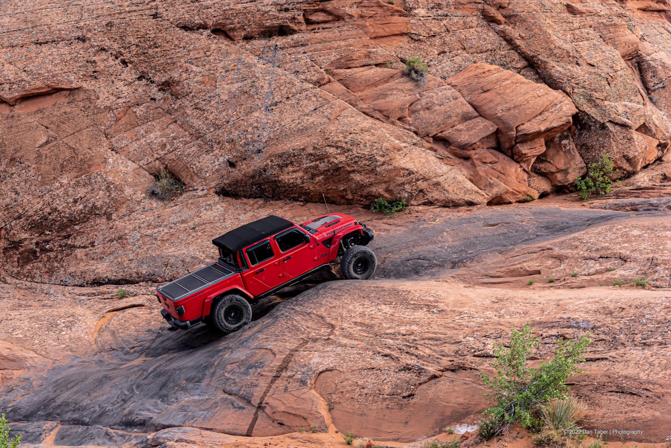

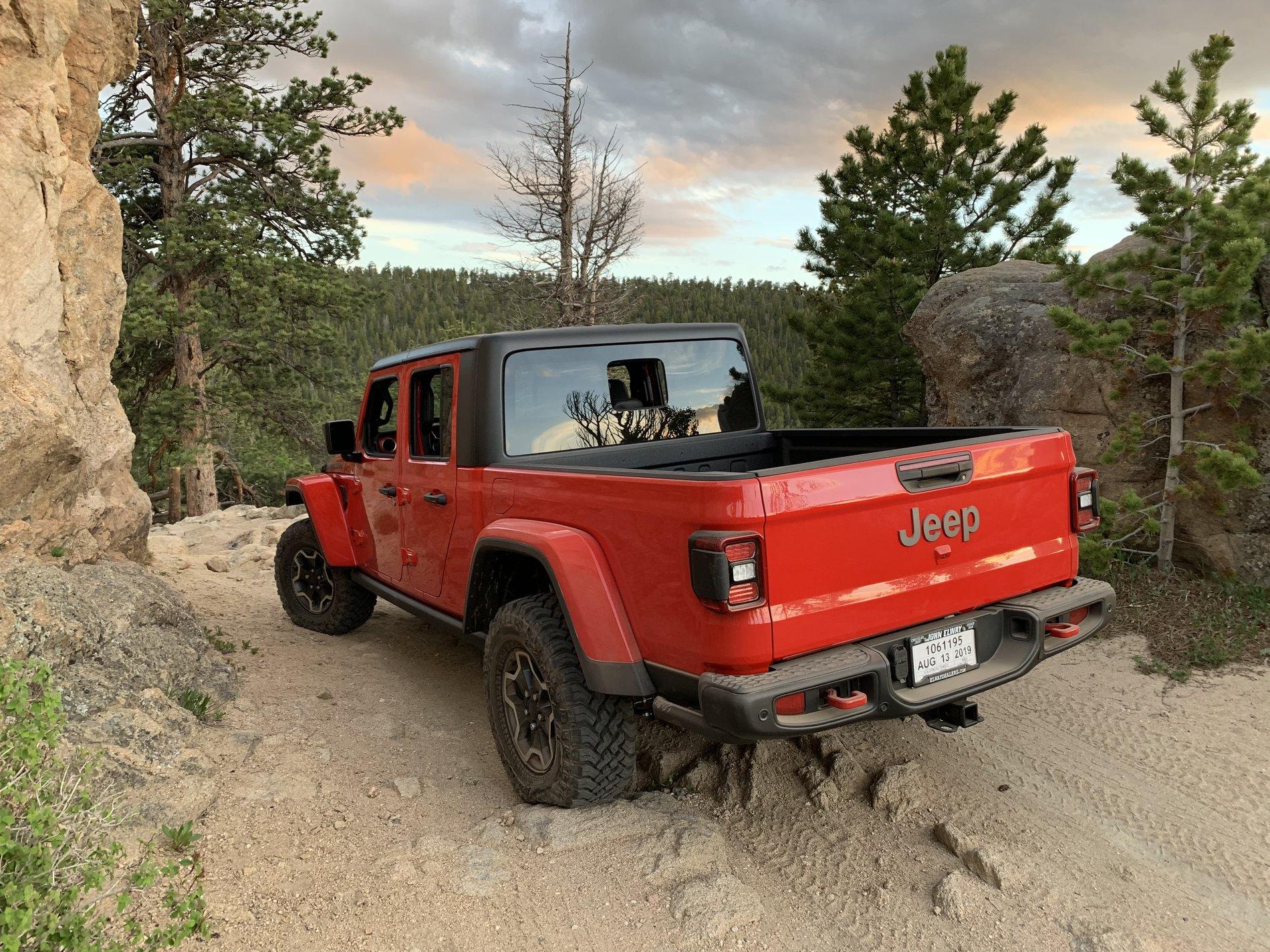

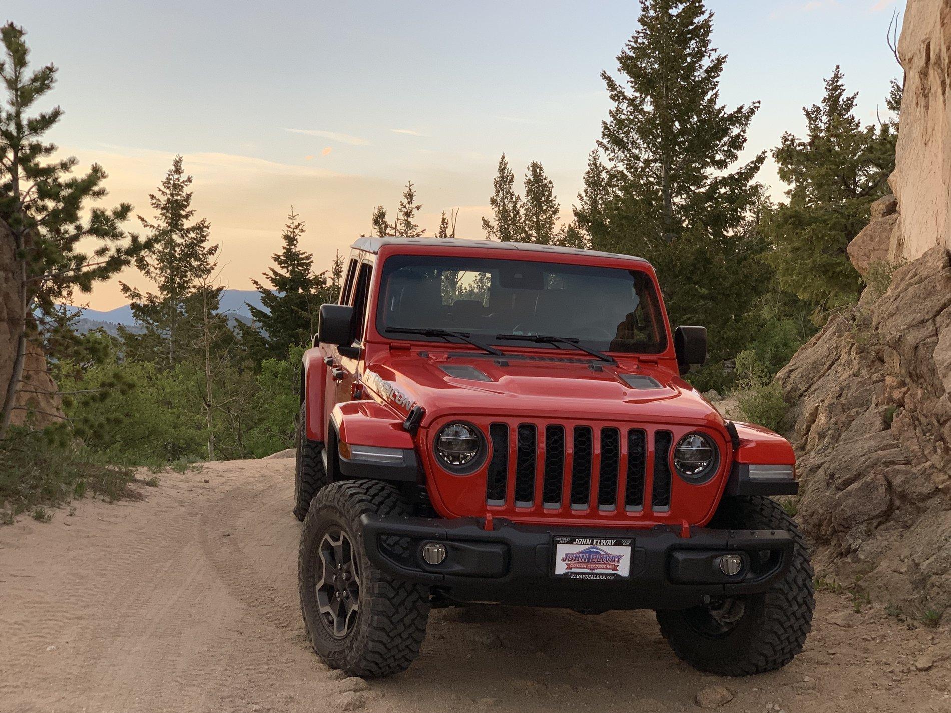

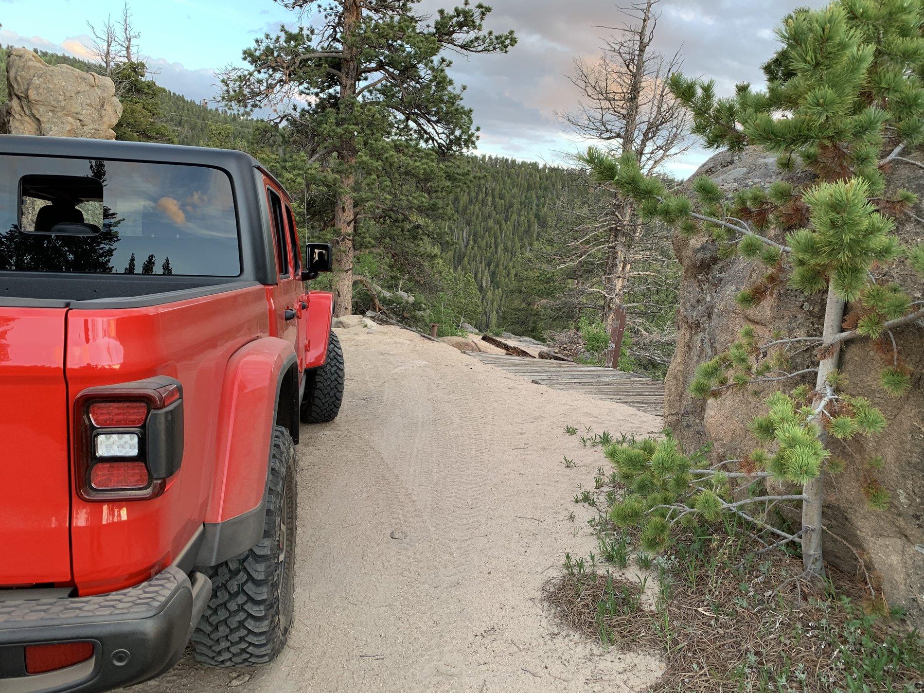

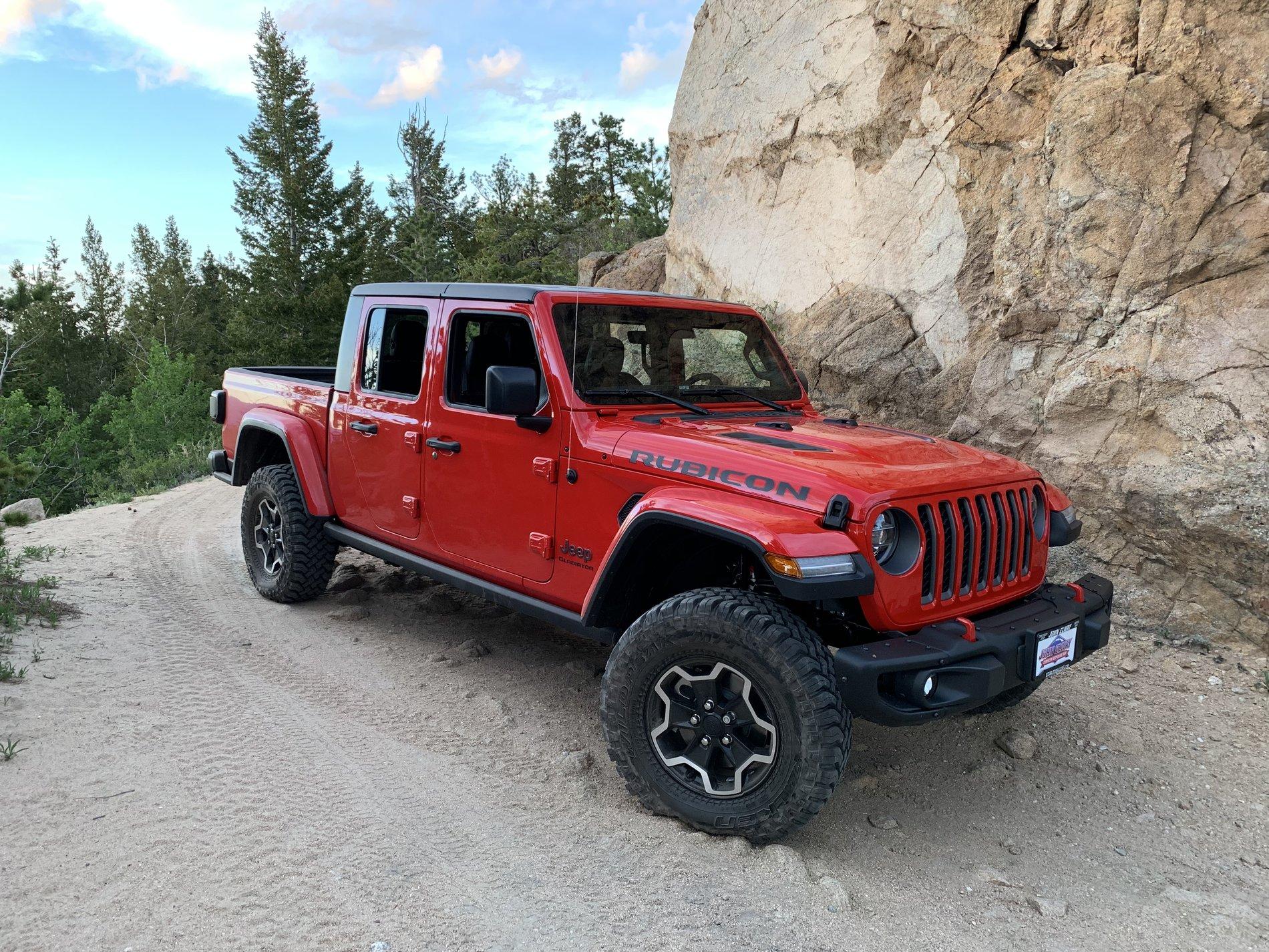

Day 2... out on a trail... wait... what... she ain’t a pavement princess!
Jeep Gladiator The “Red Queen” -build and journey 4A038678-4D29-45B7-9148-3BDB293F0159
Jeep Gladiator The “Red Queen” -build and journey C63FE2D9-6B85-4CEE-9AEA-4349CA8CB943
Jeep Gladiator The “Red Queen” -build and journey 3BA7F6F0-03FE-4D85-8306-D186F365F95D
Jeep Gladiator The “Red Queen” -build and journey 543D0382-619C-4A2C-B9D7-8ACC68038E7A
Jeep Gladiator The “Red Queen” -build and journey 957A55A2-DF2A-4761-A709-C98D991F12A8
Jeep Gladiator The “Red Queen” -build and journey 583F34AC-AA16-4E01-A40B-E0640BAA4E09
Jeep Gladiator The “Red Queen” -build and journey ABA82EDC-812C-427F-AD5B-27919AA23F0A
Jeep Gladiator The “Red Queen” -build and journey 78486364-E0A7-4159-8C08-C7C1FB06A6B5
Jeep Gladiator The “Red Queen” -build and journey 5D084BCE-8B7A-422A-86A4-E11FA3C68E11
Jeep Gladiator The “Red Queen” -build and journey E90E2D18-CAAF-4C92-8B08-CACDDEA9E1B0
Jeep Gladiator The “Red Queen” -build and journey BB3360A8-F68D-47B7-9183-CC11356564A8
Jeep Gladiator The “Red Queen” -build and journey 03437002-E34D-46A3-ACDC-3FCA909444D6
Jeep Gladiator The “Red Queen” -build and journey D3F051B6-F3AC-4668-9AAF-FCAF232043C3

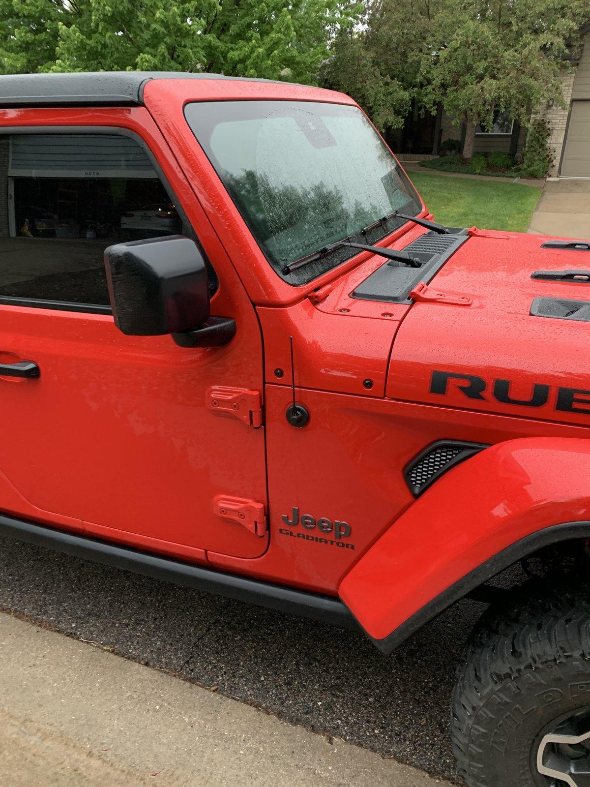

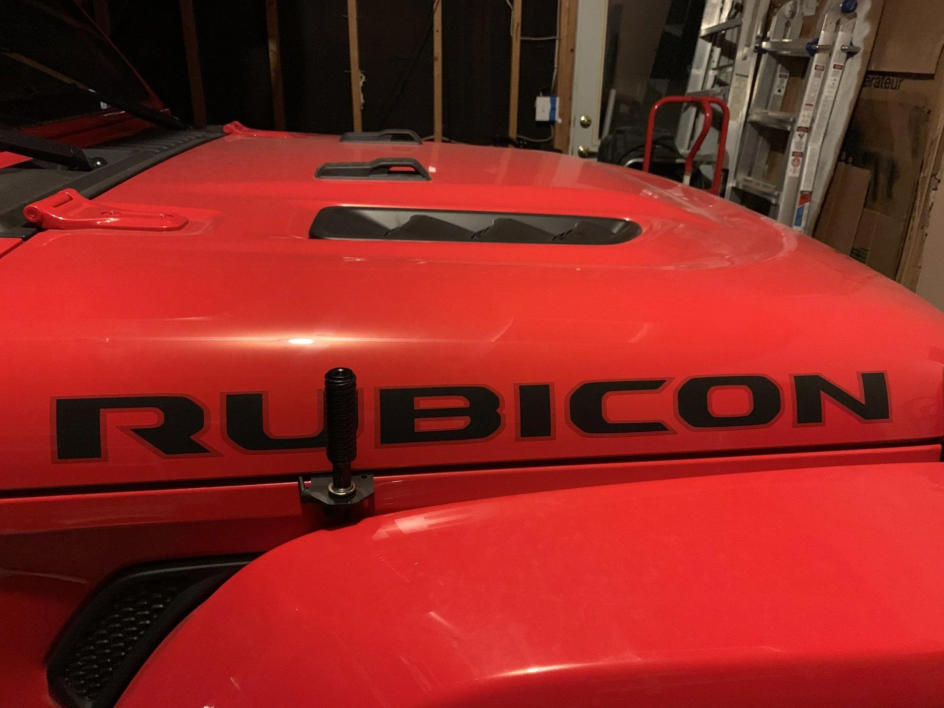

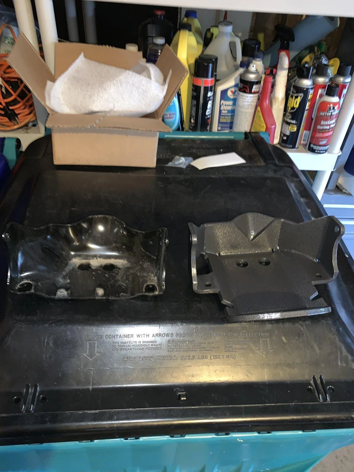

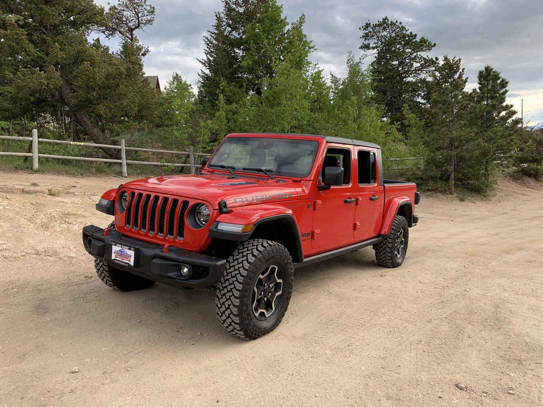

Ahh... some mods... changed out the stock antenna with a stubby 7” antenna... and a little Artec Industries FAD skid... doesn’t the stock one look dainty???

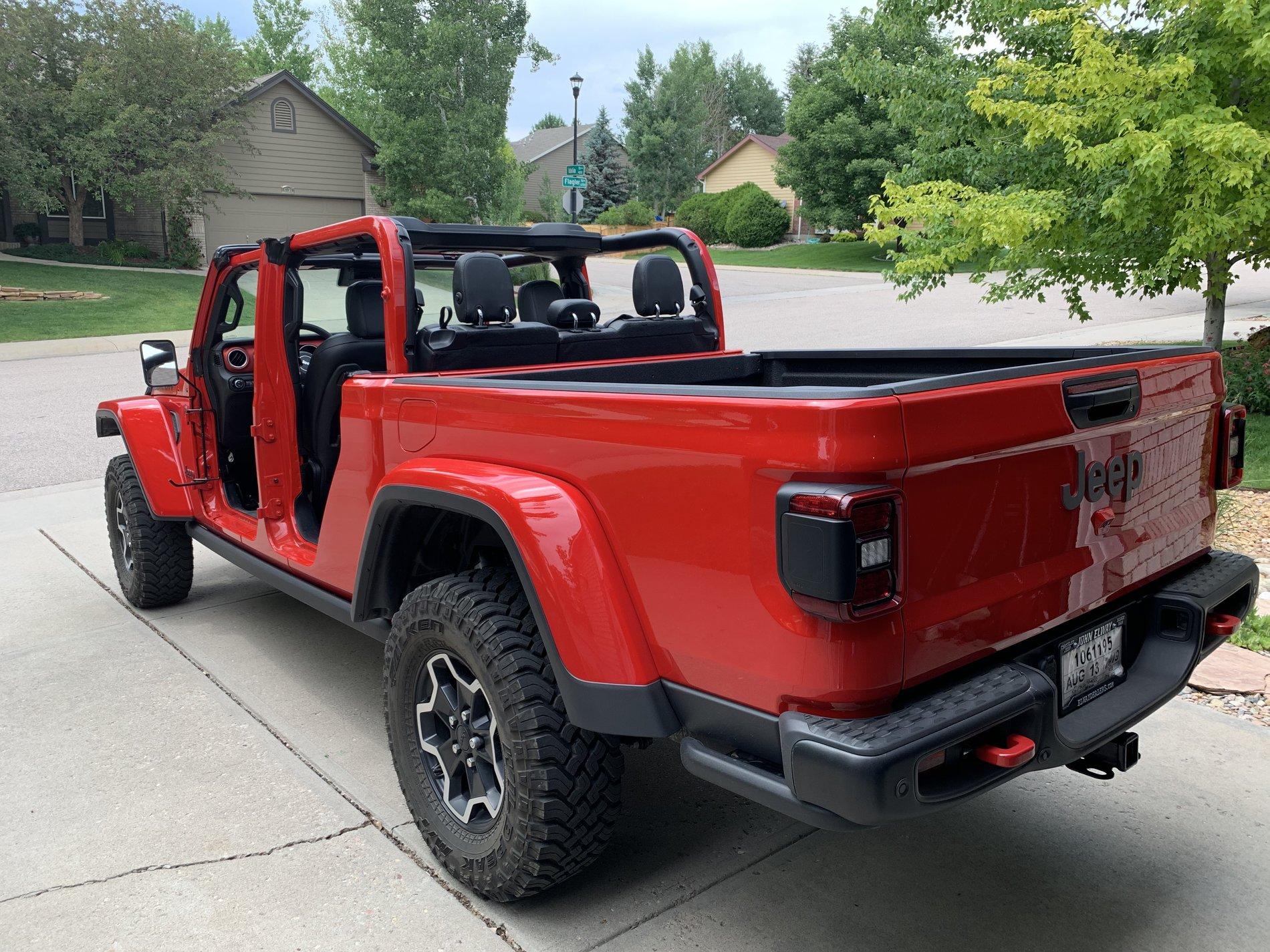

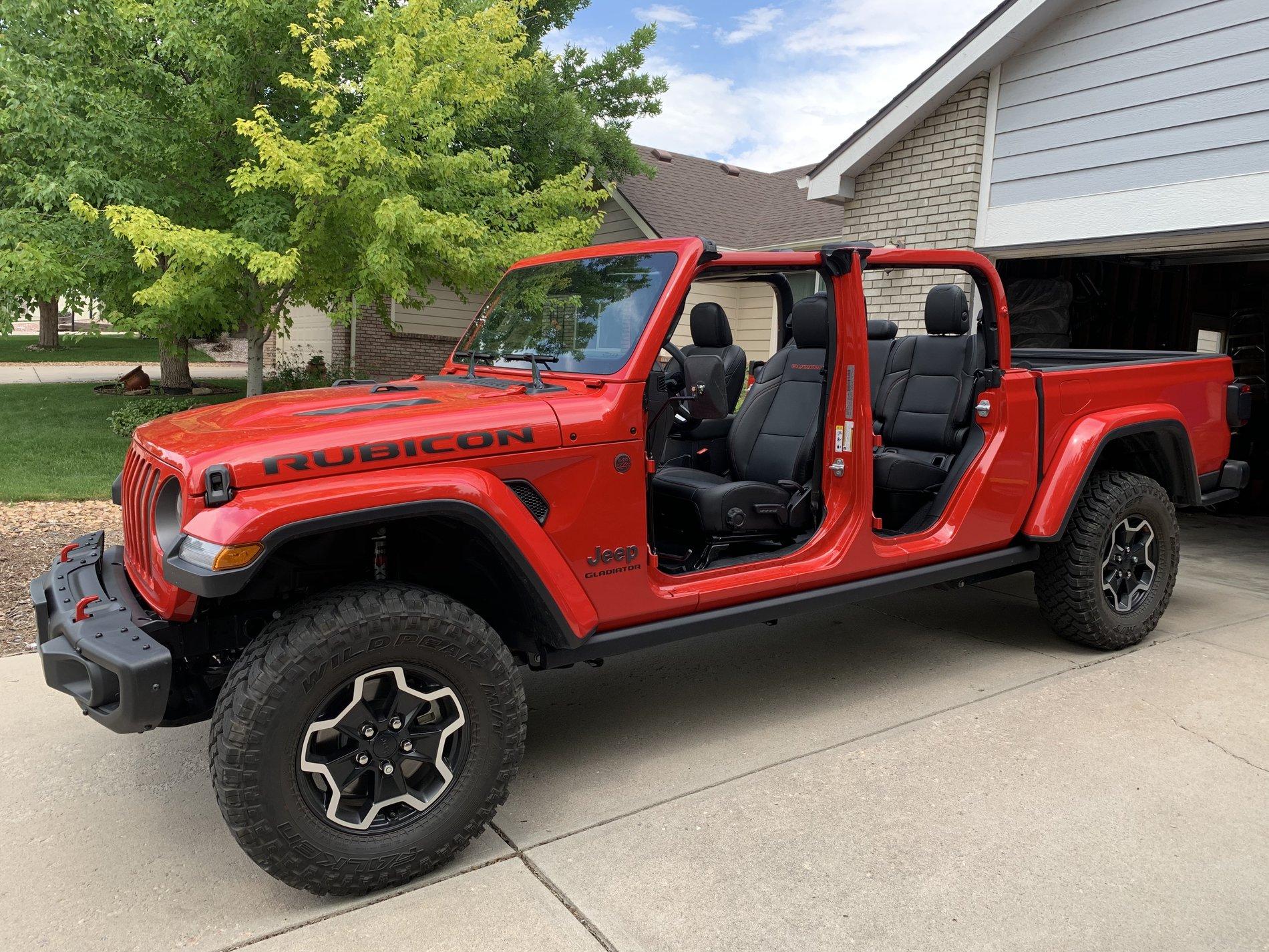

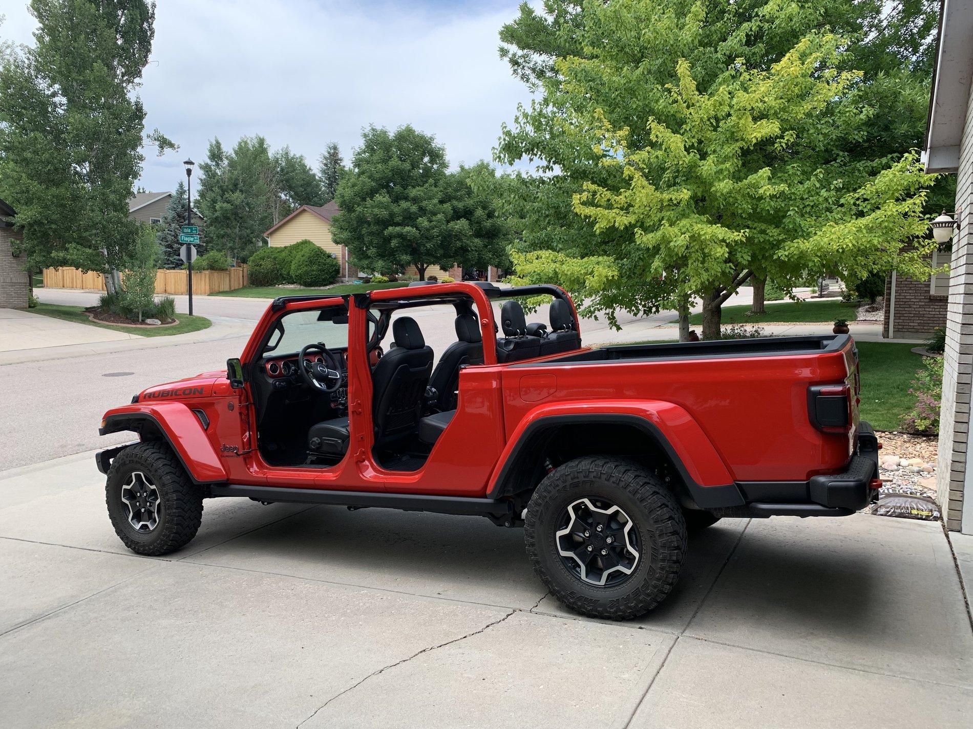

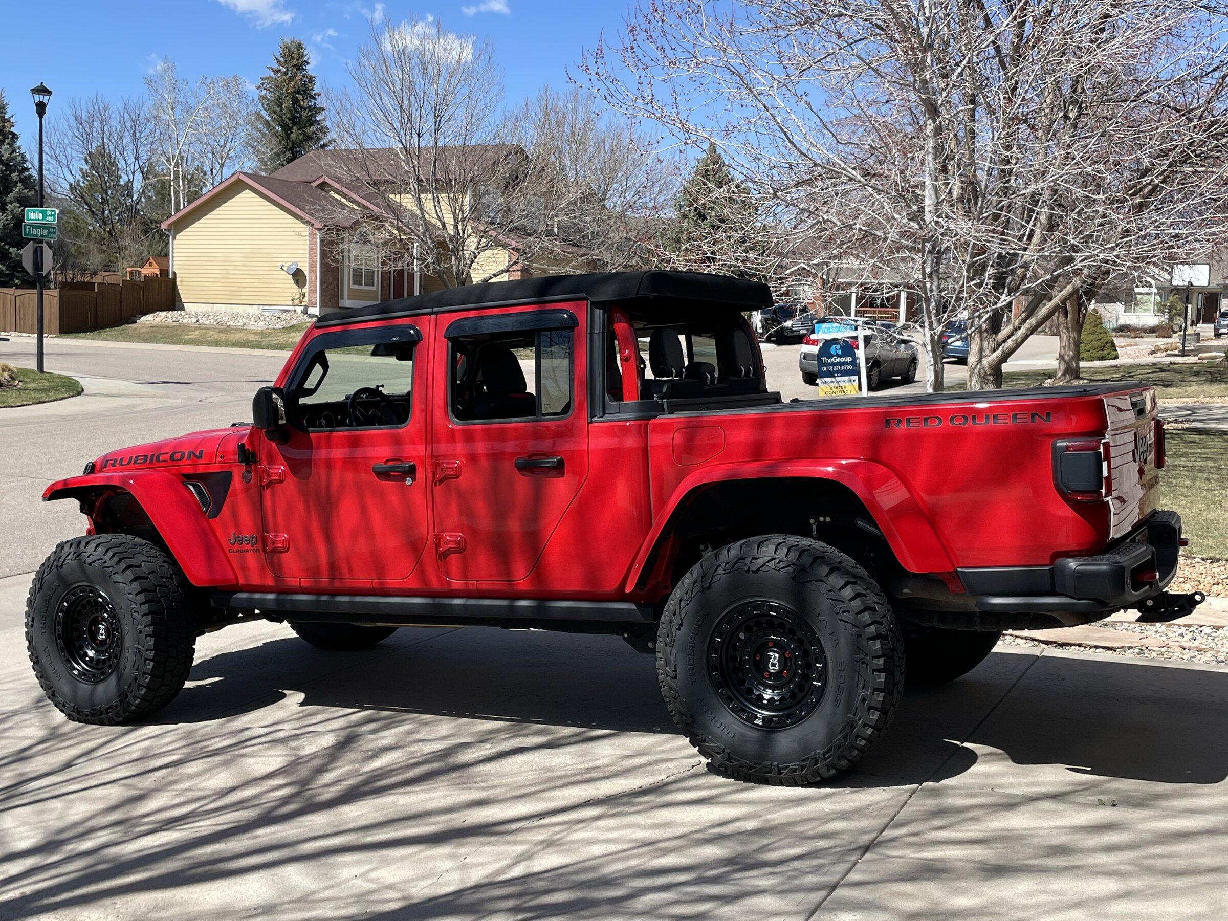

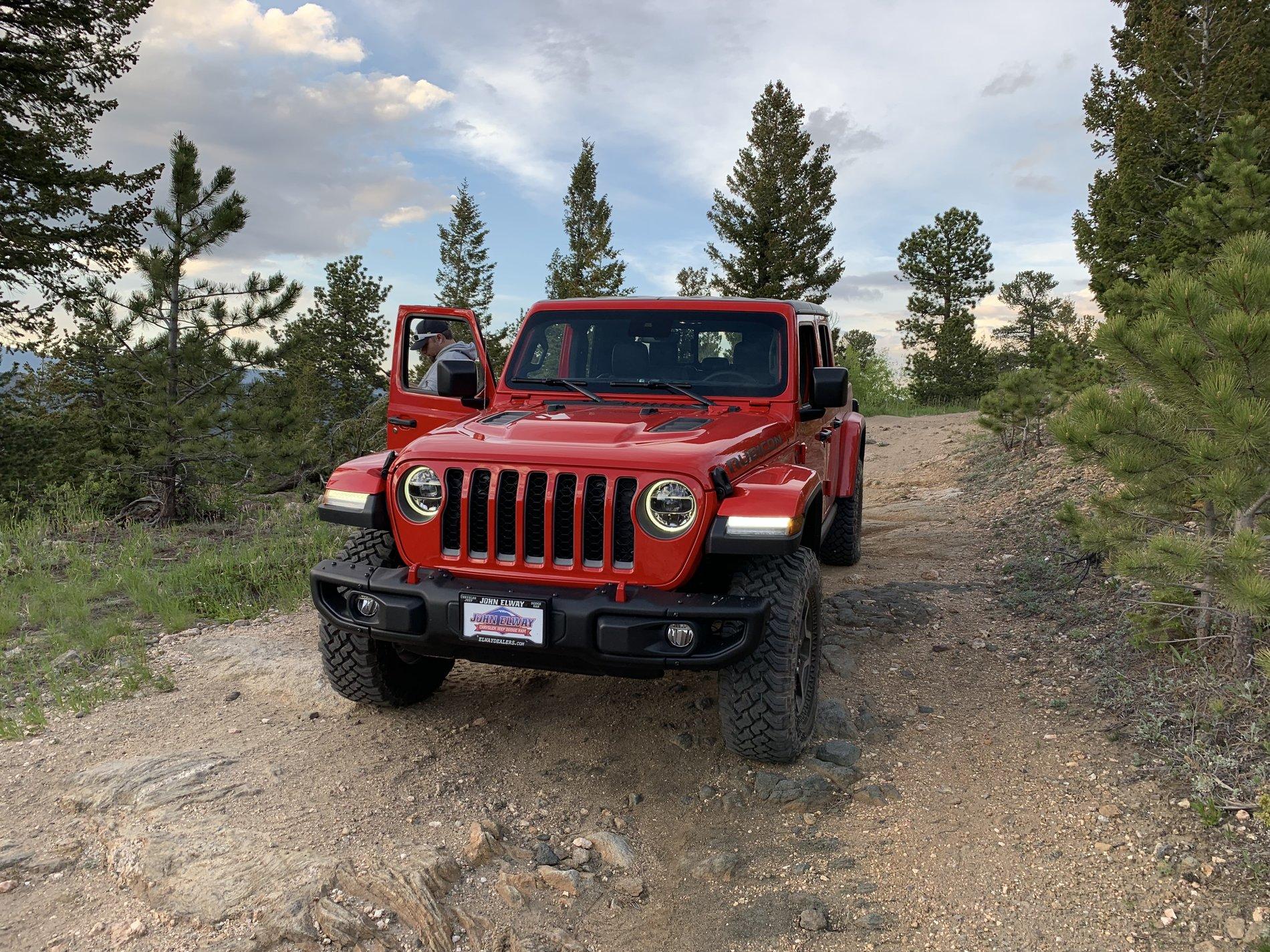

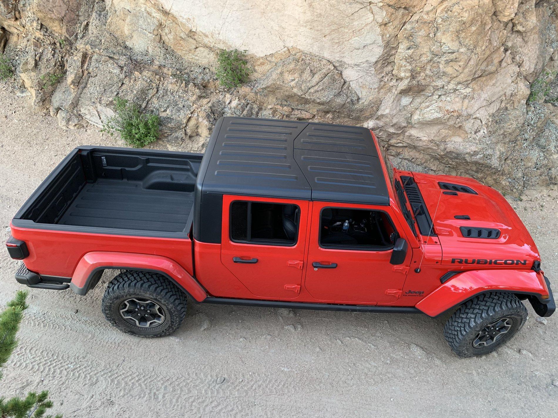

Ah yes... off with her.... top! and doors... looks like I lifted her skirt up with the reactions I get... I retro fitted my hardtop puller and my kickbax mirrors/footpegs from my last Jeep. Oh and to all the princesses out there... here comes the queen!

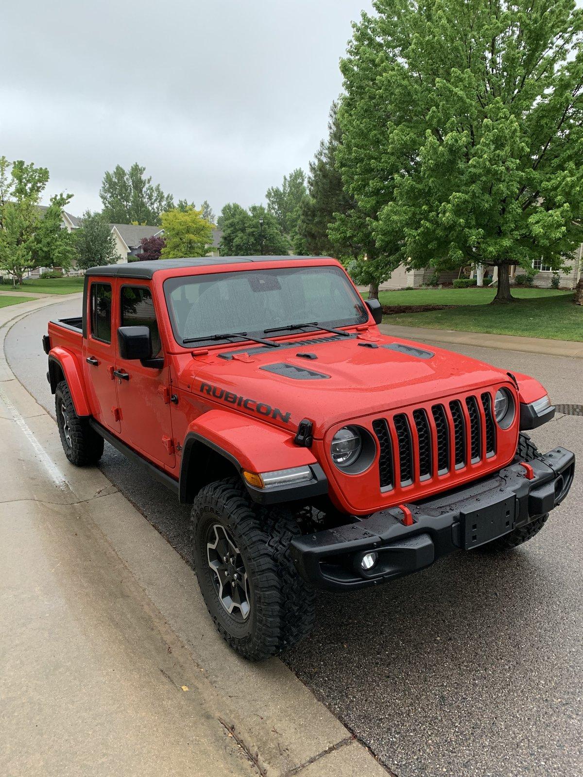

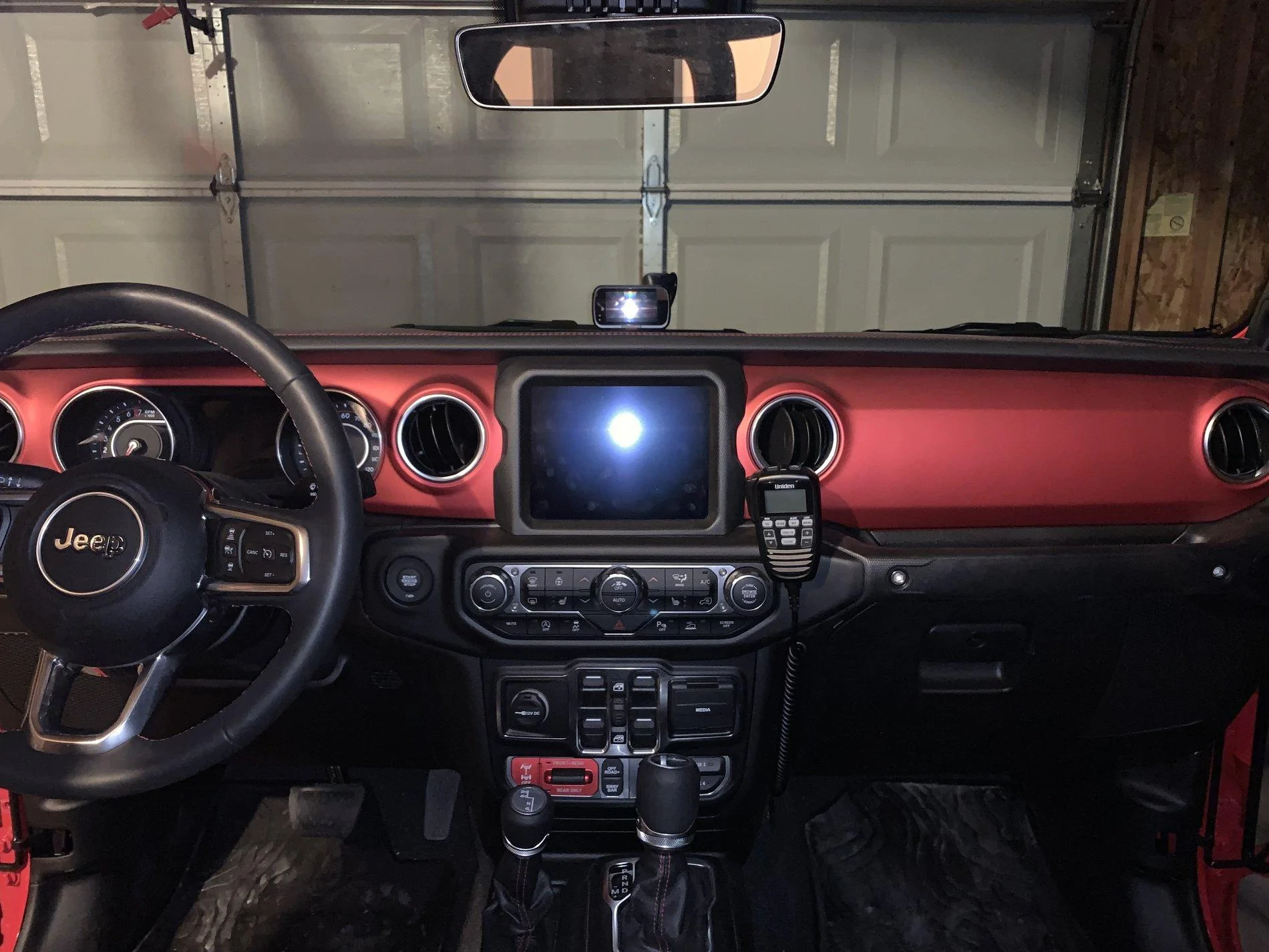

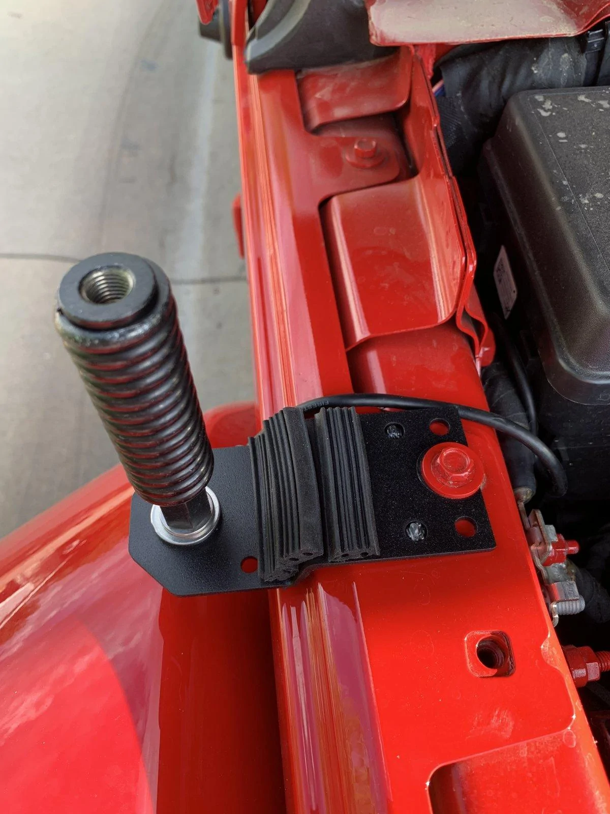

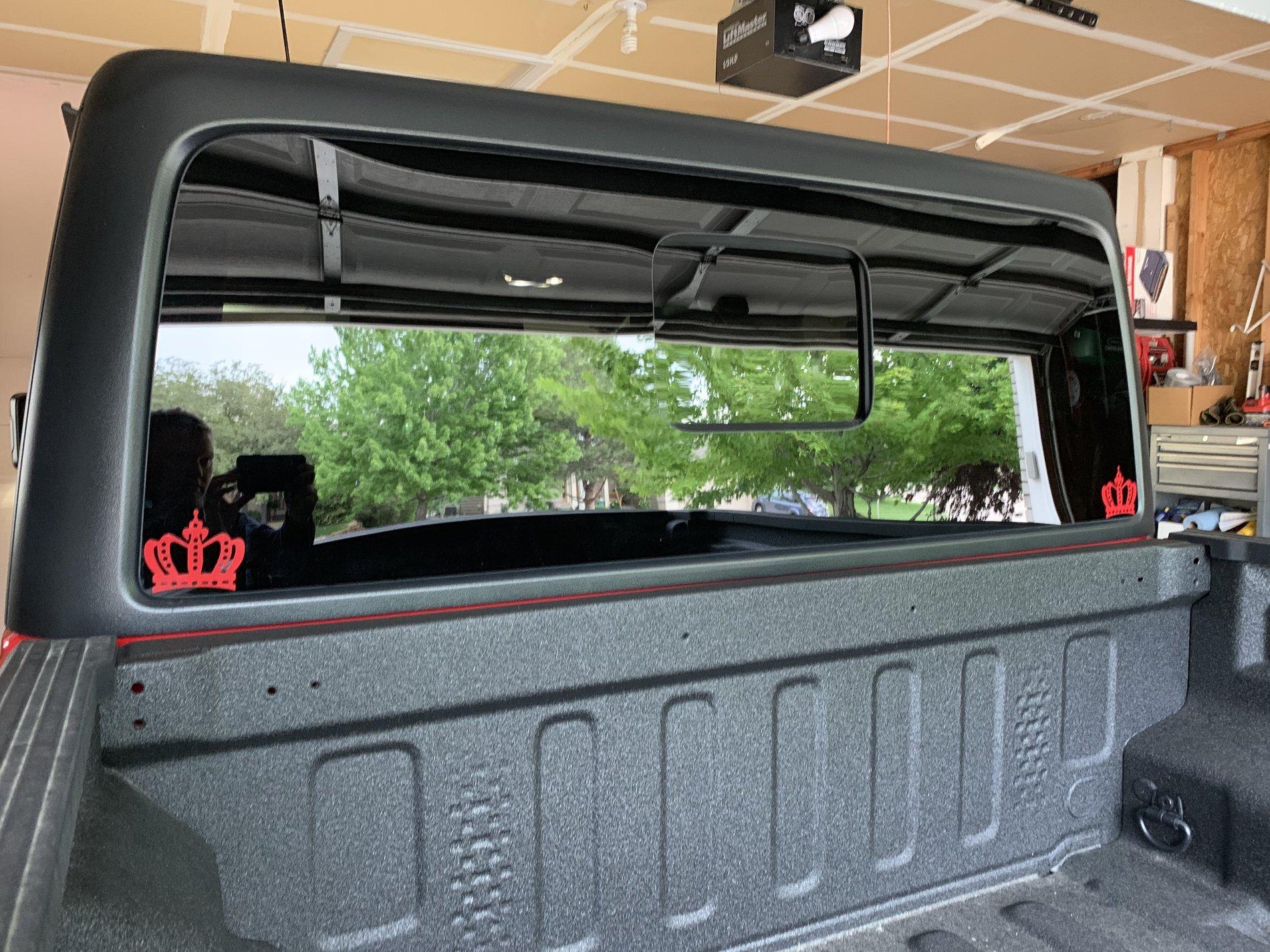

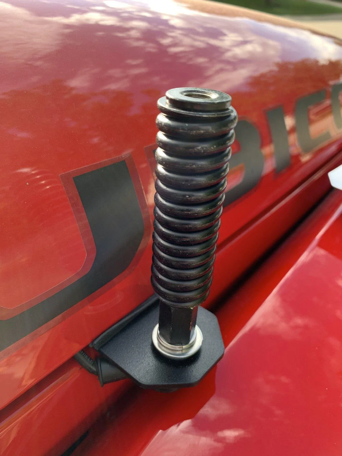

Ahh yes... added some “crown” stickers on the hard top and got my uniden cmx760 cb and firestik 3ft ngp antenna installed. Did a hood mount for now... just need to go wheeling again soon.

The red queen... queen of hearts... queen of the Jeep trucks.... ah yes this is my build...
You were so excited to get your JT that you forgot how to park in your own driveway :LOL:! j/k. Nice looking rig and enhancements! Looking forward to seeing what else you will do to your queen.

Lol... it’s my standard poser rock! Lol thanks... I got some more mods to come.

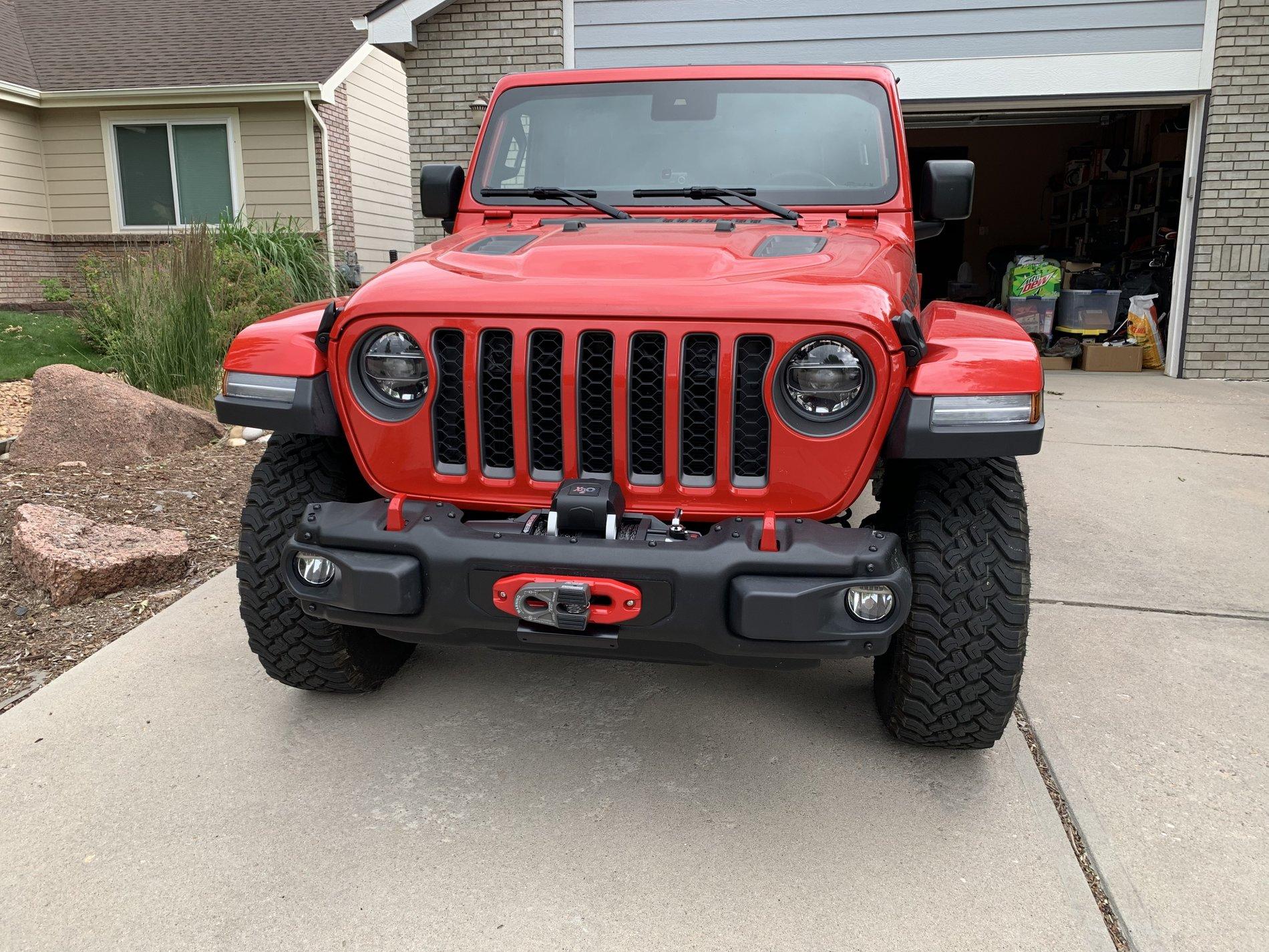

Installed a smittybuilt 12k X2O winch with a warn winch plate... that way I can move the peasants when they are in need...

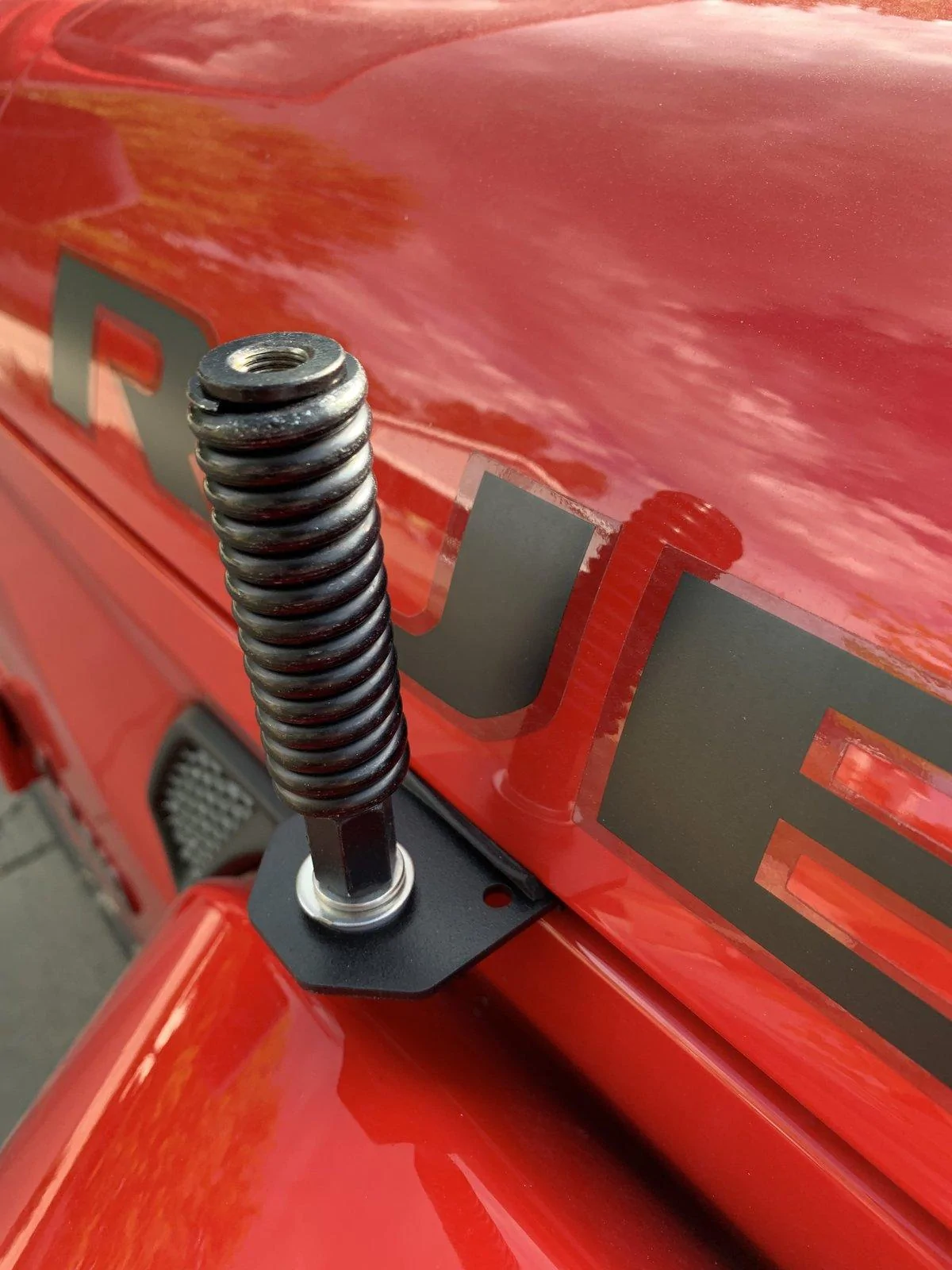

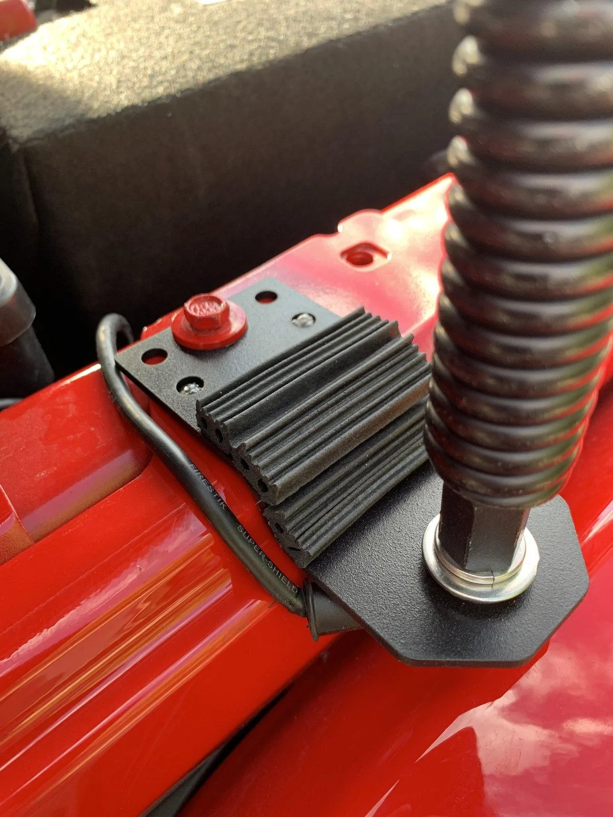

Under concerns for the majesties well being for the hood and fender... I added some automotive grade weatherstripping to the bottom and top to possibly curb paint chips to the cb antenna hood mount.
Tortooga Custom Works
Ralph
Nov 29, 2018
80
1,704
1,619
Central NJ
Nice what mount is that?

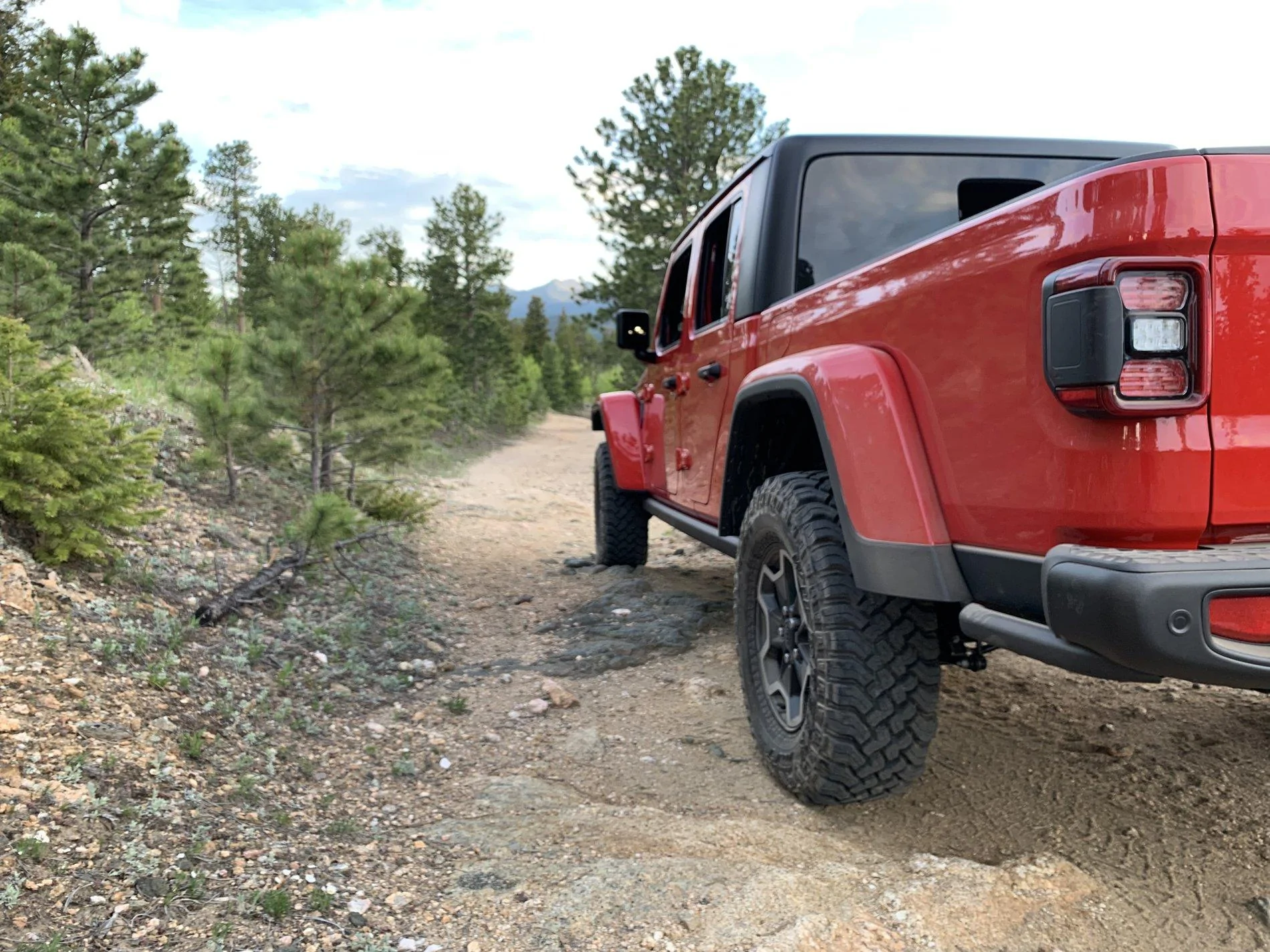

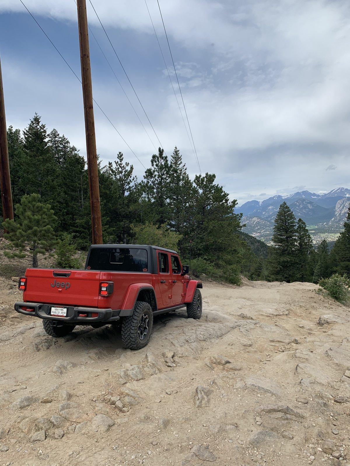

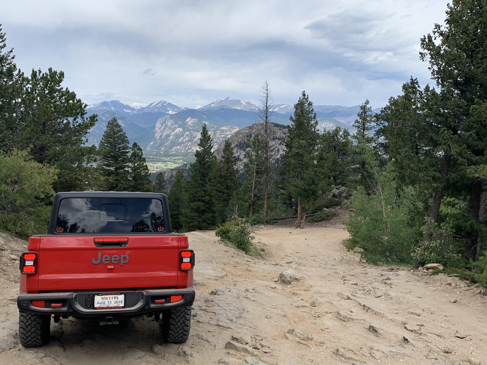

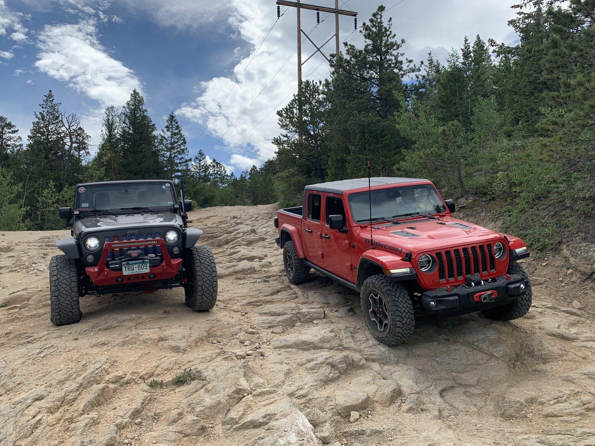

Went on a trail with a buddy of mine... so you can say the queen got her hands dirty today. Oh... the queen cheated on me, she let my friend drive while I took the videos.
