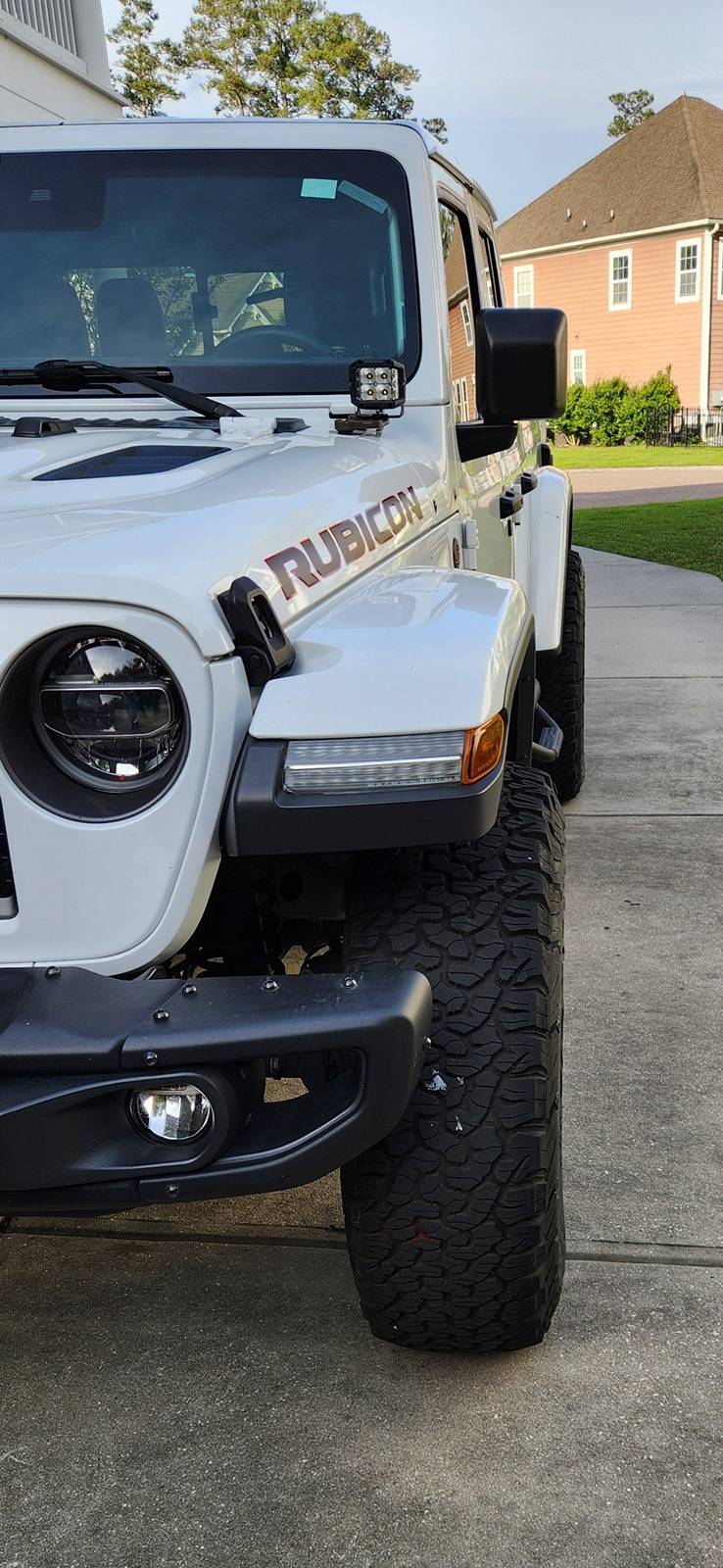

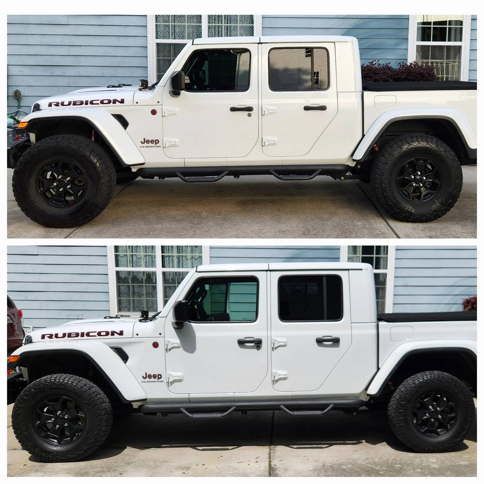

A) Should have done this a long time ago
B) Rubicons should come with at least 35s to fill up the wheel wells
Specs...no lift, KO2s (so they're really like 35.75), Synergy 1.75 spacers
No rubbing full turn. I don't do a ton of off-roading, so that of course could be a bit compromised with no lift. I am beyond happy with how the setup came out!!
Jeep Gladiator The 37s are Finally On! 20240401_181106
Jeep Gladiator The 37s are Finally On! 20240401_180207

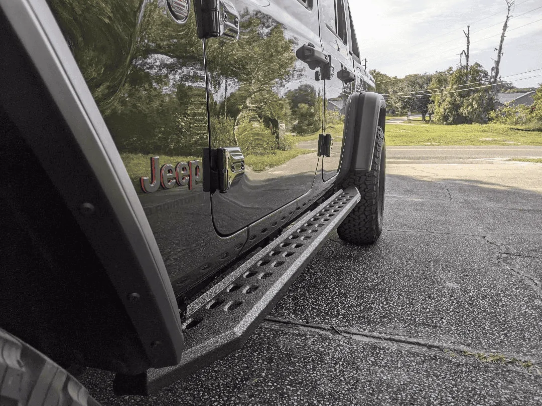

Curious why you used 1.75 spacers? I have the same tire on stock wheels, granted mine is a Mojave. I had to add two washers to each side of the steering stop to prevent rubbing. A small price to keep the tires inside the fenders imo. I did trim the liner first but after adding washers I probably didn't need to. Your JTR does look good.

I wanted the untucked look...to me just that little bit of poke gives a much stronger stance for the truck. ? You're also looking strong there!!
