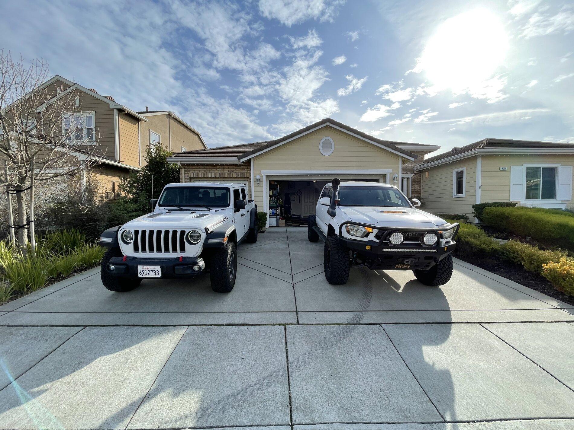

I have already installed the bed rail system, BAMF front bumper w/ Baja Design SAE Foglamps and 35’s. I plan on a few more modifications.

this last pic has my “play” truck as well.

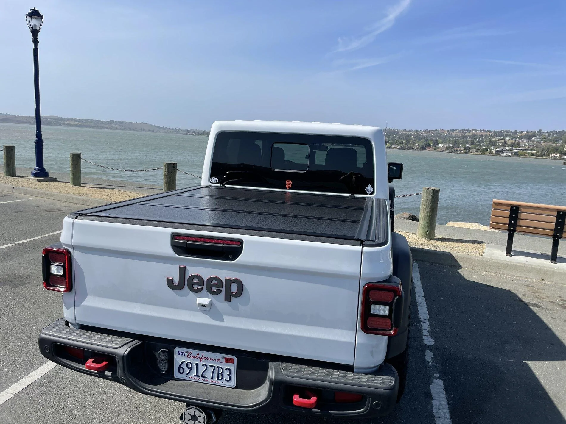

This one doesn’t have a whole ton of information, more just anecdotal observations.
I couldn’t make up my mind on a tonneau cover. So I did what I do best, I purchased a factory unit to ensure some kind of inherent reliability and intended design.

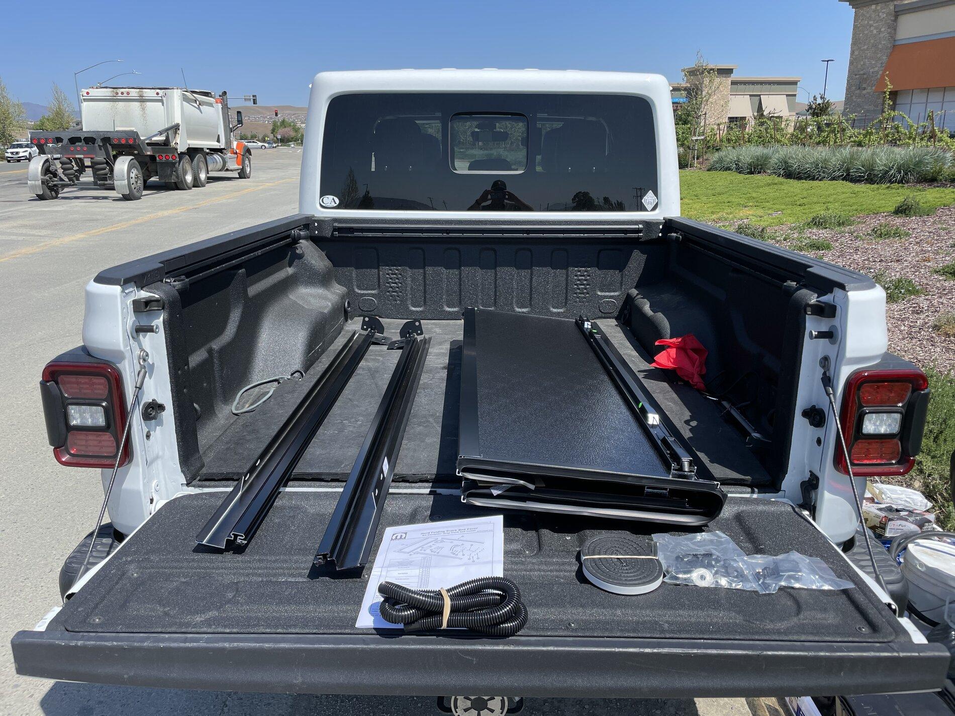

The factory tri-fold is pretty simple in design. But, where it really shines is in its aesthetic. It’s super sleek with its minimalistic deck height. It’s almost completely flush with the factory plastic bed rails. It’s security relies upon the factory locking tailgate. No way in unless the tailgate is lowered.
I got the dealership to match an online price form discount Mopar parts. It also helped that it was the dealership that I purchased the truck from. That was helpful, as the retail is $1000.00. I saved $125 but almost paid that much in tax.
I had a hell of a time doing the install do to a key missing pair of rivnuts. En lieu I sourced some stainless fasteners from a local Lowes. It took me wayyyy too long to make my “workaround” functional. Those rivnuts are key. I should have waited toinstall it after those puppies arrive. But, I was impatient and installed it across thestreet from the dealership.
Jeep Gladiator The JT TRPR BB6535CB-89D4-49CA-9C6D-7356F3ECCF8A
I unloaded my tool box that morning and I couldn’t get back to work until I got that tonneau installed. It took me about 3 hours to install. I have the rivnuts on order. When those get here, I’ll uninstall my temporary fasteners and get those rivnuts in there.
What a saga! So far Mopar has been hit and miss with these factory accessories. We shall see when the window visors arrive.

Being the doofus that I am, I totally forgot to actually take a “finished product” photo.
here it is:

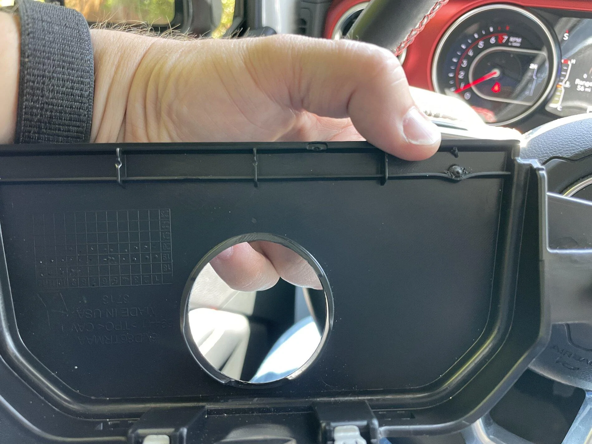

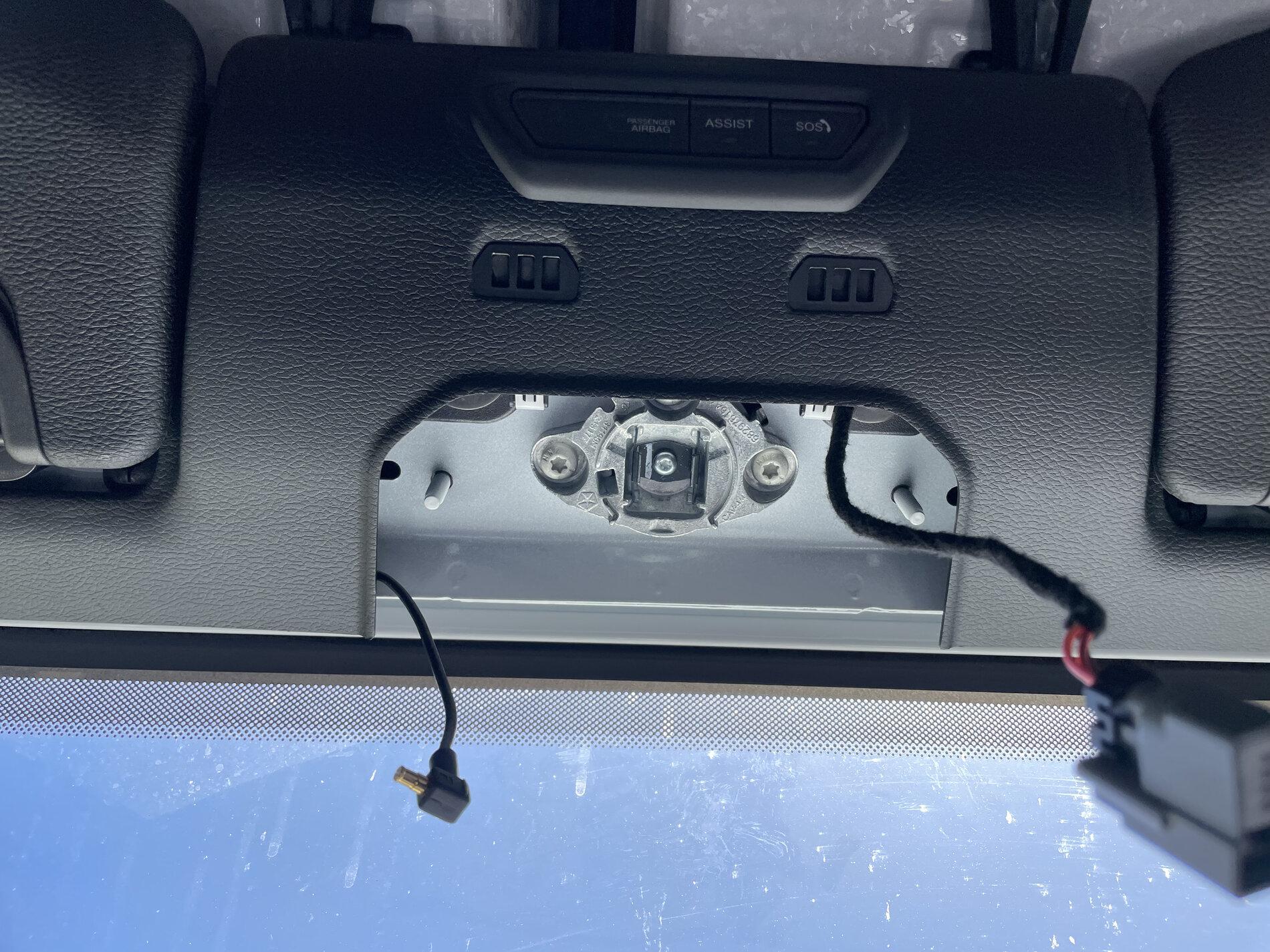

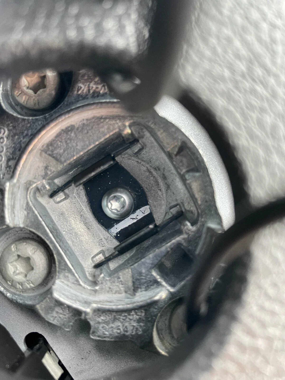

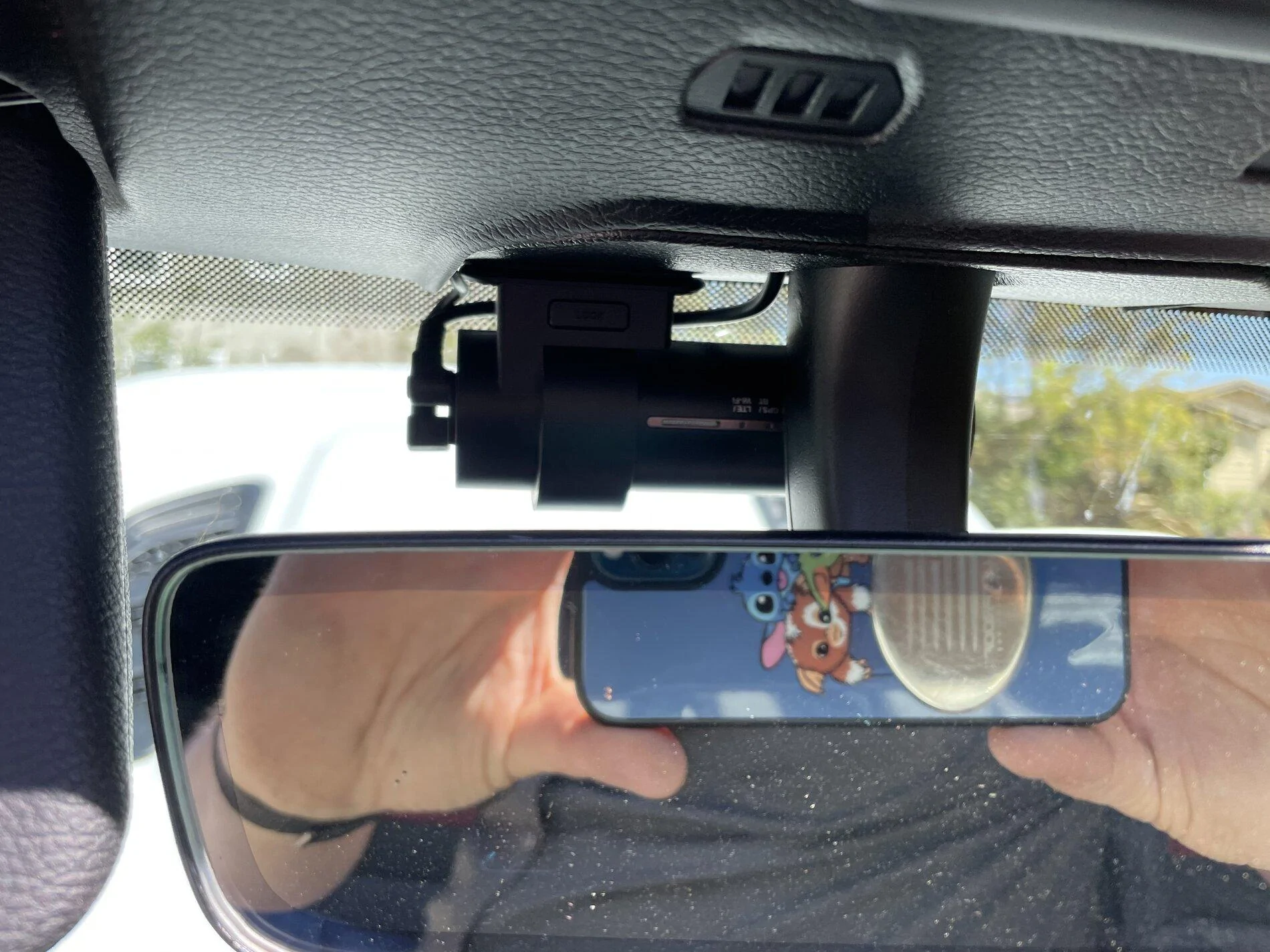

Pics of said dash cam install “fix”.

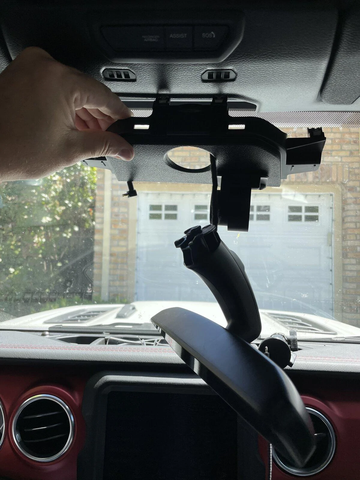

Removing the rear view mirror is simple, turn counter clockwise and it will release the cam.
Jeep Gladiator The JT TRPR 584D66D7-D046-4611-9491-9AE1FF56C0FE
Then, you’ll want to unclip the harness from the mirror assembly.

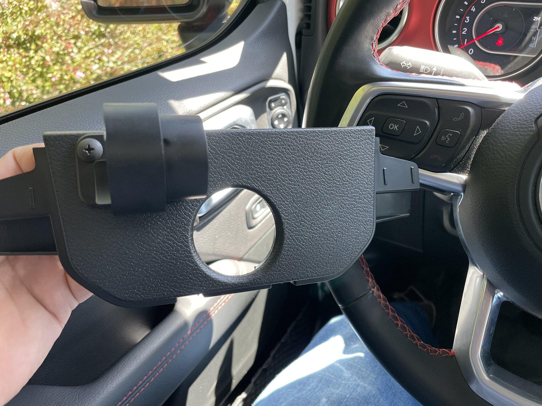

I simply drilled a hole and used a screw to mount the dash cam mount to the plastic surround trim.
Jeep Gladiator The JT TRPR 3A3AD35E-0B11-4296-B569-81E56DF51C6B
Use a shallow depth screw ofcourse
Jeep Gladiator The JT TRPR 4D92A3C7-7B8F-4E58-AC91-BE0A1551EFC4
Fiddle with the wire placement a bit.
Jeep Gladiator The JT TRPR 67E052DA-DE3C-4A5C-B123-7B2485CF6AE5
Remember, to install, you need to slot the cam in place and turn clockwise to seat it.
Jeep Gladiator The JT TRPR 287E2CE0-8B0F-4742-97C7-ACEB0DF28C1F
Super simple fix. Took me 6 minutes.
