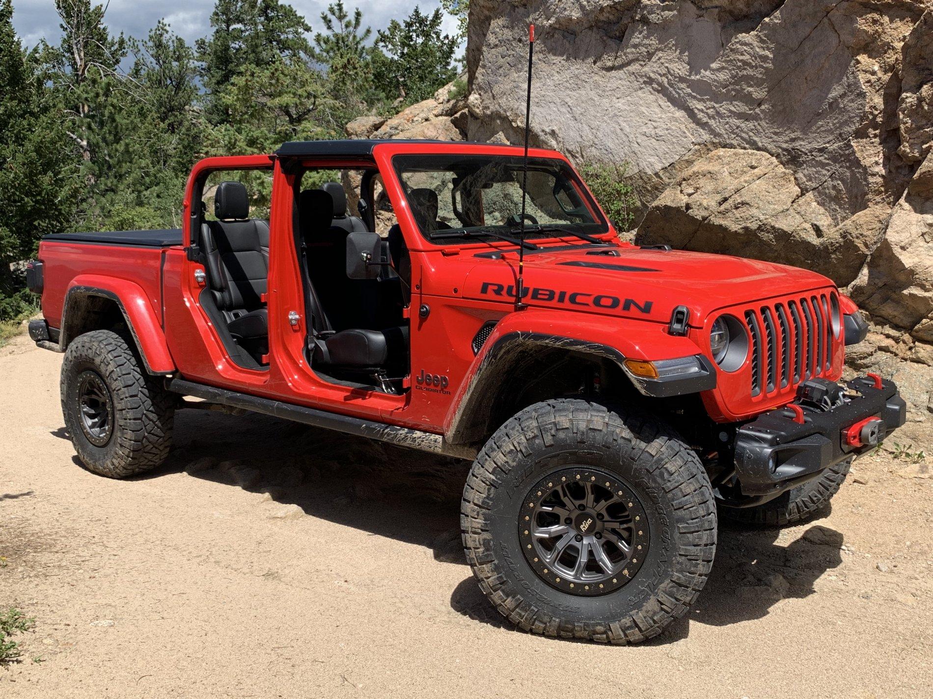

yep... easypeasy... I ran just the freedom panels for a few days because I burn pretty easy. Went 4 wheeling and drove down the interstate without issues.
Jeep Gladiator Thinking about running freedom panels only 408A5A64-B4BF-4139-A6C5-150A3D5B1DAE
Jeep Gladiator Thinking about running freedom panels only 759E5EA3-1BF1-475E-9E92-9DBBDB5F786C
