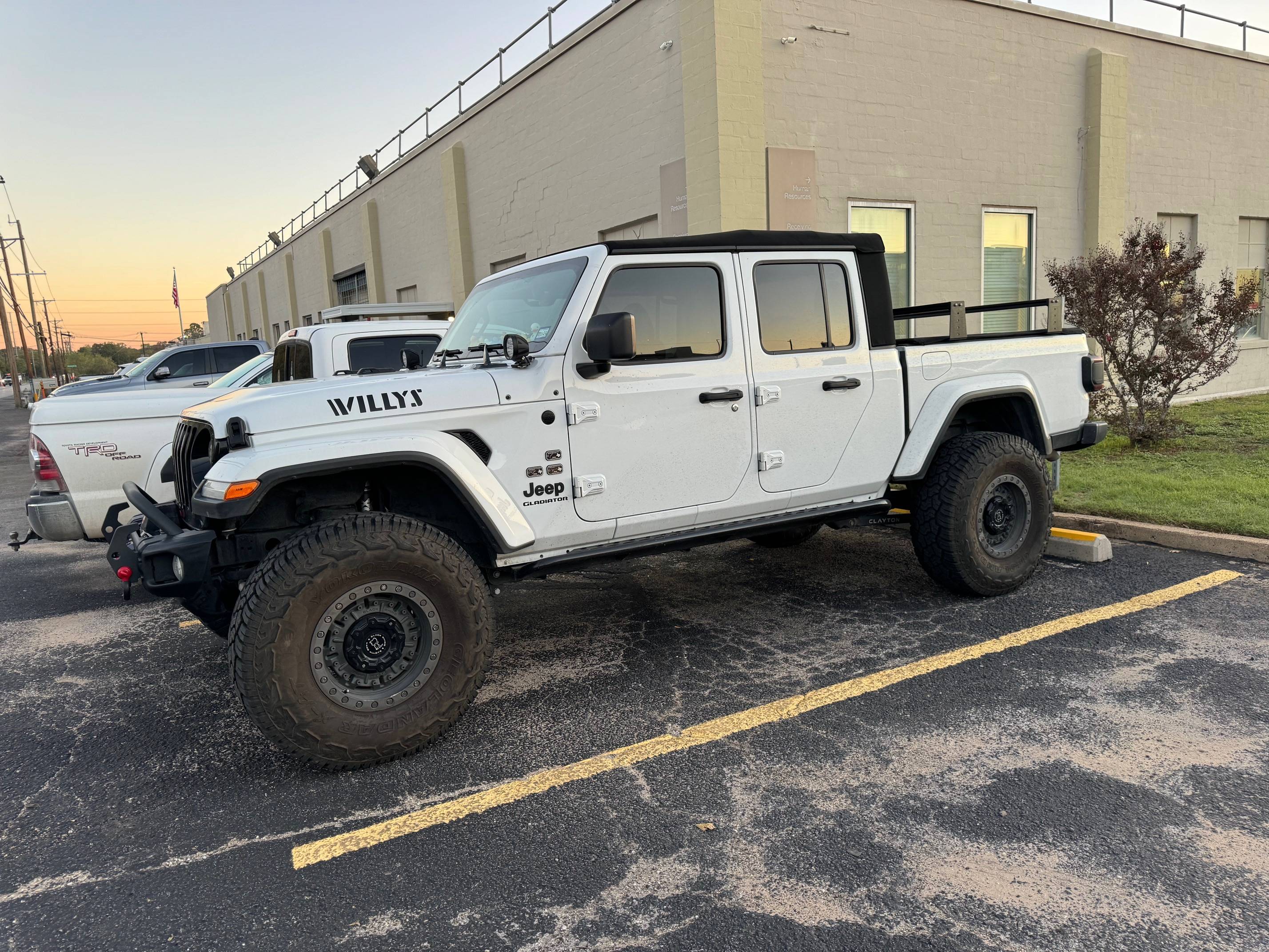

Tough to get all of those things. If you don’t want to sag when you tow, it’s best to have some rake when you aren’t towing or loaded up. I have a reasonably good rake when empty, which makes it perfect when towing. And to be honest, I don’t get the level thing most people want. Your departure angle is much better with a rake. I’m also thinking about raising mine just a little, but will add the same amount to front and rear to maintain the rake.

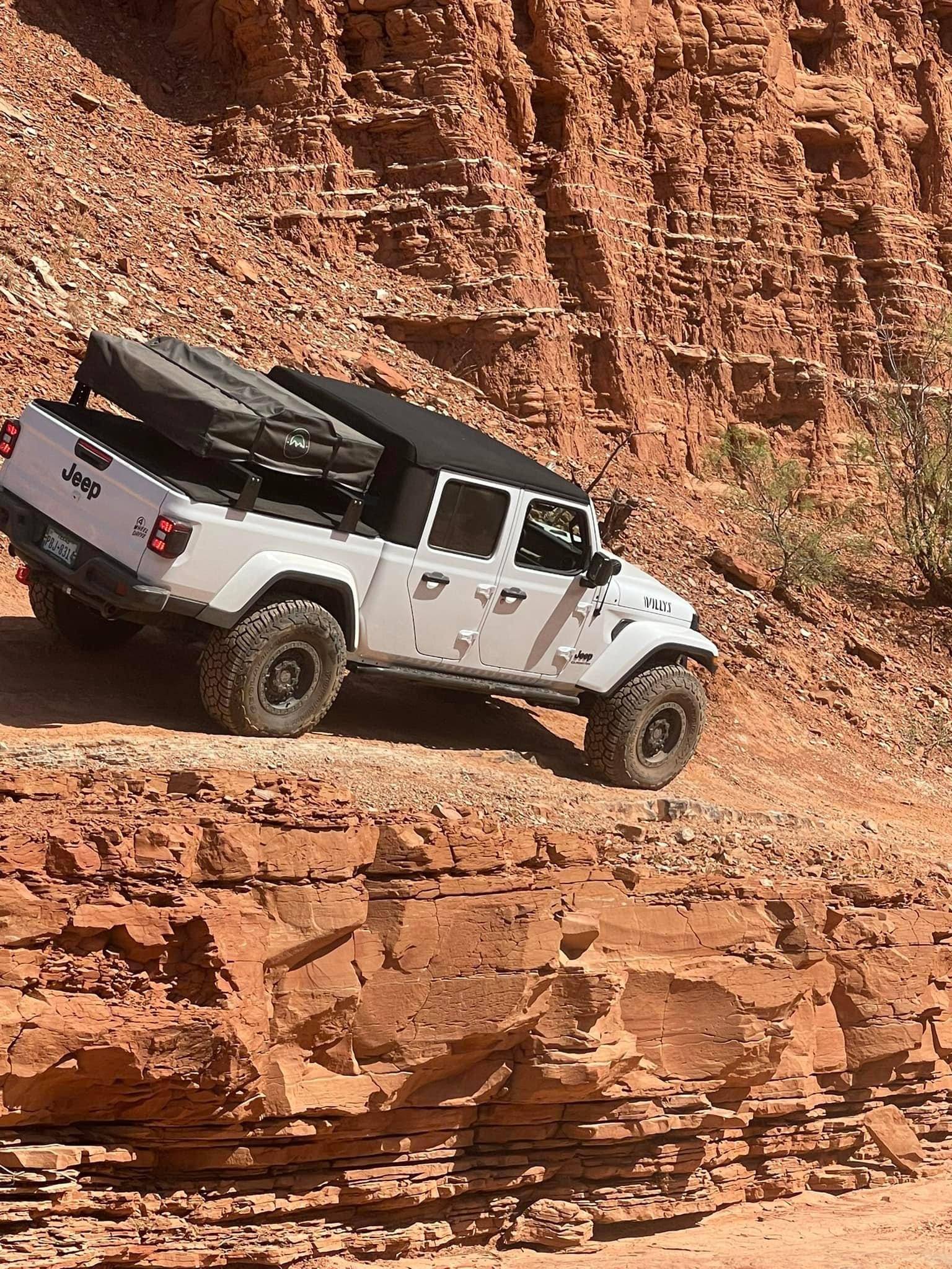

By the way, where is the third picture? That looks fun.
It's at Merus Adventure Park in Palo Duro Canyon. Definitely one of my favorite places to offroad yet.

Regarding the rake, I do want to maintain some level of rake, just not as much as factory. I know it would help with towing if I kept it the factory level of rake, but I don't tow a lot, just short trips to the lake during boating season. More of a personal preference I guess.

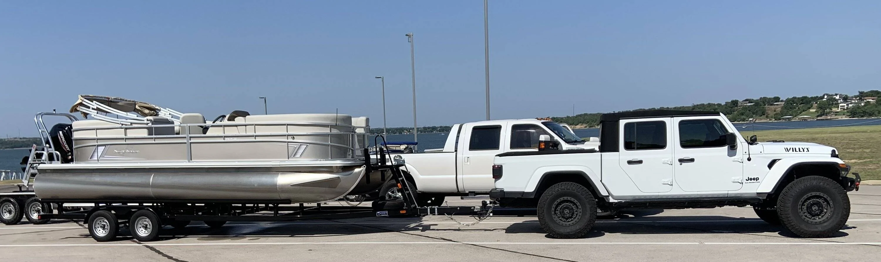

It doesn’t look like you have a weight distribution hitch for your boat. Might help a lot!
Very rare to see a boat with a WDH, the majority of the boats weight hangs off the back (the engine) so other than the big boy boats (26-27+ cabin cruisers or multi engine) they're usually just towing regular to try to keep the tongue weight in a reasonable range.
It's also got surge brakes, so I don't think I can run a WDH even if I wanted to.
Have you weighed it to see what tongue weight you have compared to the trailer? You could just need to be running a higher hitch to shift some weight back on to the trailer and carry it more level. Also airbags wouldn't be a bad idea.
I haven't weighed it yet to see what the tongue weight is. I probably will go with airbags for towing.
It does appear the drop hitch is a little too low.
