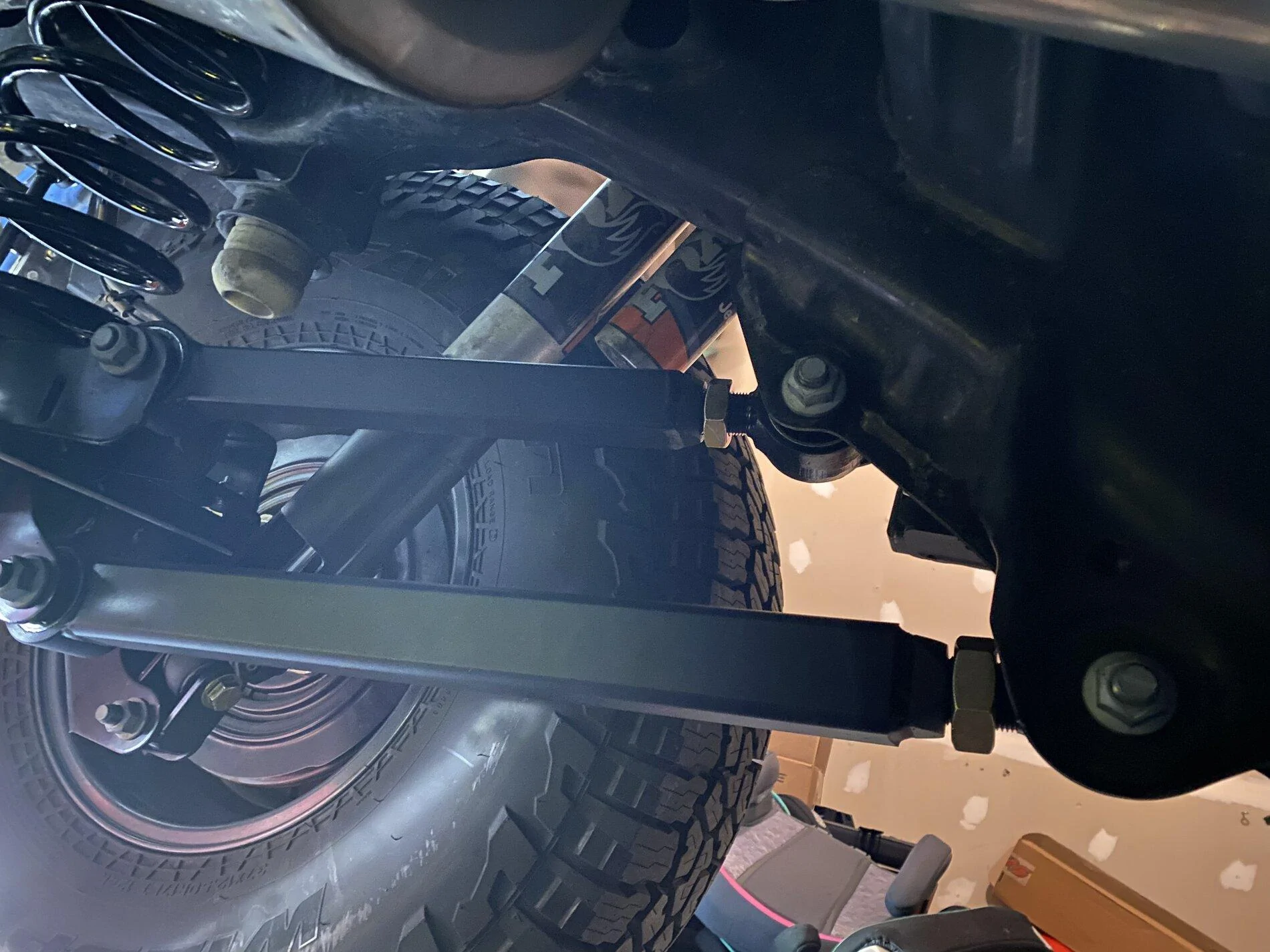

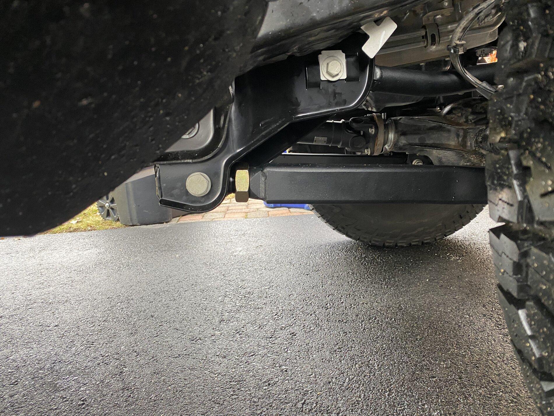

I chose the Overland+ control arms. They still flex more than stock, are comfortable and entirely noise free on road.
For having a truck i use for DD, traveling, camping, and wheeling, the edge to comfort and zero maintenance was the way i went. I dont want to have to mess with greasing control arm bushings to get a little extra flex. Just wasnt worth it to me personally.
If you’re looking in the 35-37” tire range, i’d go 2.5”. For competitors? Icon, Metal Cloak, Rock Krawler would probably be up there. I think they mostly use johnny type joints.
