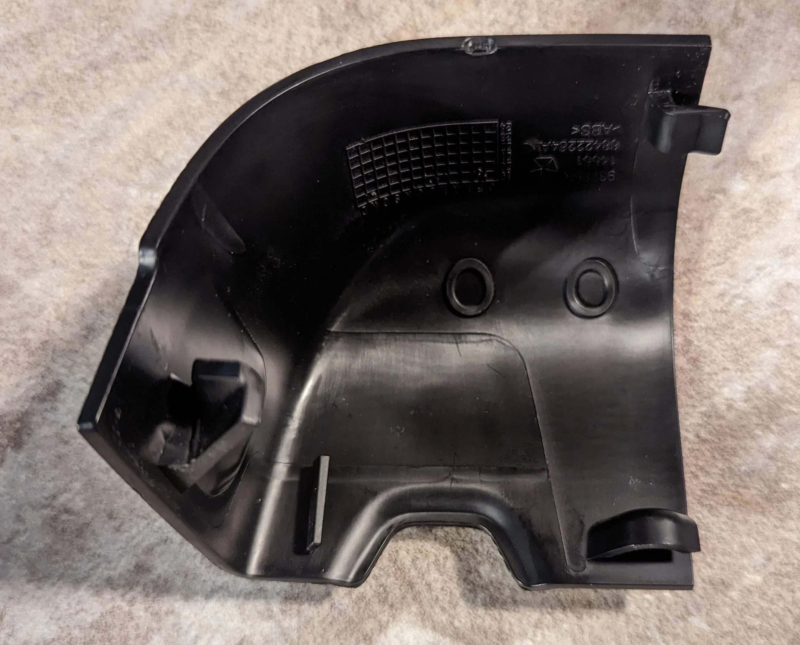

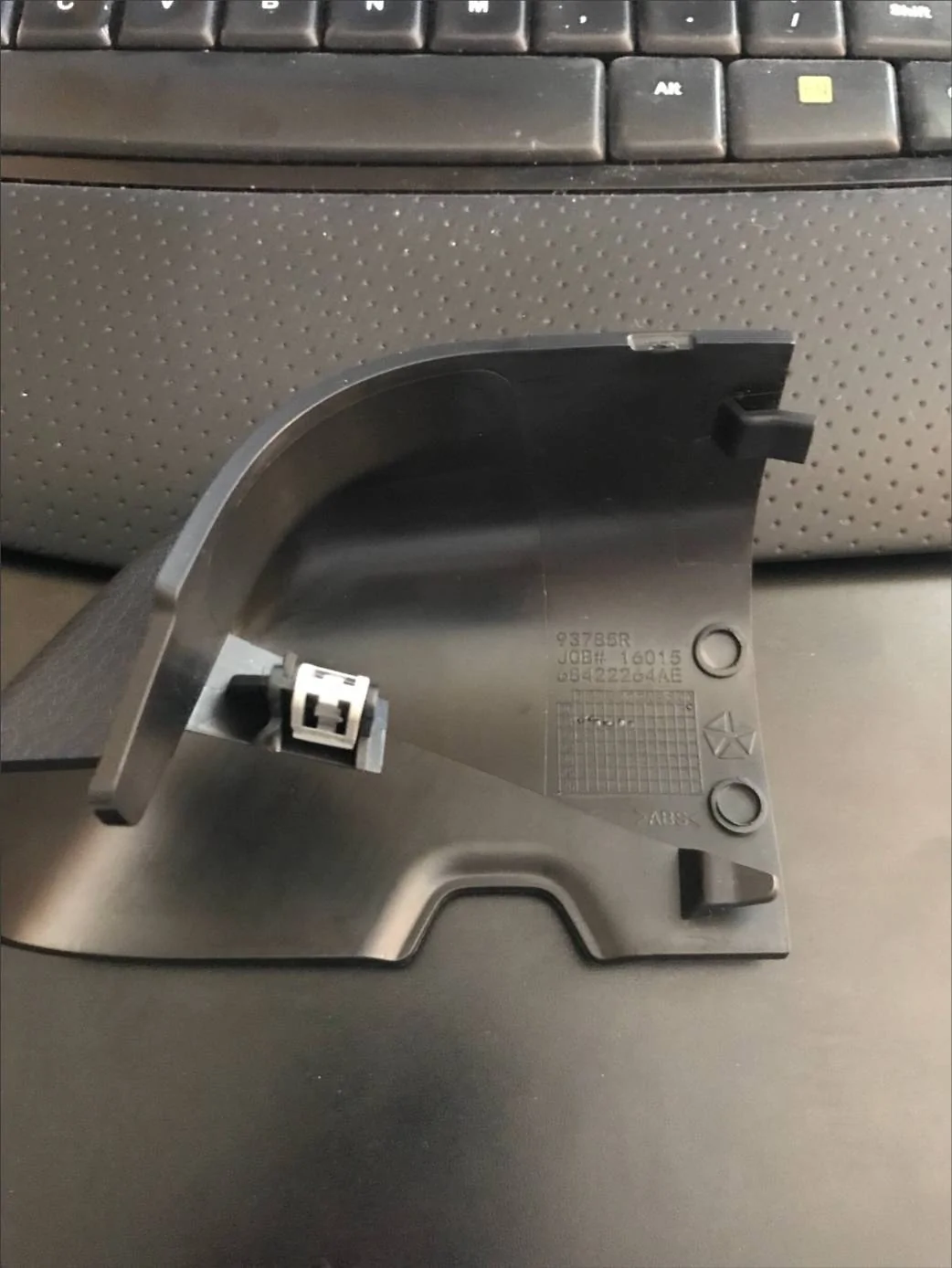

The newer revisions of those won't fit on 2020s unless you change out the panel it mounts to. I've been unable to find an original and had to learn to live with it.
Good catch... and looks like there's a thread on it already too. Seems like only up to 68422264AD works for the older JTs, the newest AE version of the part has a new style connector to attach to the hard top.
https://www.jeepgladiatorforum.com/forum/threads/i-am-in-search-of-mopar-part-68422264ad.52970/
Pics of old vs new below (notice the white connector on the new one)

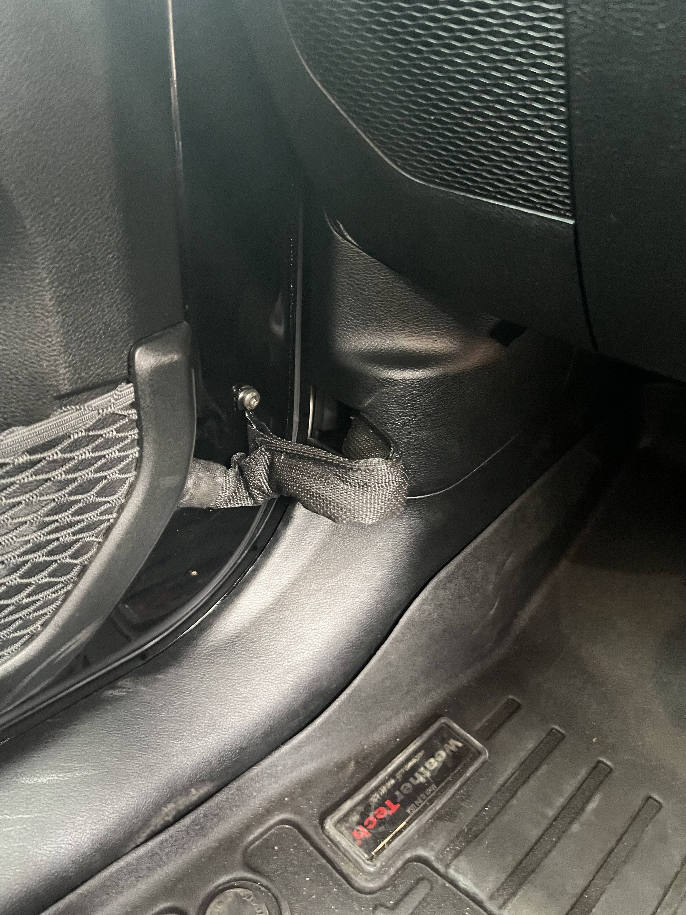

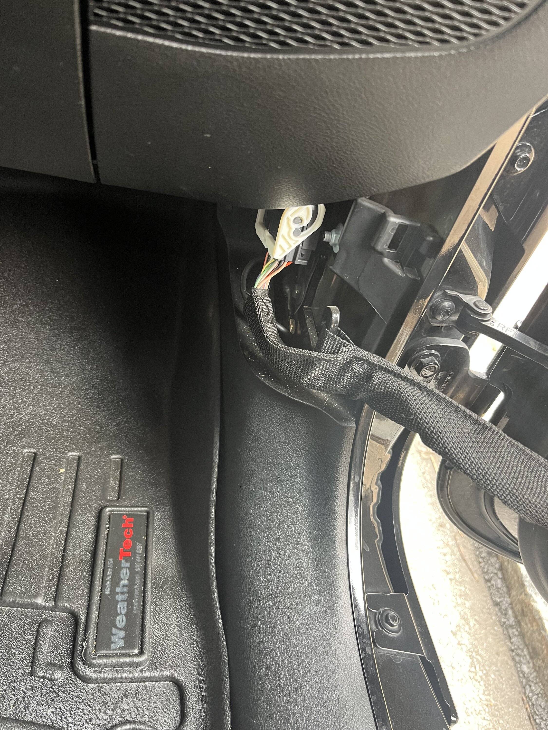

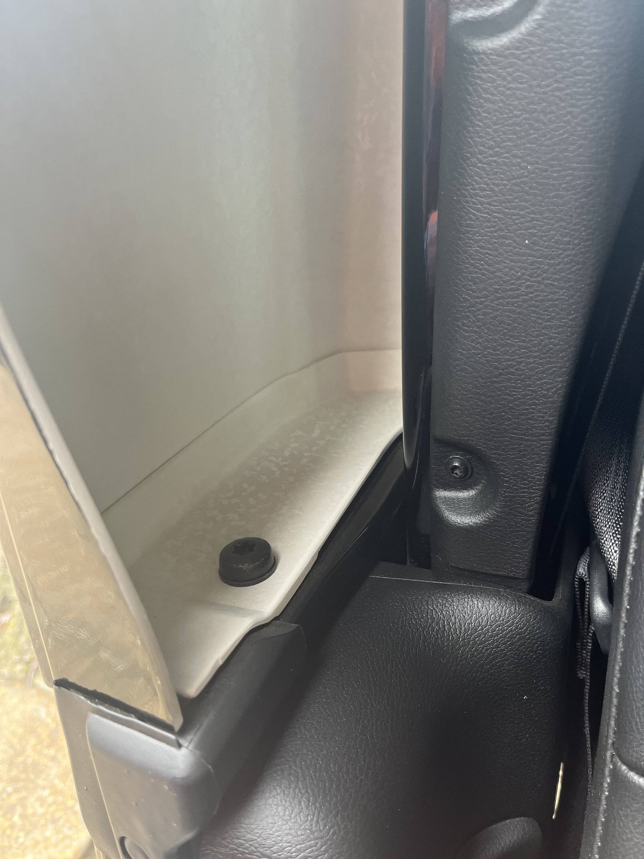

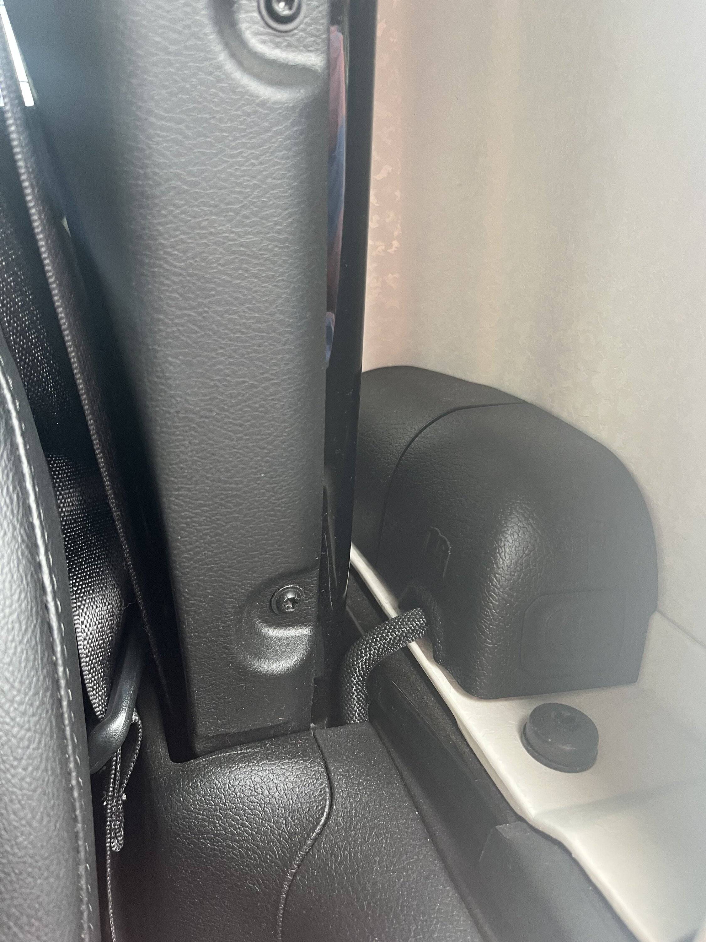

wow, appreciate everyone's help. I've attached the photos here.
Driver's side covers are shown, and the exposed wiring and nut on the passenger side.
I THINK these are the two parts I need to get (Hyperlinked)
Rear - Quadratec
Jeep Gladiator This has to be the most simple part to find IMG-1463
Jeep Gladiator This has to be the most simple part to find IMG-1462
Front
Jeep Gladiator This has to be the most simple part to find IMG-1461
Jeep Gladiator This has to be the most simple part to find IMG-1460
First time I've been on a forum in ages, and i think i'll stick around if i can expect this level of help!

Looks like you only need the front passenger kickpanel cover that @Lunentucker posted above, there's no plastic cover on the back passenger side location of the hardtop (no wiring connectors there to hide).
