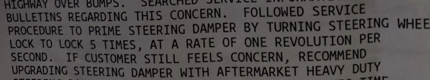

What do you do to "charge" it? I'm admittedly ignorant on this, and couldn't find any info online.
I’ve heard people say charge or prime, either way same thing. I have attached directions from another members post from this thread, this was notes from his work ticket:
180
29,422
34,994
Oh, ok. Thanks for that - like we used to do with new shocks right out of the box. Run them full out and full in a few times to work air out and get them "primed" in a sense. So basically, work them to the extremes both directions a few times - not TOO fast, to move the oil in and any air out.

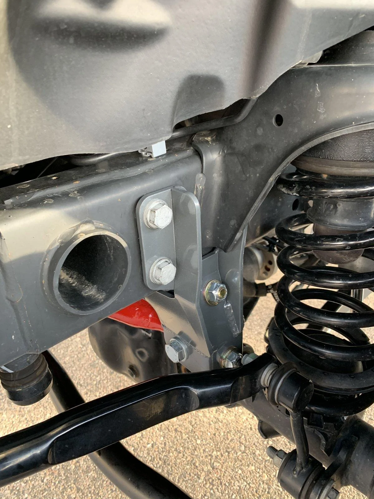

So a few months ago I picked up the fox TS stabilizer to throw on my truck. I will say it was a lighter feeling but smoother than the stock unit. Since I put it on I still have somewhat flighty steering (but I know that my caster is off which will be remedied shortly with my MC lift) fast forward to today... I installed synergy’s trackbar and sector shaft brace... wow Just wow... it shored my looseness up. Now I need to get my lift... till next time all.
180
29,422
34,994
I read an article by a suspension engineer talking about solid axles, and the track bar design - and his thinking was that there's still too much flex in today's designs.
Well, you took care of some of that.
I can't say I have a problem, but after seeing a youtube video about that track bar brace - I'm thinking of doing that anyway, just because. I'm sort of OCD about steering and suspension and brake things........
Interesting - you aren't the first person to suggest these can be a help.
Do you have a link or any more info on it?
Thanks!
