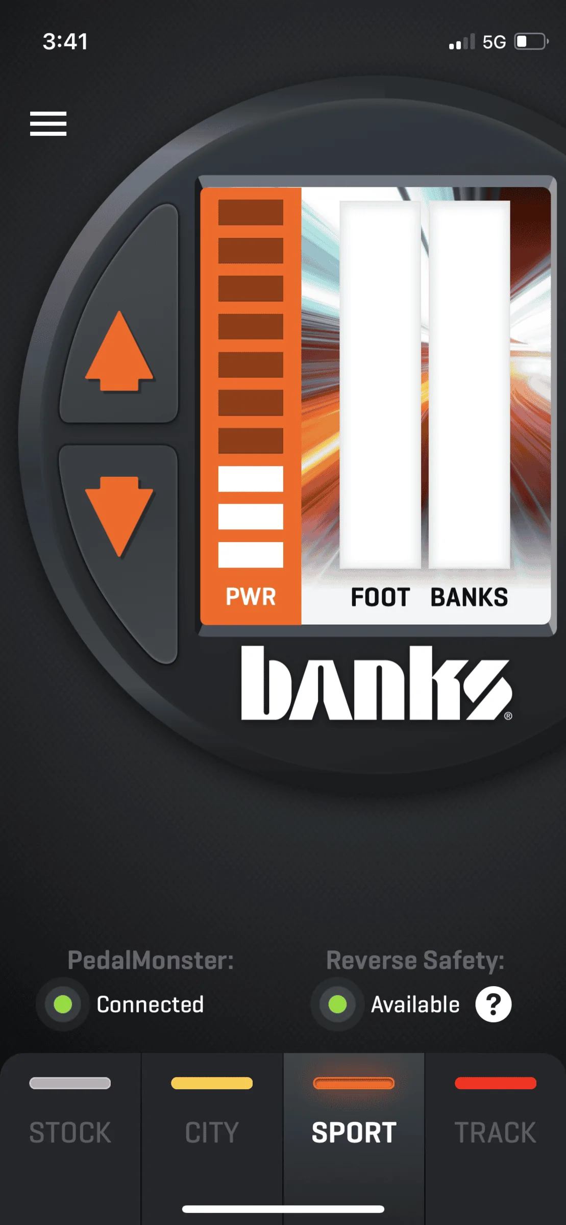

I love my Banks Pedal Monster so far. Lots of safety features built in like retaining stock settings for reverse and shifting back to stock if power is cut to the controller. The JT jumps off the line now, the power just seems more linear, and for some reason the transmission even feels more aggressive. Only annoying part is I now need to launch their mobile app every time I drive now. They do have some other options beyond the mobile app but they’re pricey.
I was a doubter as well but it seems like it helps Pentastar vehicles more than others. You definitely notice this mod. In general I just like driving my JT more now. This is not a mod that will improve your gas mileage though🙂

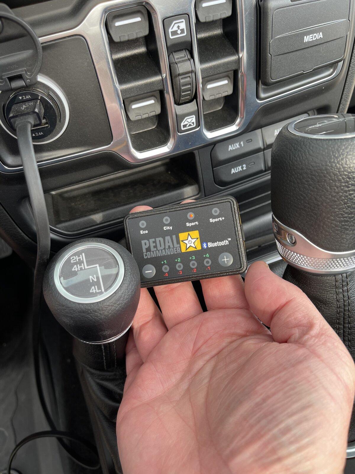

Pedal commander here. Makes the JT much more responsive. Much more than just crushing the throttle from the dig. One of my best mods.

Do you have to launch the app everytime you drive or just when changing settings?
It actually reverts to the last setting if you don’t connect the mobile app. Sorry if I wasn’t clear about that above. Still love it.
