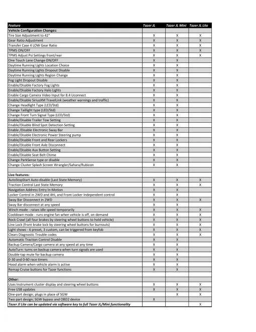

Yep, the Tazer JL Mini is ridiculous! You can change tire size, gear ratio, transfer case gear ratio (if you put higher or lower gears in it or swap cases), you can lock the rear locker in 2wd, you can disconnect the sway bar in 2wd, TPMS turn on/off, TPMS PSI adjustment, High-beams with fog lights (this is a VERY underrated feature until you use it, then you wonder how you lived without it), if you have the 8.4" Navi setup, you can set it where your backup camera pops on when you use your turn signals so you can see behind you, you can do all kinds of stuff! It's worth the money. And if you buy it from their website, you can buy a 2year extended warranty for $20 more (which I did to cover any possible electrical issues).
Here's a list of what it will do from their website...
Jeep Gladiator Tire change/ programmer *advice* Tazer JL Mini
