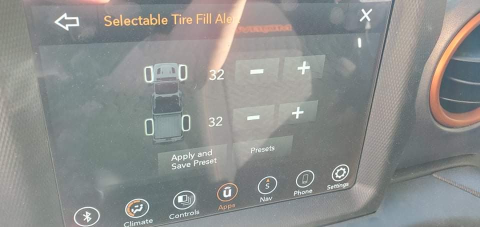

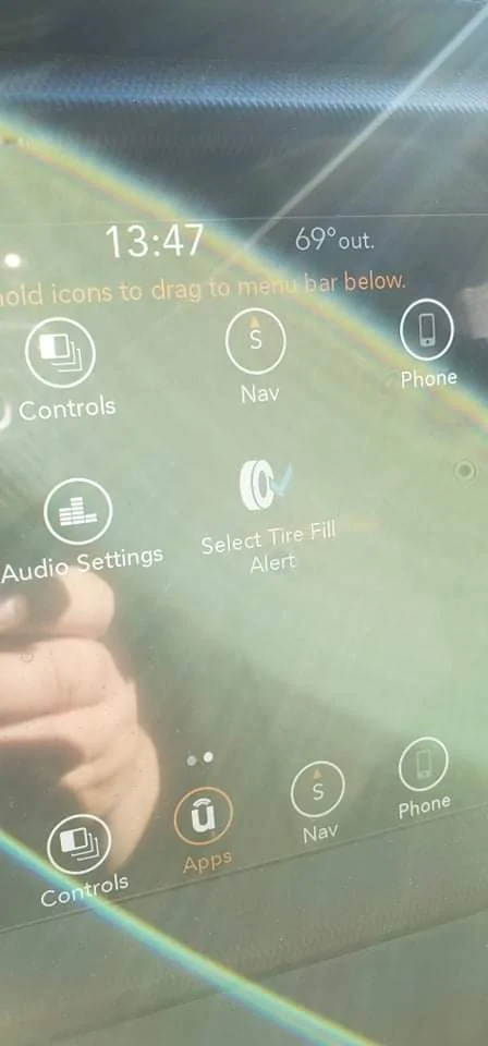

Hey all, just wanted to share in case others were researching as well. Some gladiators come with a tire fill assist but for those with build dates after June 21', they may not. My build date was Spet 21' and didn't have this feature.
After some researching with my local dealer who has a great off road section in the showroom, they experimented and this is how they got it added for me. Something about adding a sales code and somehow they got it programmed into my Mojave.
I believe you do have to have the 8.4 screen as a pre-req. But at least now it shows up in my apps.
For those of you that don't know what it does..... You set it up each time you air down (as low as 15lbs) or back up, then start airing up each tire. When the tire gets to your preselected and applied psi, the vehicle will honk to alert you that your at the desired pressure. Flashers do flash while doing this to make you aware that the tire fill alert is doing its thing.
Apologies for the bad pics
Jeep Gladiator Tire Fill Alert added for a Sept 21' build date received_920117808864179
Jeep Gladiator Tire Fill Alert added for a Sept 21' build date received_207146174908899

Neither did I haha.... until I saw a youtube video talking about it. Went into my apps and it wasn't there. But now it is. My kids go with me wheeling so they help me air down and up. My younger one usually sits in the driver seat calling out PSI after 30lbs so I know when to shut down the compressor. No longer needed.

It's actually in settings under safety and driving assistance, you just have to check it
Yes if you have it. But for those of us with newer build dates, it's not there. But can be added by the dealer.

Thanks for the info. I saw it on my window sticker. Mine has a build date of 2/21. I have the icon but you cannot select it. Hmmm... Next time at the dealer I'll have them look at it.
Did you try going into your safety and driving settings, select it there, then go back into your apps to set the psi and apply
Thanks, I'll go try that as soon as the boss turns his back.
