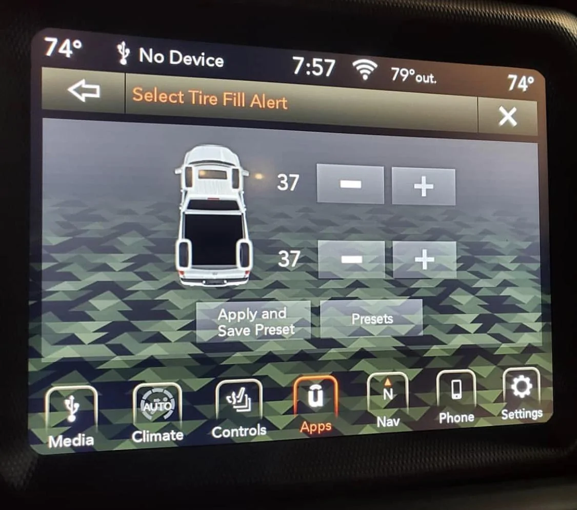

It is getting colder in Pittsburgh and it’s TPMS warning season. all 4 tires now dropped to 31psi (down from 34 when warmer). but only driver front and passenger rear have warning, other two are fine.
once tires warm up later in the day I am running 34/35 but pressure light stays on for those 2 tires.
Can I reset psi manually in settings or something?
Alert is telling me to air up to 37 psi.

To get rid of the warning, I think you'll have to get them up to at least 33psi cold. It has a range it compares to based on the factory recommended settings. I don't know if that can be adjusted without the aid of a dealer.

The warning goes off when the computer reads tire pressure of 36 or higher. It can then be dropped back down a few without coming in again.

To clear the warning air up to 37 psi and then you can drop them back to 32. I believe the warning starts at 31 psi, at least on mine it does.
Good luck

I JL Tazered mine to alarm at 25PSI & run at 31Psi

What trim package do you have? Do you have a 7in or 8.4 inch radio? If so you can change it in there.

Yes sorry I forgot to ask if it was a Rubicon I think that may only be available on the Rubicon
Yes i have a Overland and have off-road pages but not tire fill alert

You can go into Uconnect controls go into the settings and enable the tire pressure settings then go into tpms and you can adjust them on the screen
Now that cold air hit Ohio, my front tires dropped to 29 briefly. Don't want to air up to 37 to turn off warning. I have a Rubicon Launch but have been all over the settings and can't find tire pressure.
