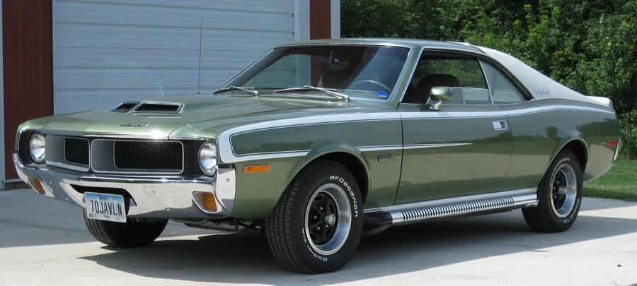

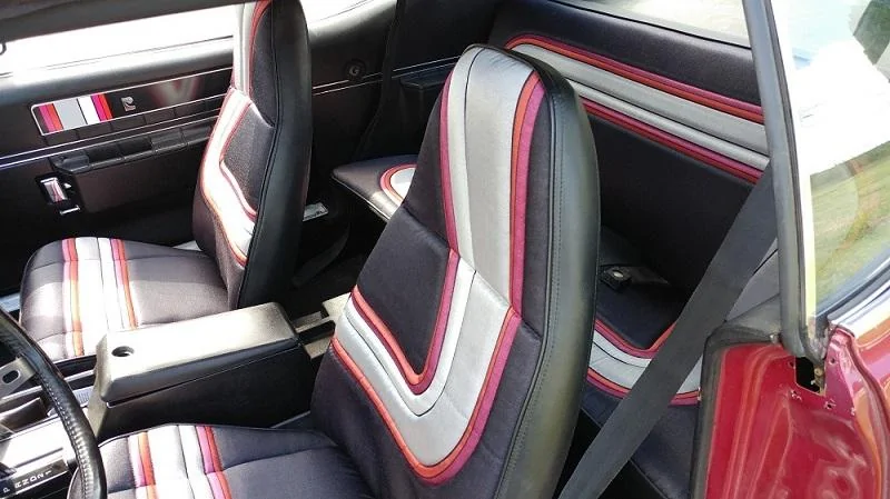

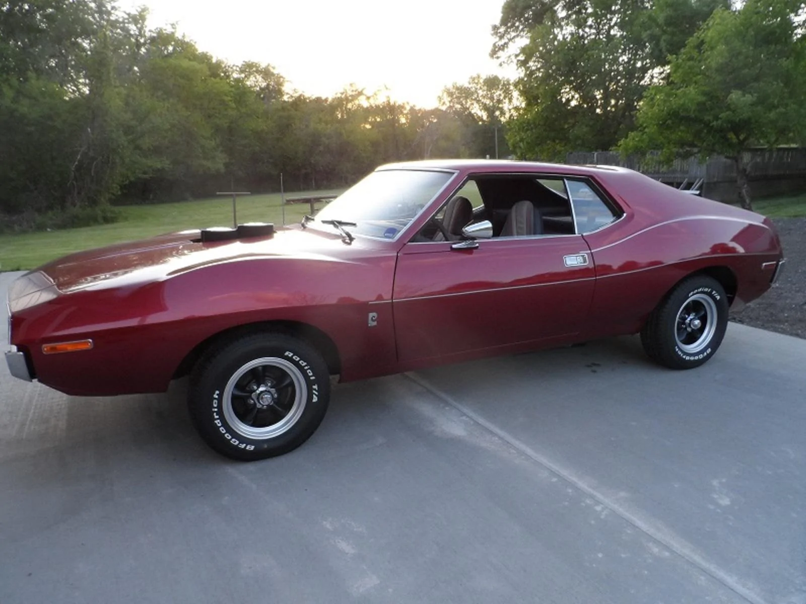

I am feeling sellers remorse a bit lately as the 70 is sold and just waiting for the truck to pick it up and take it home to Texas. But it's still in my garage until then so I can visit it for today and I can still look at the pictures.
A few years ago my brother started sending me text messages with pictures of the big body Javelins (the 71-74 years) and asking me what I thought. (at the time he had a 69 Javelin and a 70 Mustang convert) I thought it was looking at another car. I'm the car person in the family...
I'd find things wrong or like them but this or that...... finally he sent me a pic of a pretty nice one not far away and he asked "would you buy this car if you could" and I told him - brother, I can't afford another car now - you know that, it's cool but I don't have the money laying around for another now. I ended up looking at the pics and found that car while nice had been resurrected from parts - and the parts years didn't all match - 71 grill with 73 tail lights, etc.
He sent me another pic and link to an ad - and he again asked- what about this one? I said I love it but again, no way! That's even MORE expensive. He then said - I didn't ask that, I asked if you COULD would you? I said yea, love it and it's a PC Javelin. Then something hit me and I asked him - uh, what are you doing? He said " you told me one time you really liked those cars and wouldn't mind having one some day" I guess I forgot I had said that but I live the curved cockpit design, the dash wraps around the driver.
OK, Scot, why are you doing this?
Because you're my brother, and because I can.
Well this one was over even is budget - so I ended up paying a small amount. He rented a car and drove into WI, drove this car back and signed the title over to me. This is a car I can never sell and I just have to take care of it and do the best I can with it.
Powered by a 377 HP 360 -
And the 70 I just sold -
