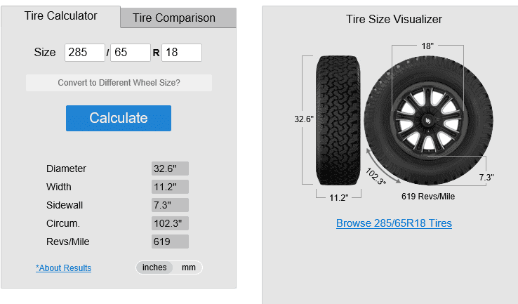

When shopping, tire sizes are shown as such for a BFG KO2:
  • Size: LT285/65R18 125/122R E
Can someone please break down part of these numbers for me?
Essentially, I'm looking for a 35" tire on an 18" wheel, but am having a hard time understanding what means what and the size I'd be safe with. The idea is that I'd do very minimal off roading (basically only driving on the beach) and eventually, I'd be looking to tow a small boat under 5k lbs with trailer. Bouncing back and forth between Overland and Rubi on build.
Also, from what I've read, the less the positive offset, the more the tire sticks out past the fenders (ex +25 would stick out more than +44. Once you go negative then it could become an issue). Is that correct?
LT - Light Truck
285 - ?
65 - ?
R - ?
18 - Wheel Diameter
125 - ?
122 - ?
R - ?

285- tread width in milimieters
65- sidewall height is this percentage of tread width
R- Radial
125/122R- Load and speed rating (106 mph for R)
E- Load range

So this tire would equate to what size? can you even tell from this detail?

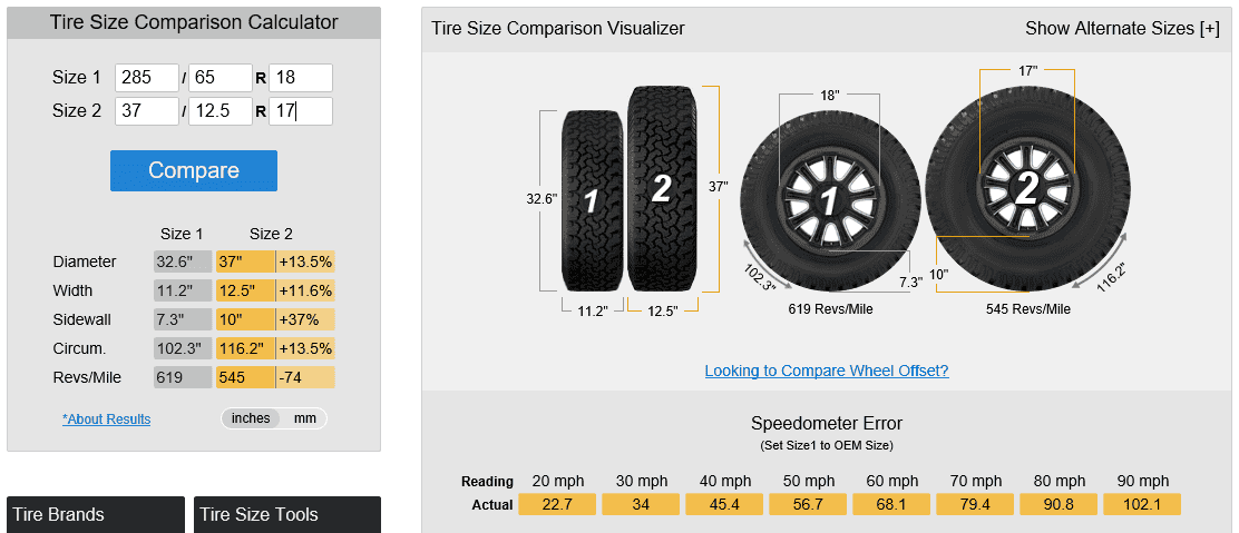

If you want a 35" tire, then buy a 35x12.50 for a 18" wheel. Easy peasy.
If you're shopping metric sizes, I suppose a 315/65 or a 305/70 would get you close.

Thank you, I guess this was the differentiation I was looking for. Some websites only go by one size, others by the other size measurement. I thought this was 'merica and the metric system didn't matter!

I would consider 295/70/18 or a 285/75/18 in a Nitto Ridge Grappler if you must go bigger than a stock Rubicon 33" tire. I run the 295/70/18 size in a mud terrain on my JL Wrangler. It measures out to be 34.29" in diameter by 11.77" wide. I prefer a little bit narrower tire than a 12.5" wide as I've found over the years that a wider tire tends to cause a little more wandering on the road as it grabs more of the road and the contour of the road. Now playing devil's advocate here, if you are only doing minimal off roading (mainly beach if I understood your post), why the lift? If this is your first Jeep which I'm assuming it is based on your questions, you are getting ready to dive into uncharted territory. Lifting a Jeep will alter it's handling and driving characteristics from stock form. Adding bigger and heavier tires will also change the ride of the Jeep from stock. Many new Jeep owners do this not knowing exactly what they are getting themselves into and then they regret it. It ends up being a very expensive venture for them in many ways and they eventually become so frustrated that they end up selling or trading their Jeep for a loss. A stock Rubicon will do everything you are looking for in a Jeep and then some. For your purposes there is no need to lift a stock Rubicon or put bigger tires on one. By the time you build up an Overland, you will have spent nearly the same amount if not more than you would have on a Rubicon. Trust me, I've been there. Good luck with your decision.

Most 18’s limit you to an E-load range tire which I am not a fan of. They are really stiff. Basically a tire suited for a one ton truck
18’s are generally more expensive than 17’s as well
I just got Toyo Open Country M/T’s in a C-load range for my Rubi ((315/70/17 is a 35X12.50)
You may want to consider a full set of 17’s from someplace like Discount Tire Direct and then off loading the 18’s
