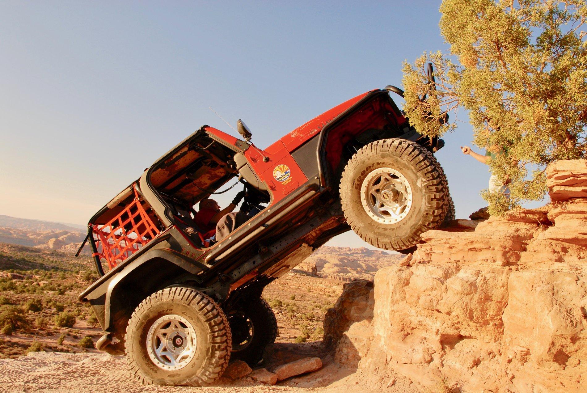

Here is the tire at 3-5 lbs, note the sidewalls.

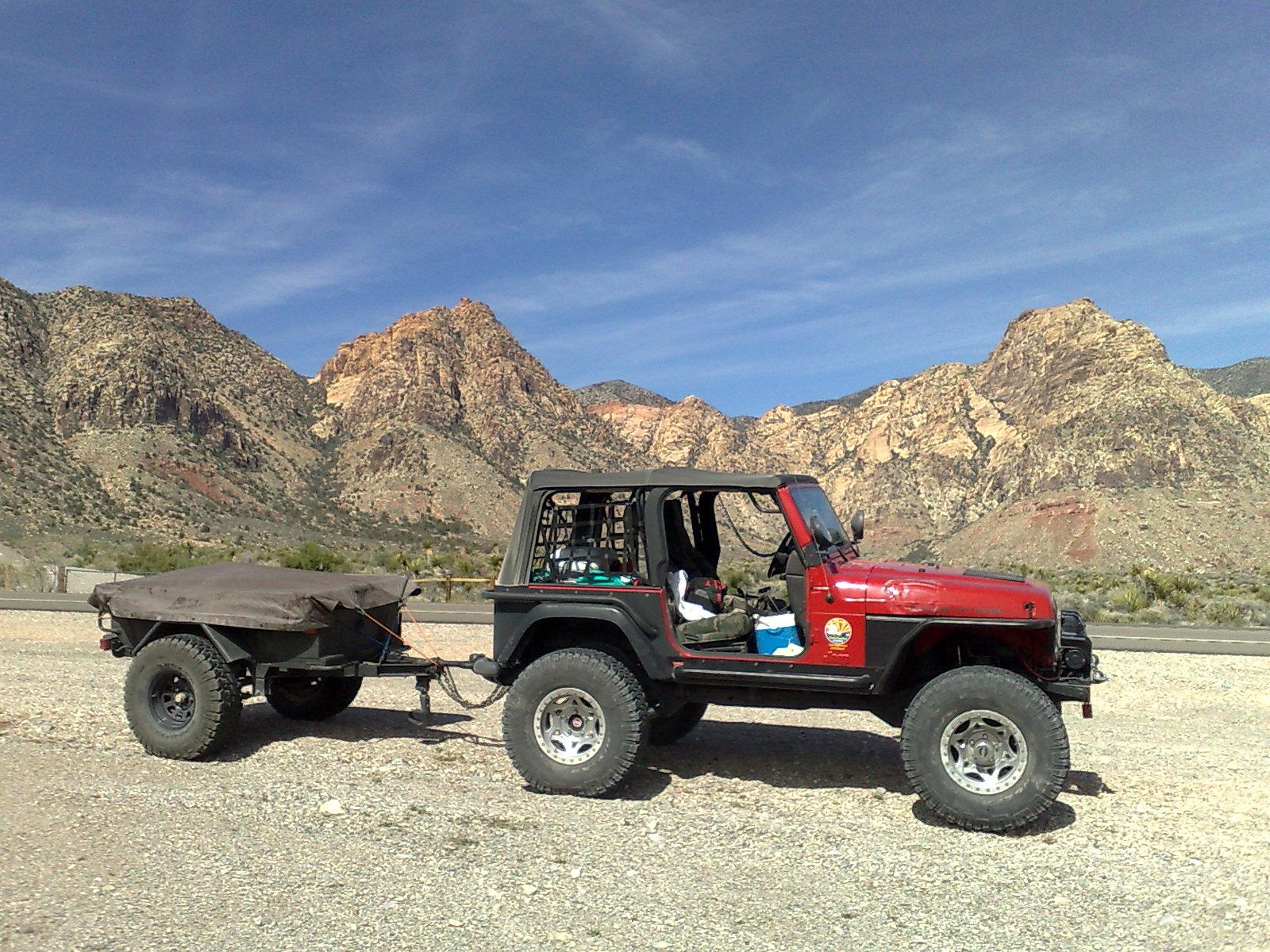

Pic 2 is the tires at 16-18 psi. I would add 2 lbs (18 psi) on trips from Dallas to California, Moab etc.
