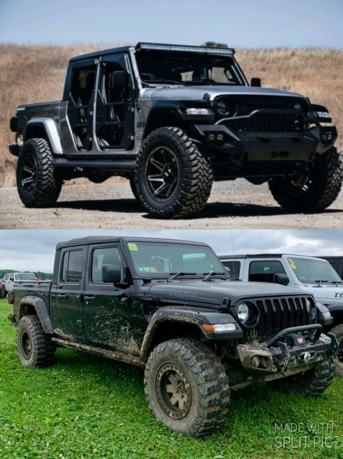

I want my new Gladiator to have the same look as far as the tires and wheels go. Can anyone tell me what size everything is? Including the lift? It's the Willys model.
Thanks!!!

This is a little more complicated then it seems. The lack of hood louvers says it’s not a rubicon, but at minimum it has rubicon front flares. Unless you find the owner, getting the exact specs will be hard.
For context, here is my willys:
3.5” Front Lift / 2” Rear Lift
35/12.5 Tires
17x9 wheels with 4.75” backspacing.
x2
To me this looks like an Overland trim with those running boards, but with Rubi front fenders. I would guess its around 2"-3" of lift on 37s with 20x10 wheels
