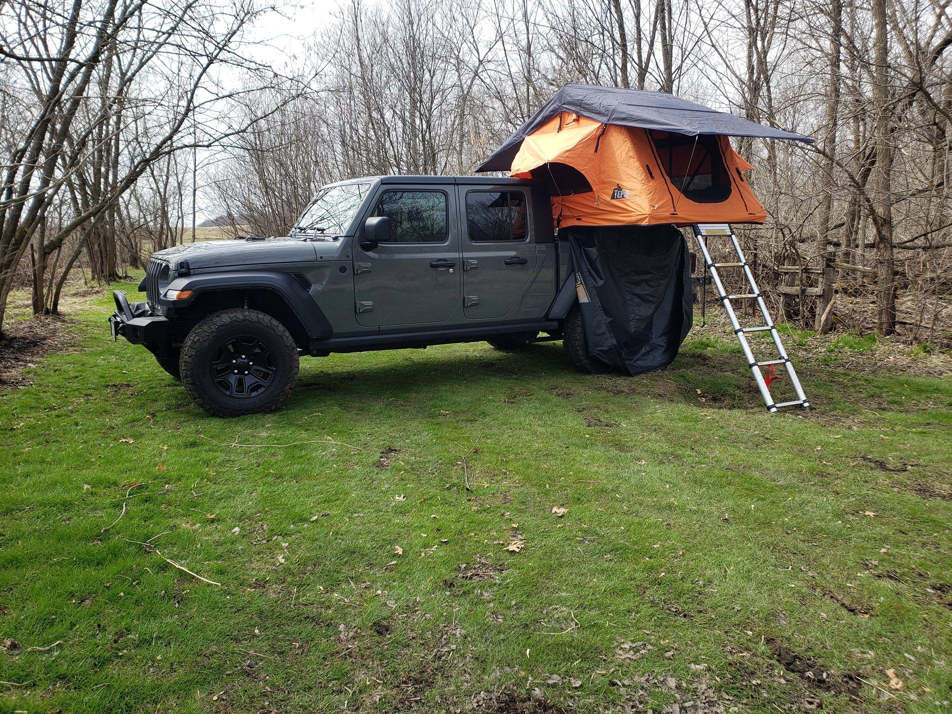

Member @RodRecket has a Voodoo Crossmember setup that might be ideal for my situation. I'll be able to install and utilize one side of the tonneau cover using these with a RTT.

The way i have it set up is ideal for my situation with a rolling tonneau. You could reduce the space between rails giving you more room to open a tri-fold but i dont know how this would affect the sturdiness of the RTT. Here's a pic from camping
. The setup worked great.

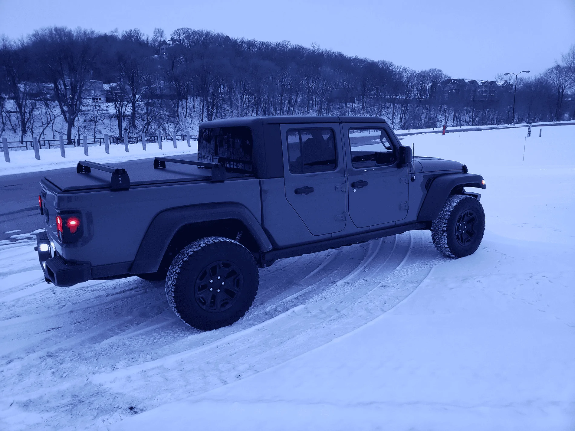

I spoke with the folks at max mod. The rack for the gladiator will work with the trifold Mopar cover sort of. You can mount the rack but you cannot open the tonneau cover
That is the setup I have. You can kind of see the setup in my profile pic. When I am not carrying my RTT and need full functionality of the bed, I just remove the crossbars by removing 4 bolts (they have a plastic knob)...no tools required. Not perfect, but works for my use.

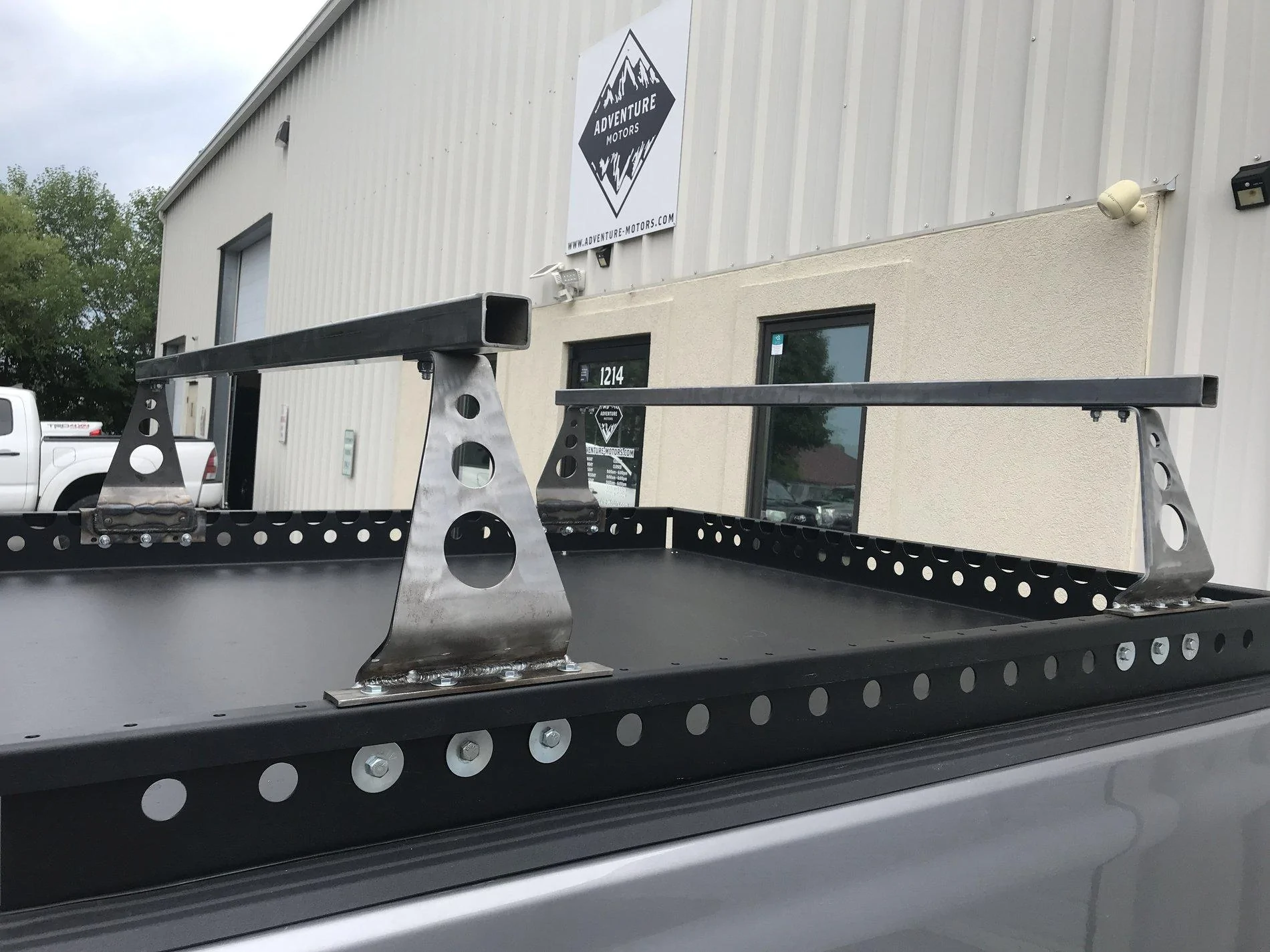

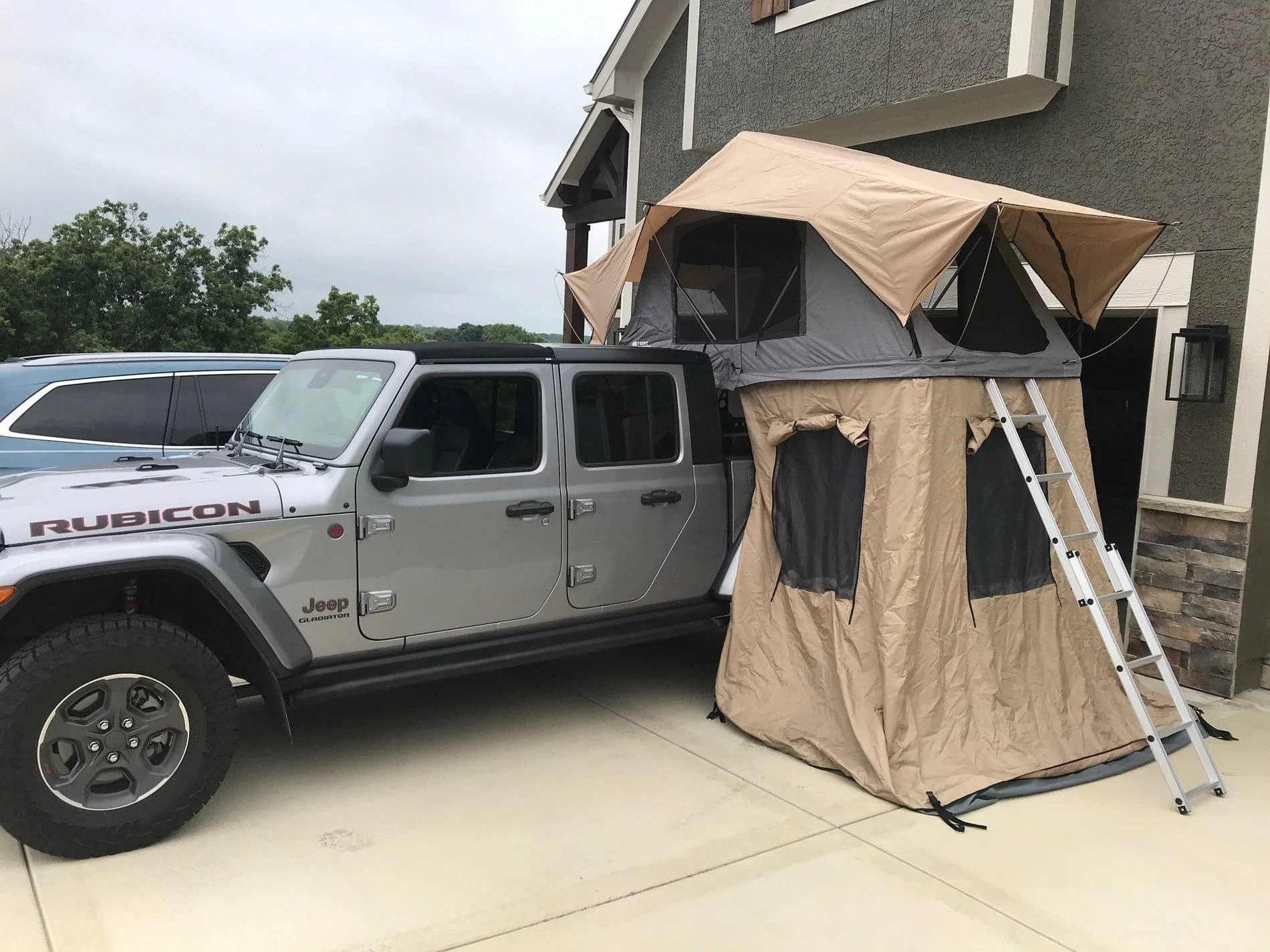

So I finally got my brackets fabricated for my Ace Upper Decker.
I still need to prime and paint the whole set-up (bars, towers, hardware), but here is a pic for now.
The Custom Camping Concepts towers (with cross bars)have been welded to a bracket that attaches into the Ace Upper Decker. Total overkill, but each bracket has 4 bolts on top going into the Decker, and 3 (with washers) in the side holes. It is not going anywhere.
When I reinstall, I will probably not even use all of the bolts - depends on how long it takes me to put them on and take them off!
Once I prime and paint, I'll be getting a Roof Top Tent for this, but I'd also be able to use a Roof basket, or anythign I want with those bars.
LTCSlacker
Nov 30, 2018
125
72
Kansas City, Missouri
2020 Jeep Gladiator Rubicon (Billet Silver)
Military Officer

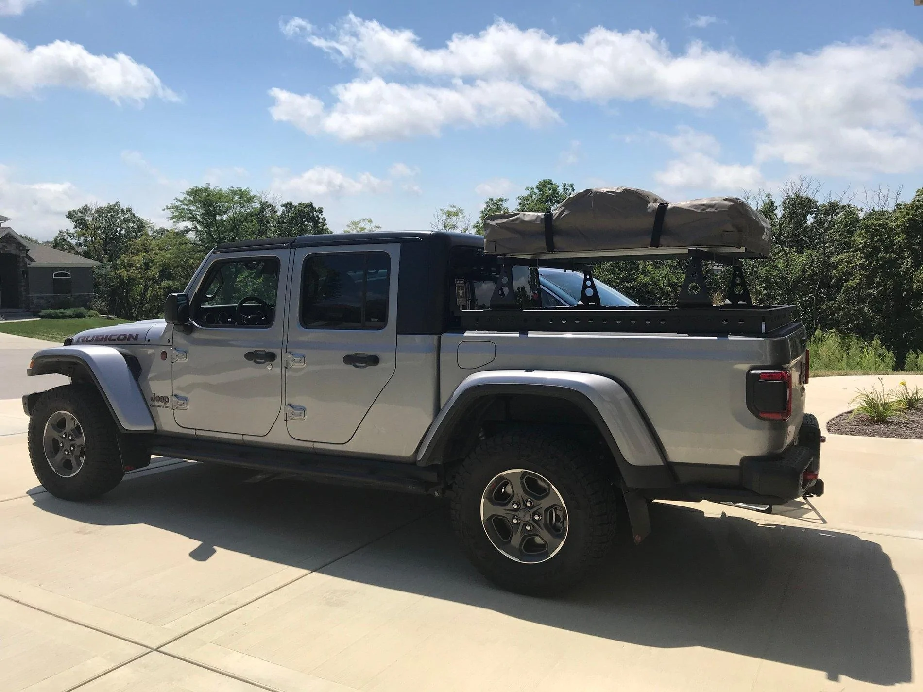

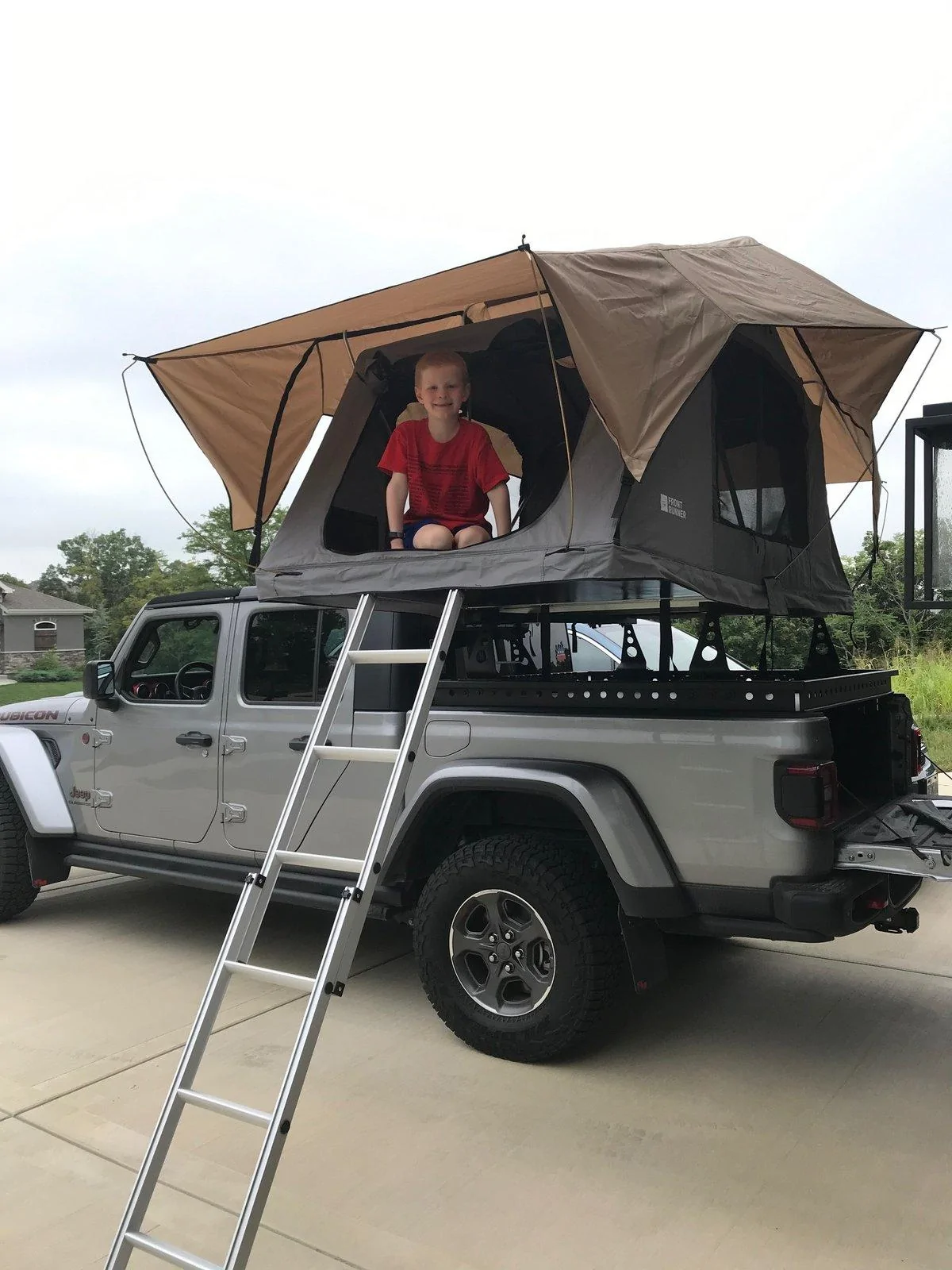

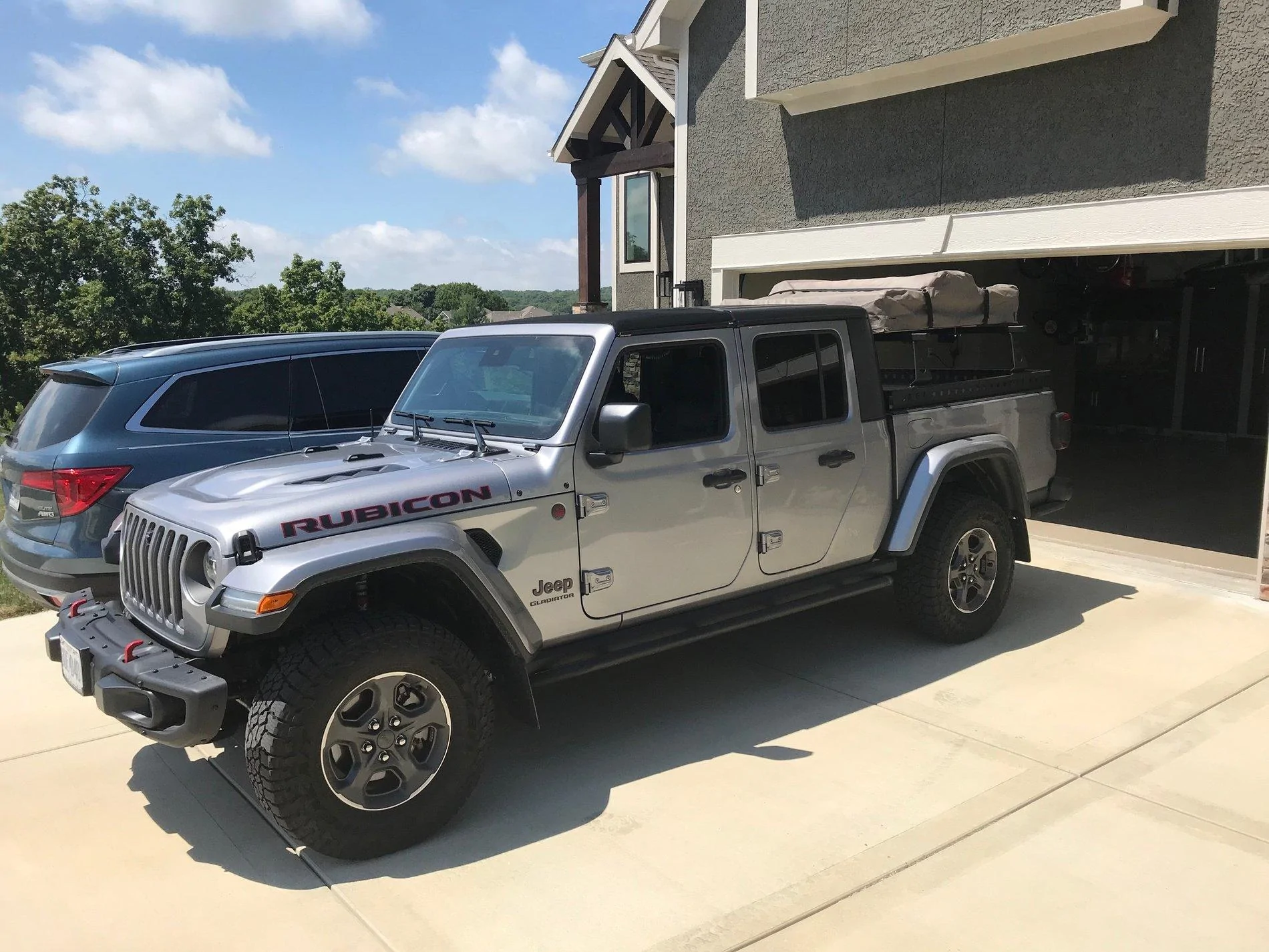

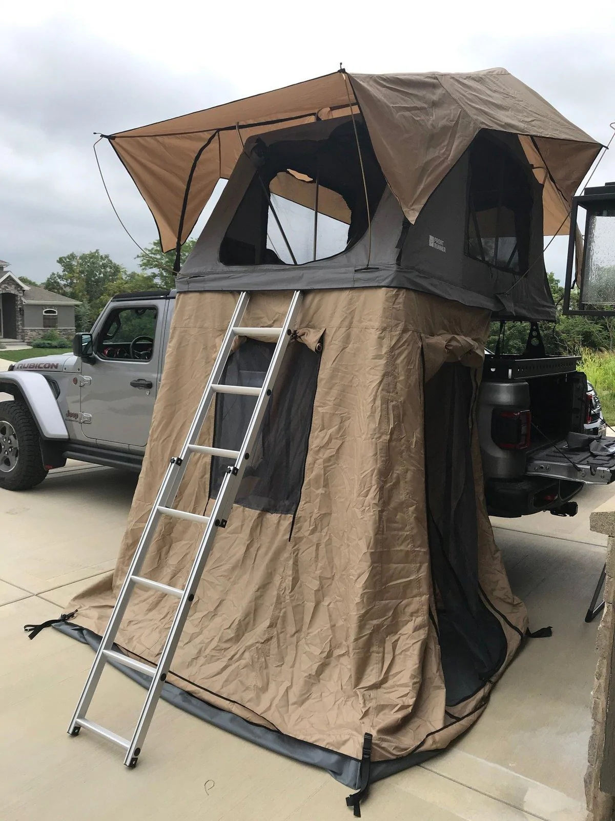

So I have finally gotten my rack parts painted, and my Roof Top Tent arrived, and it's all now put together.
In sum, I have:
1) Ace Engineering Upper Decker
2) Custom Camping Concepts Towers and Bars
3) Welded plates on the Towers that bolt to the Upper Decker
4) Front Runner Rooftop Tent and Annex
It all works great. My only issue overall is that the Upper Decker will no longer stay up all on its own, due to the total weight. I can open it, but I'll need to get something to hold it open if I need it that way temporarily.
All in all, though, I am very happy with the set-up. Driving at speed shows little noise, even with my Bestop sunrider open. Pleny of space in the bed (under the Upper Decker) and on top of the Decker (under the tent). Pleny of visibility out of the back window.
Now just to get out camping!
