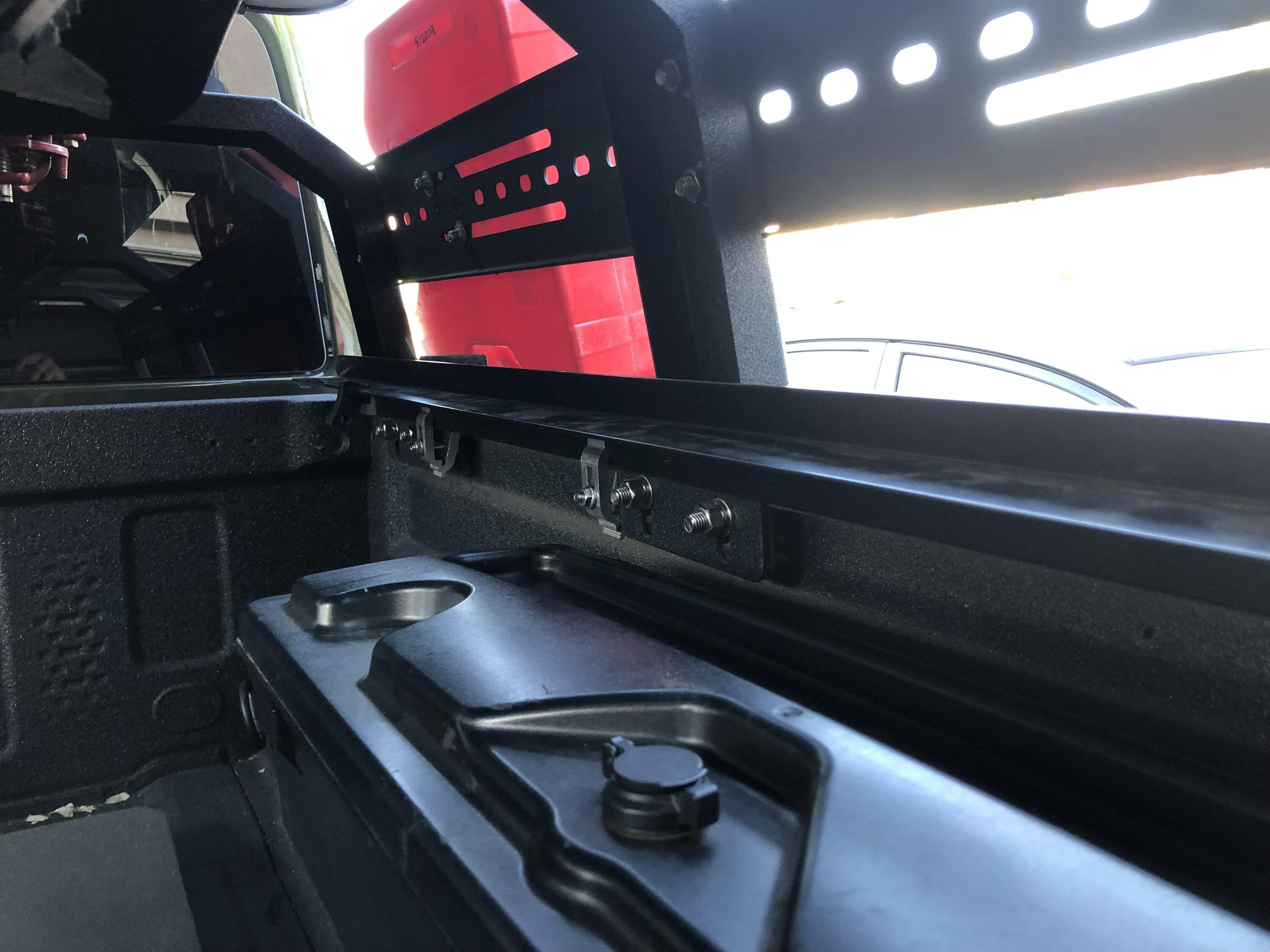

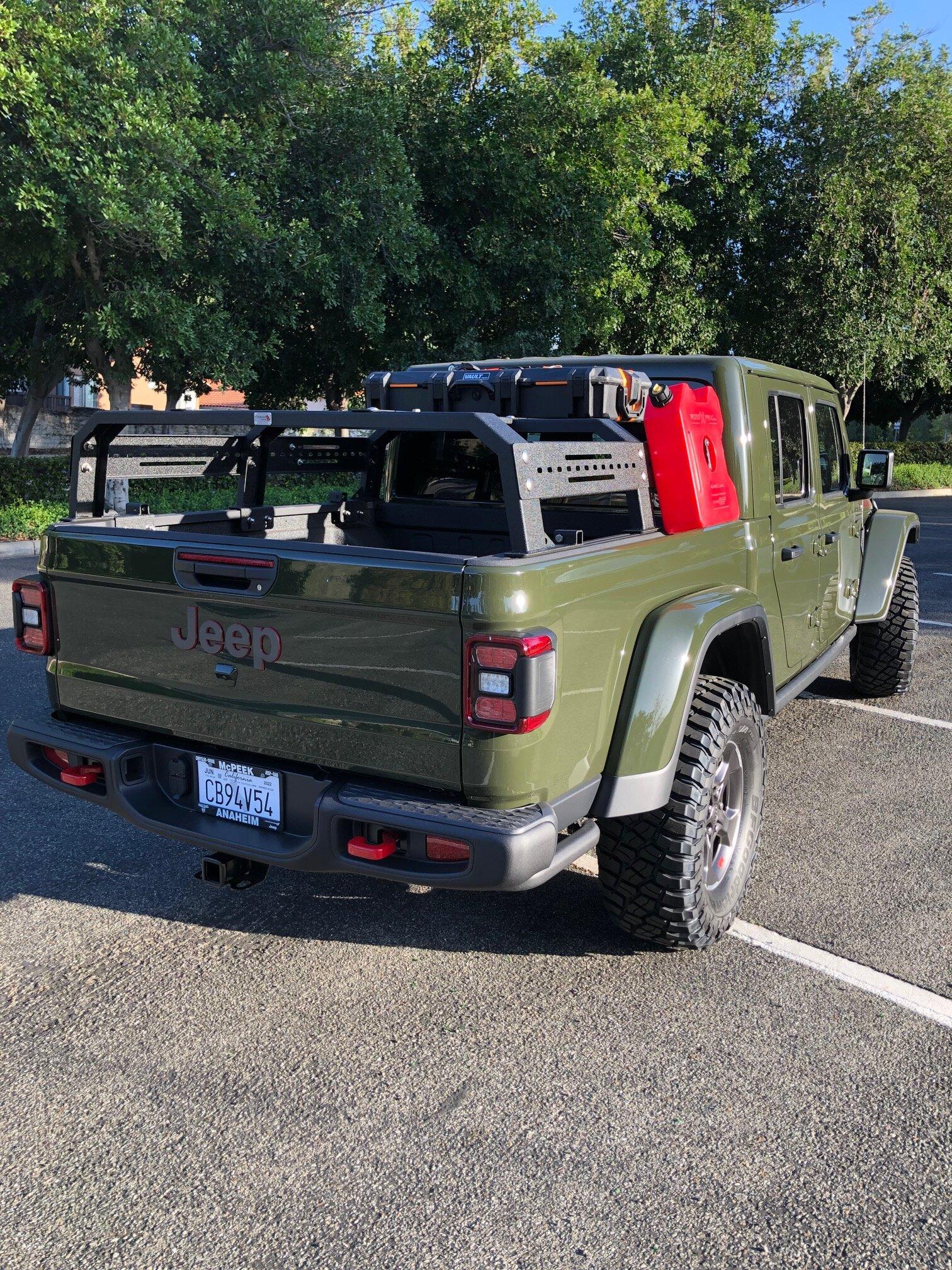

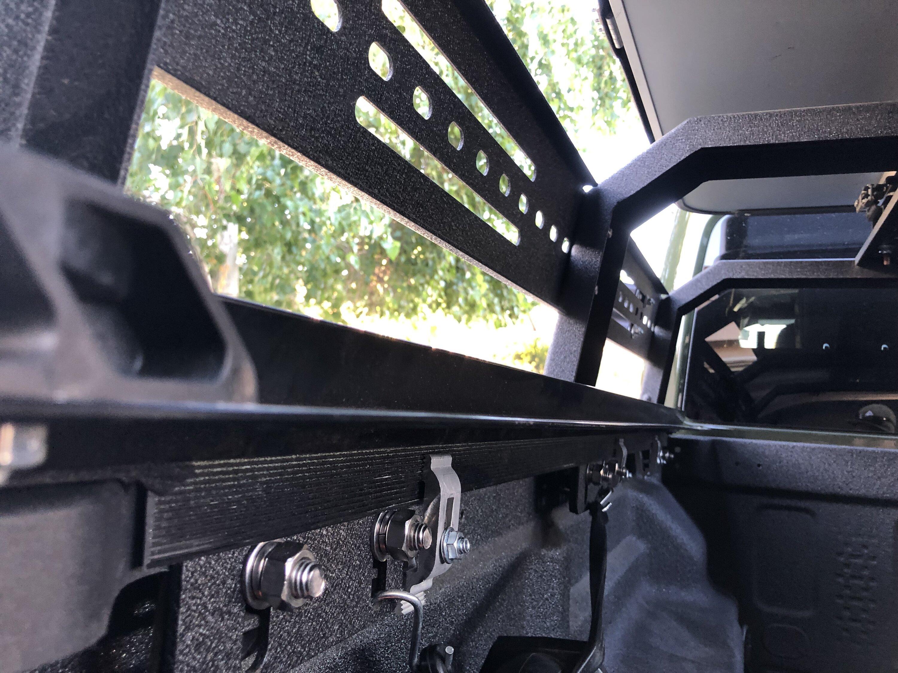

It will work, and may work under other racks too. Almost done, the side rails do fit nicely. Options to direct pinch mount, what I’m using, or onto Mopar side rails. Here’s what’s on so far, need to adjust the rolltop for fit, should be the easy part, more pics to come.

Did you end up getting this to work? And do you have pictures of it installed I could see? Just picked this rack up and looking for cover options. You did not use the trail rail system to install the rack looks like? Thanks!
