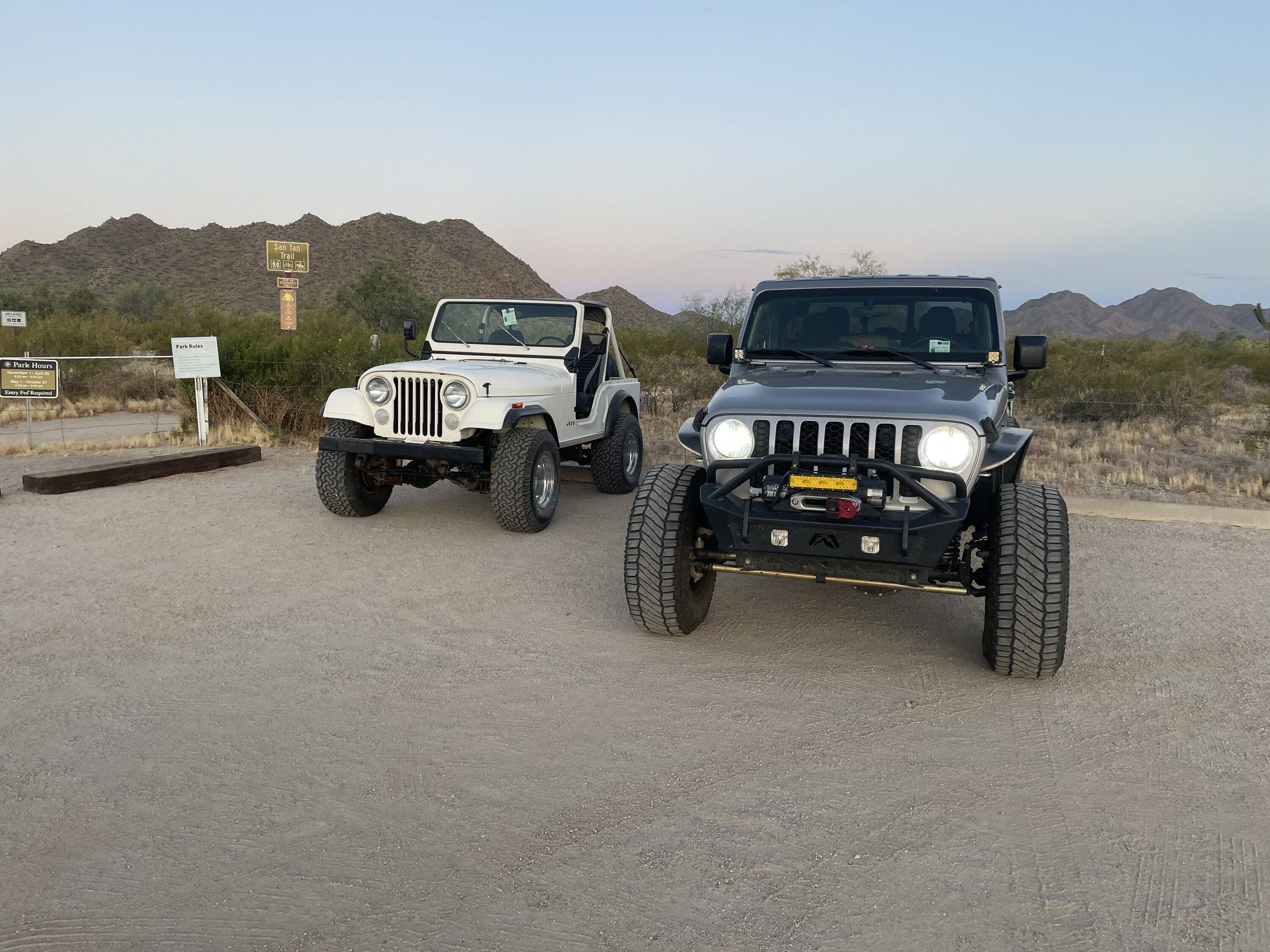

You will have a lot of tire poke.
Russel
Steven
Jul 3, 2023
Tucson,Az
2023 Rubicon Gladiator, 2015 Jk Rubicon 2 Door
Water and Ice Tech
If you want to take out windshields and rock chip the side of your rig it will be a good fit. To each his own. But I am kind of tired of have rock chips and broken windshields on my rigs. Not to mention tthe safety of pedestrians. . Many folks run there trucks like that here in Tucson. Zero enforcement here even with laws on the books.
So think about wheel and tire choice with a sense of consideration for others.

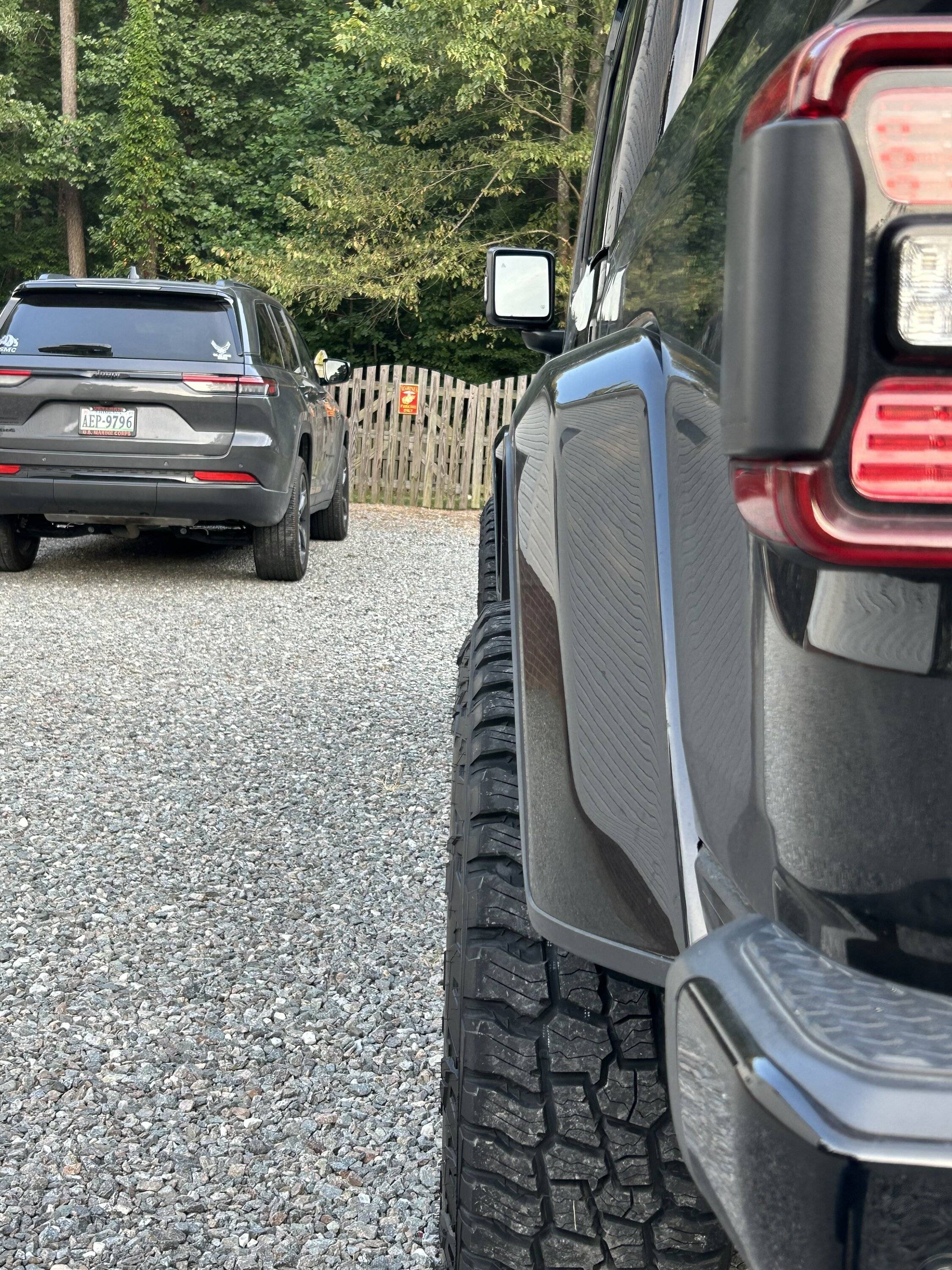

Orange01z28
Andrew
Aug 19, 2020
63
1,352
1,703
Queen Creek Arizona
2020 JT Sport S
I have that much
