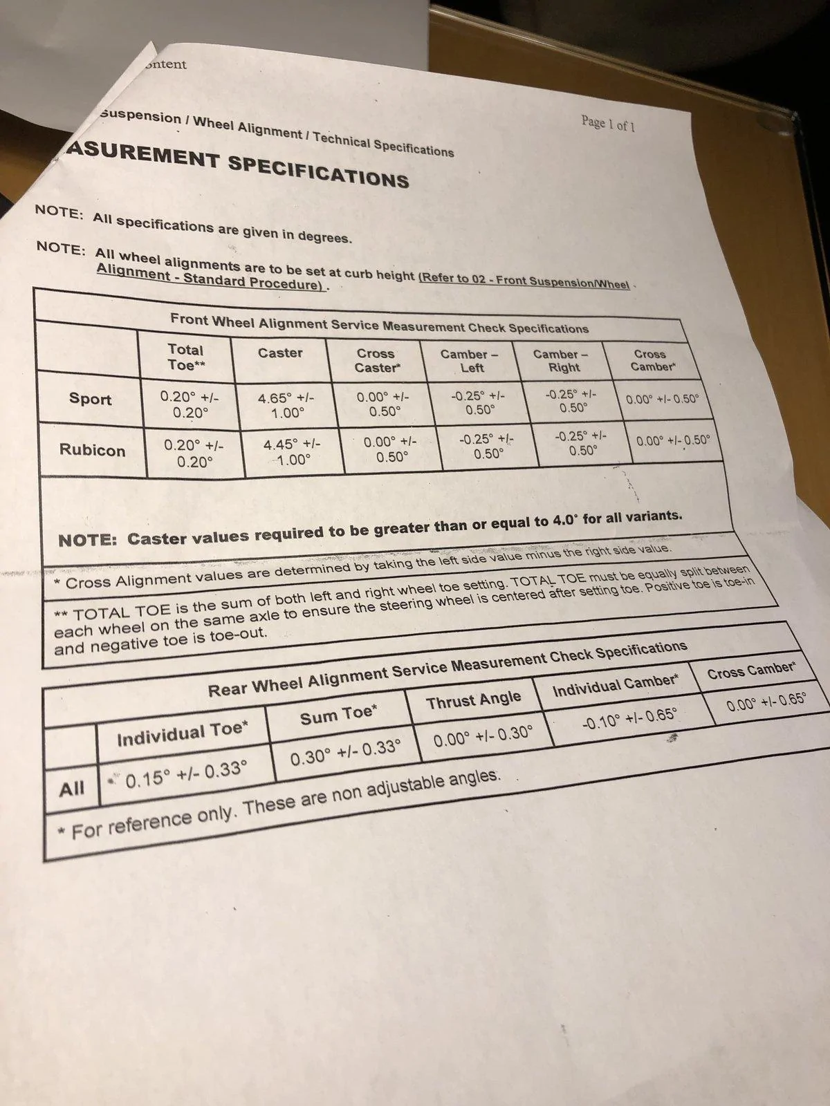

Having owned both a JL and now at JT, the steering is definitely different in how it functions on these vehicles. Most other vehicles, the steering does naturally self center when driving down the road for the most part with inputs only needed for actual steering function. With the JL and JT, there is more driver needed course correction but nothing to the extent I would call "loose".

You just described what too little caster feels like, there was a TSB or some info from FCA I found and the new parameters on the JT about the alignment numbers and JL's and JT's like more caster than JK's did. (4-7) When I picked up my JT we aligned it (yes it was out of spec from factory) and we ended up at 3.8 and 3.9 and the FCA supplement said it wanted to see numbers no less than 4. Contradictory to the 4.45 plus or minus 1 that was stated on the supplement (so 3.45 should be withing spec) just above that note about nothing less than 4 so it is a bit confusing. Yes of course the electronic steering will feel a bit different on top of what I just said.
Seems like myself and the others that have already changed to wider tires are liking the way it drives, I am sure that is directly due to the electronic steering.

Is there a document number to that supplemental alignment page?
smess
No sorry it says its from tech connect
library.fcaservices.com and then a long string url that does not even include all the characters and numbers
only the dealer can login to it but they should know what it is.
