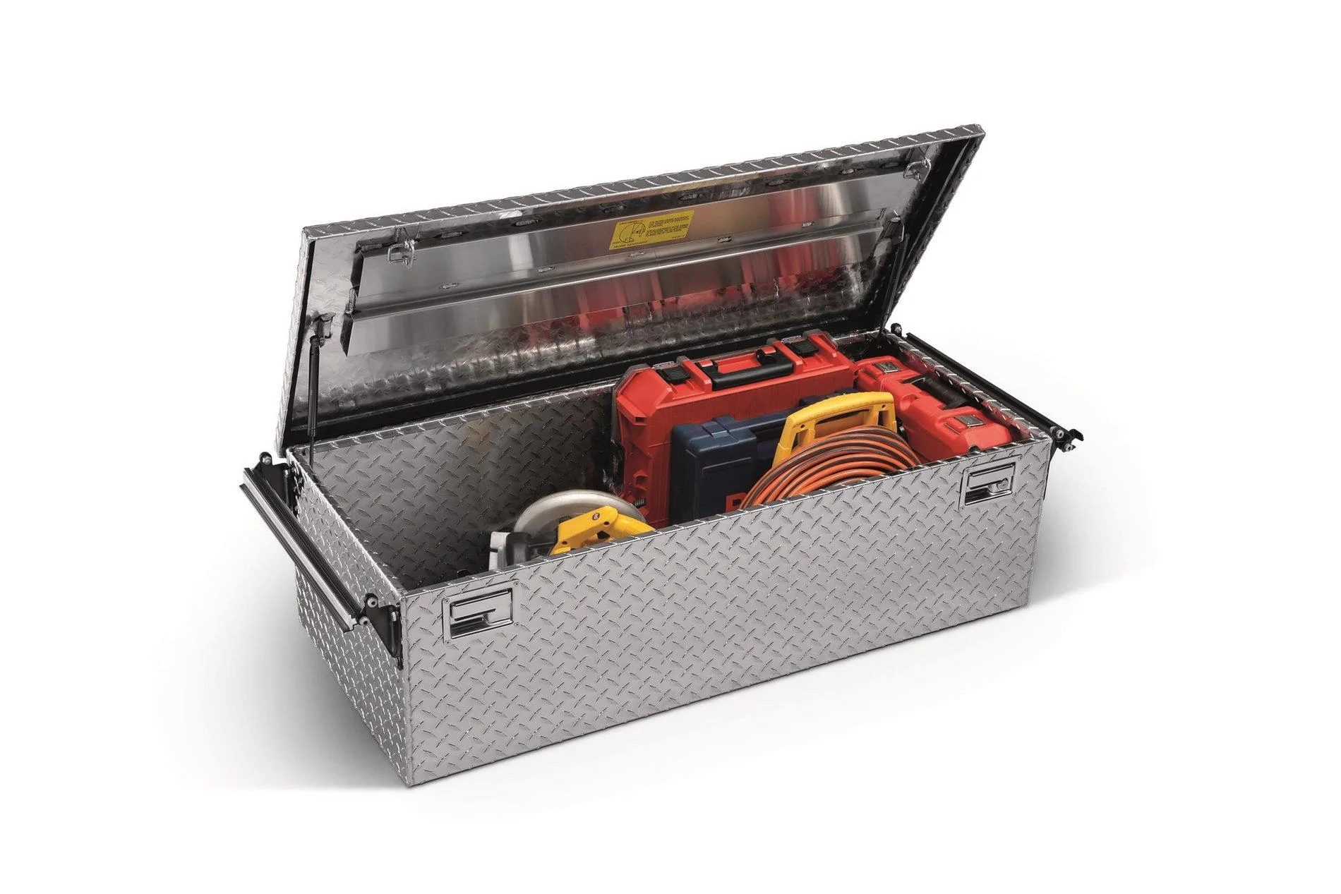

Have you looked at the dodge rambox toolbox? Built to slide on the bed rails.

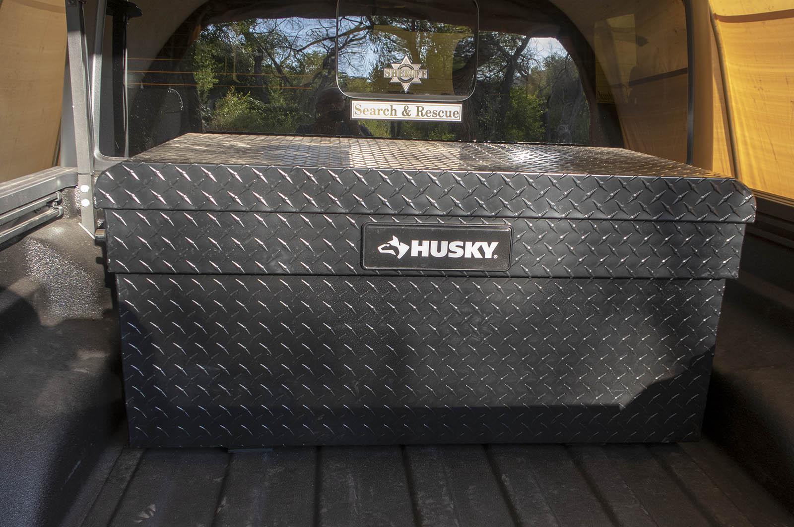

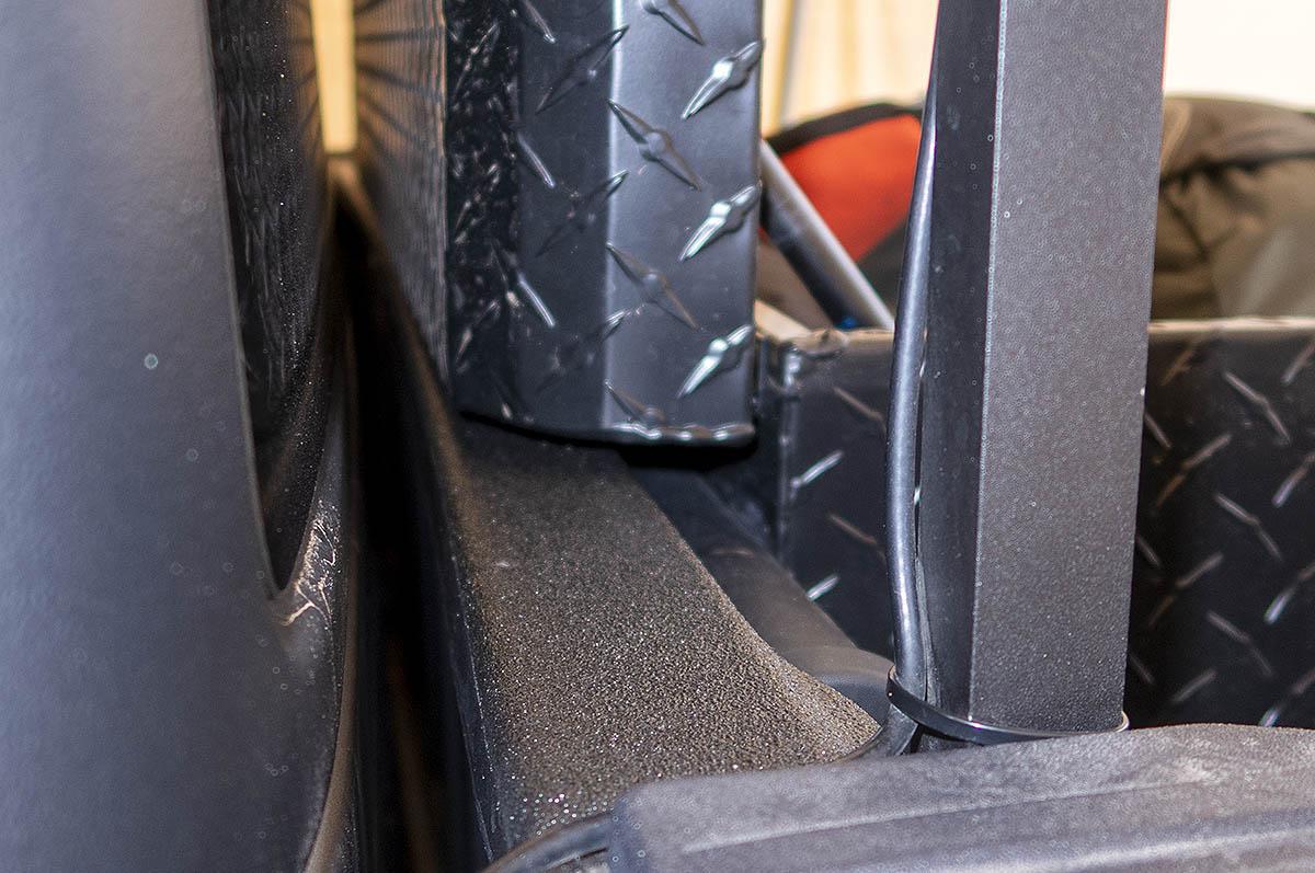

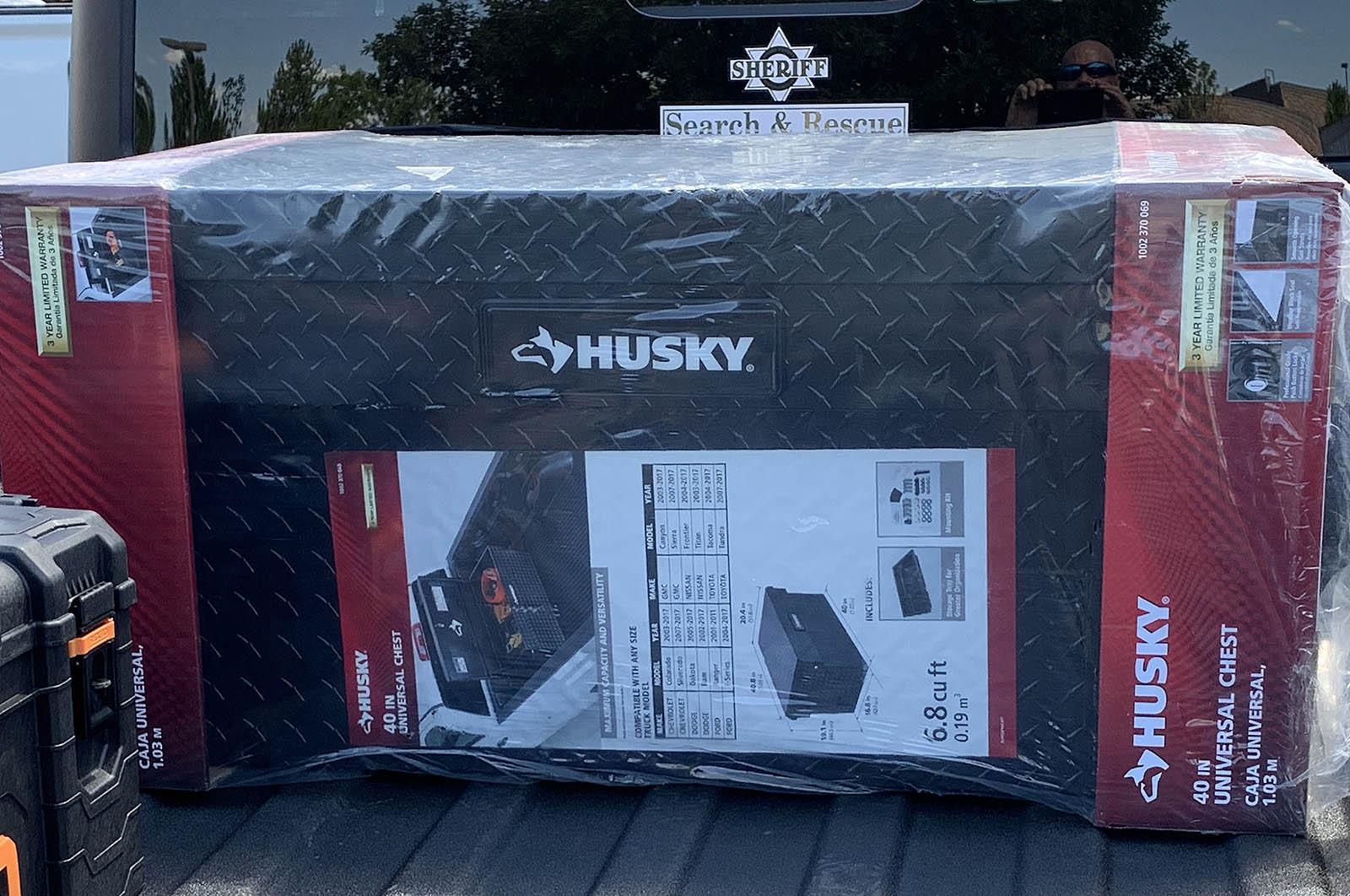

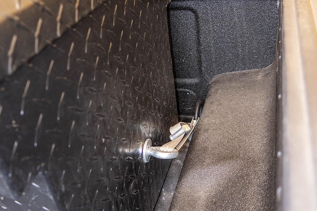

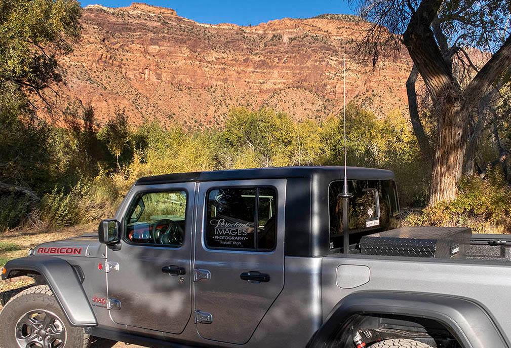

I picked up an aluminum Husky box at Home Depot 6 months ago. I raised it about 1 inch so it could sit flush against the front trail rail and the lid would not hit the front bed rail when opening. There are 1/4-inch thick rubber strips on the bottom of the risers so they grip the bed really well and the box does not move from side to side on rough trails. I did not want to drill holes in the bed to bolt the box down. It's secured with cam straps and a cable lock, so it can be removed easily if necessary. The straps and lock are attached to eye bolts I installed in the box. The latch/lock is on the side so you don't have to climb into the bed to open it.
It holds a LOT of stuff...tools, recovery equipment, shovel, rescue packs, camp chairs, Viair 450P compressor, first aid supplies, and a bunch more.
