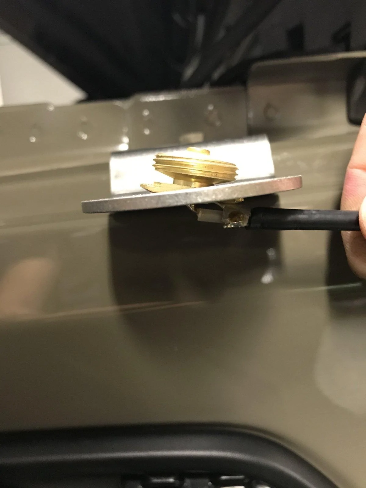

For those who have used the Topsy NMO fender mount, I’m having an issue getting normal NMO assemblies to go through the hole. It’s cut at 3/4” diameter which is correct, but most NMO mounts are meant for the thin metal thickness of a vehicle roof. This mount is much thicker and doesn’t allow an NMO to angle in and mount in the hole. Has anyone else ran into this? I assume a thick-mount NMO is required?

I had the same problem. I ended up buying a reaming bit for my dremel to make it a little larger.

This might be a cable/mount issue because I have two brackets from Topsy on the Jeep and they're both fine with standard thickness Larsen NMOs.
I'd suggest one of those because not only do I know they work, they're also sealed so you don't have to deal with water and corrosion working its way into your feed line. You'll be running that cable again in a year or two if you don't seal off the bottom properly.

They make a thick panel NMO mount that would work. To add to that, keep in mind that you VSWR and performance with that mount will suck. It will not provide enough ground plane for any real application.

Works better than you'd think but unfortunately, there's just no good options on the truck aside from doing a roof rack with an aluminum plate on it or a dedicated HF mast. Fiberglass roof problems I guess because I'd much rather just drill the hole.

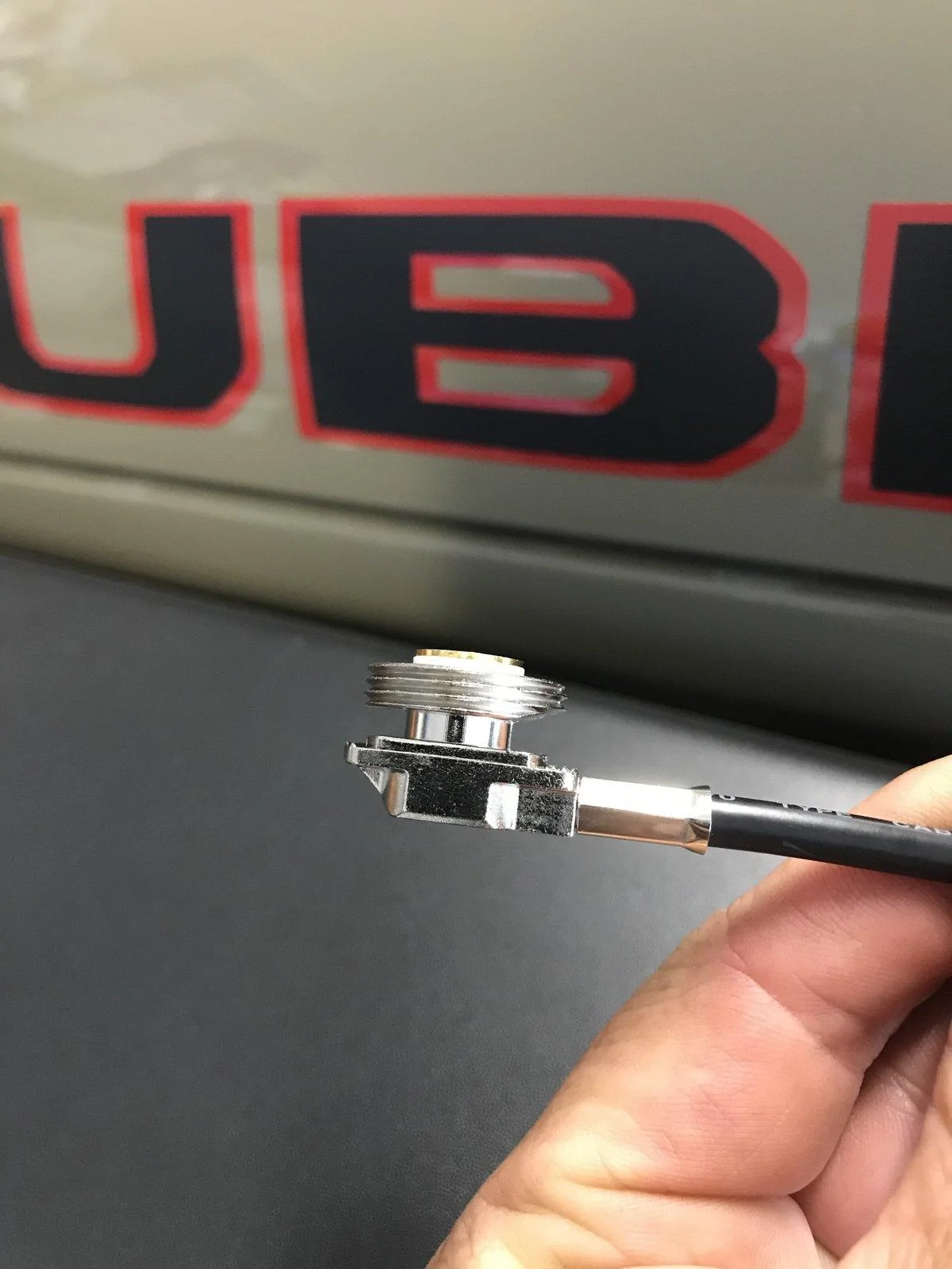

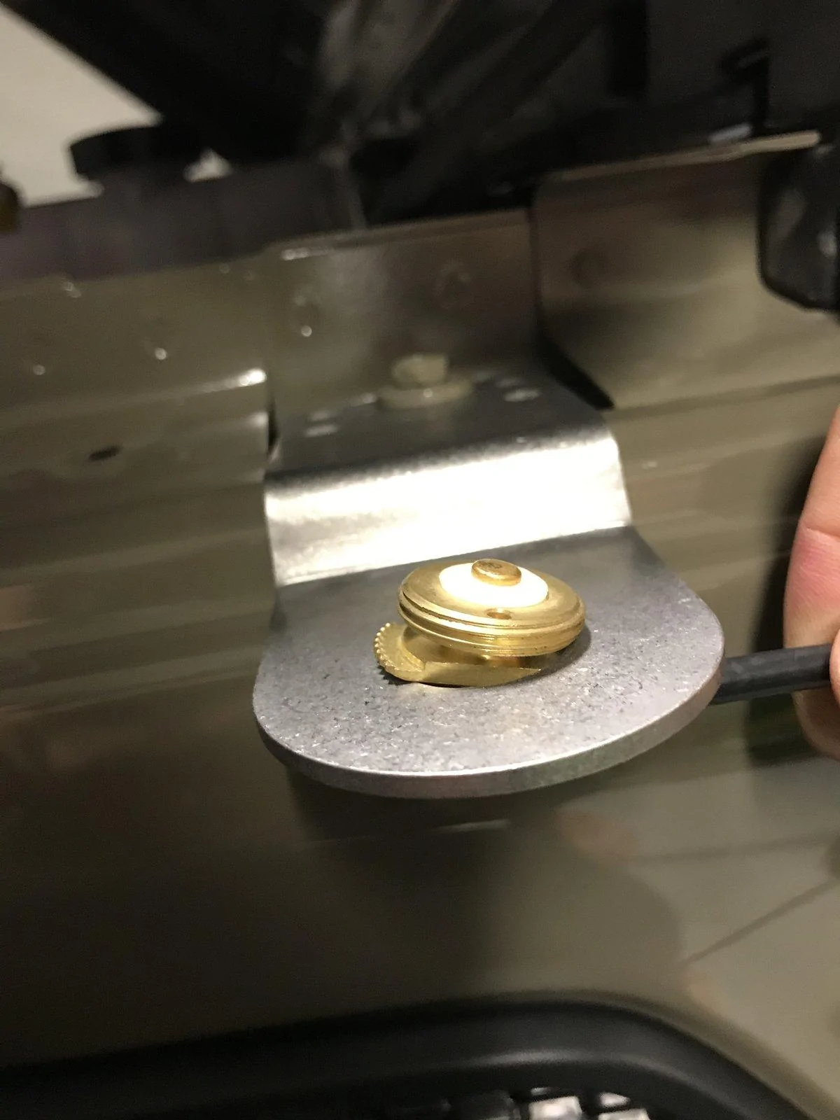

Good news, I found a Larsen NMO and it worked. The space intended for the thin metal car roof was much more wider than the Laird and it fit the mount perfectly. The Larsen part number is NMOKHFUD25.

Totally forgot the side of the larsen was notched... that's exactly why it worked vs the others I'd bet.
I'd recommend some shrink tubing with the adhesive inside over that end. It will help reinforce and weather seal it.

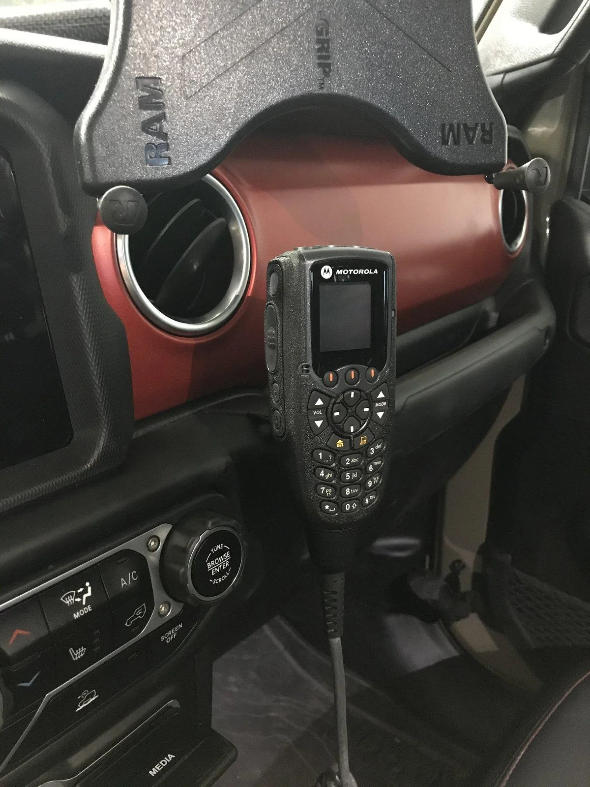

Id like to see where you mounted the O7 head. I have a dual deck 7500 in my JK but couldn't find anyplace to put the head in the JT. Would rather have a full function head but its not critical.

Is that the motorcycle cover on the head ? I had thought to mount mine there but wasn't a fan of it right on top center.
67 designs rail with standard mounting bracket and motorcycle sun shield
