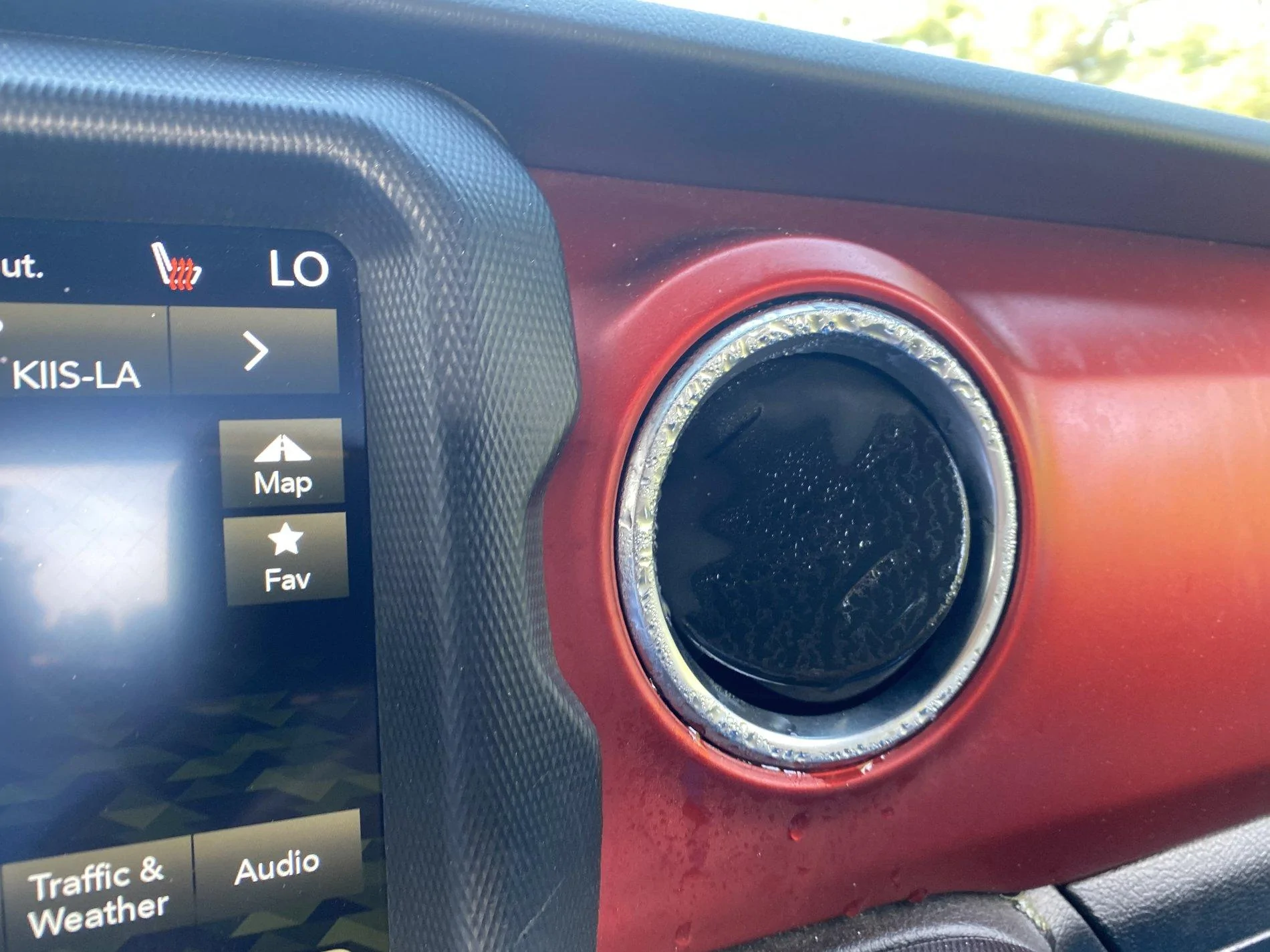

Ok, the reason I ask... I'm trying to pinpoint my issue as well and I think mine is pinned to moisture whether it be humidity, condensation or both. I am in NJ and do notice it happen more frequently after the Jeep has been on the beach while I surf fish or on humid days when the AC is dripping condensation. I have already had the radio replaced once and have an appointment tomorrow to get another radio replaced which will be my fifth visit for touchscreen issues.
Keep an eye out if you notice it during really humid days or not.

Jeep Gladiator Touch screen stops working IMG_5199
When I run with the top back I cut the air off, or low on my feet. At anything above about 20 it doesn't do any good anyway. I have never seen condensation like that around my vents
