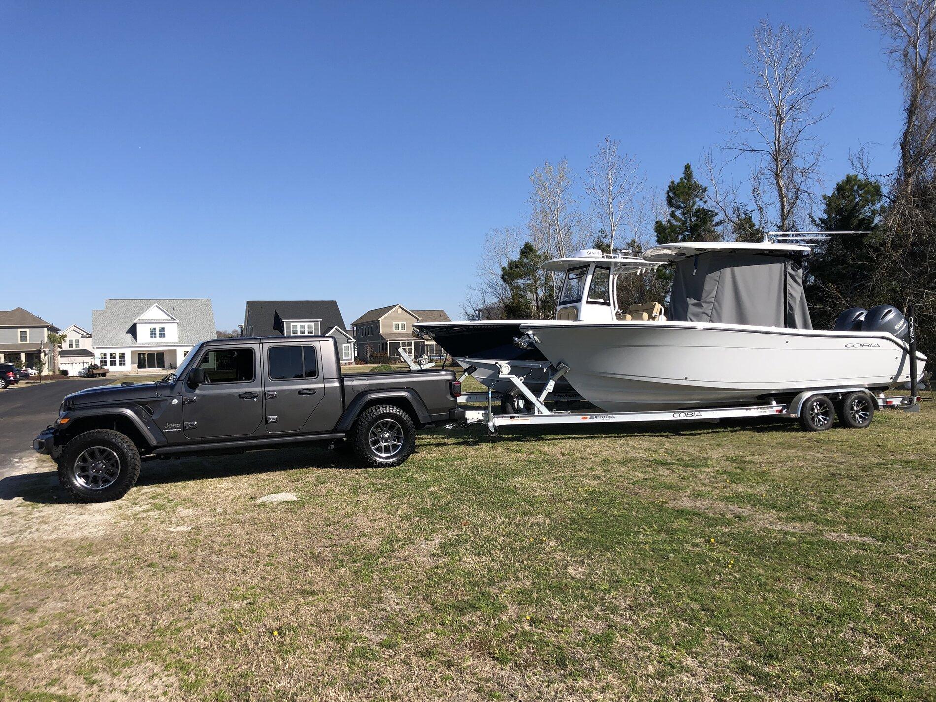

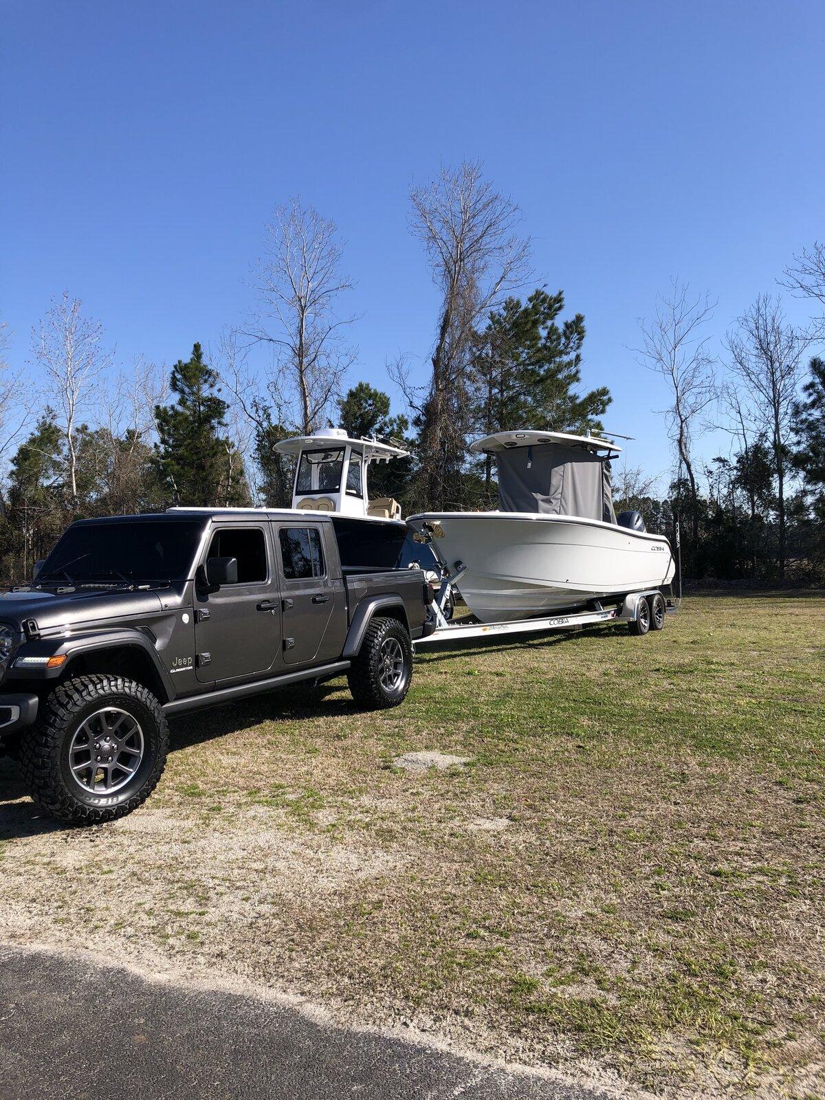

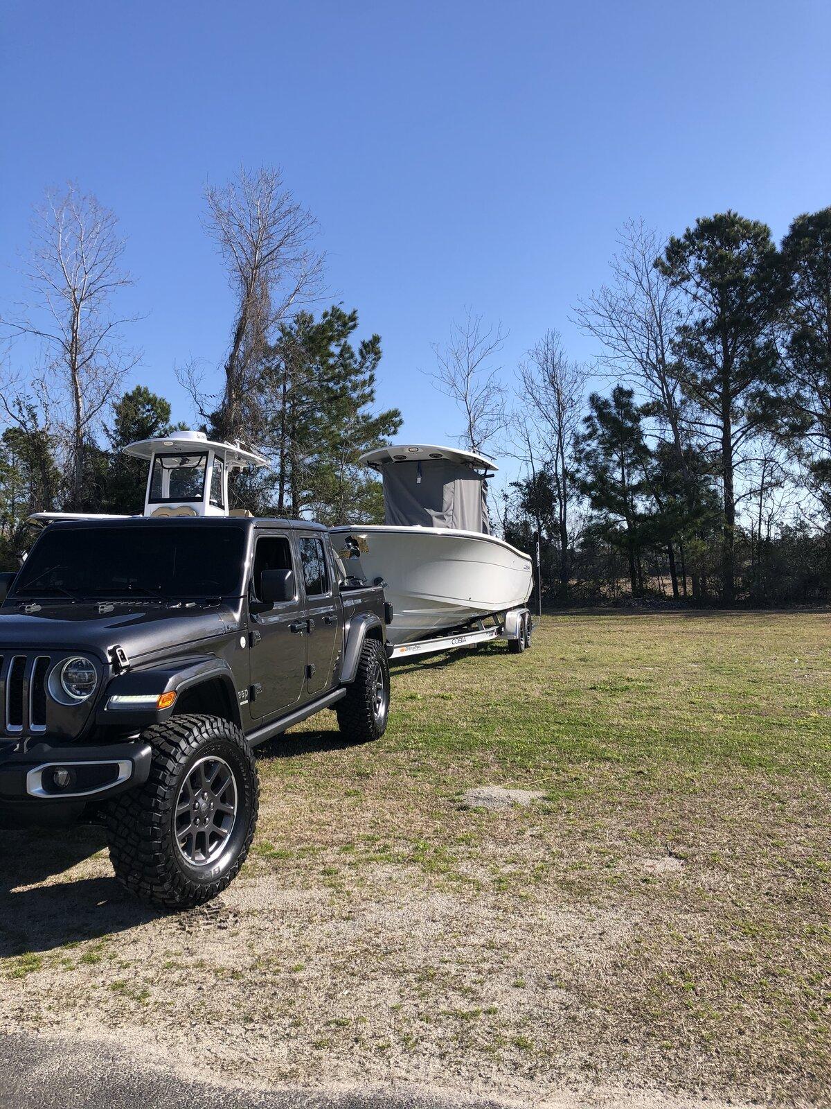

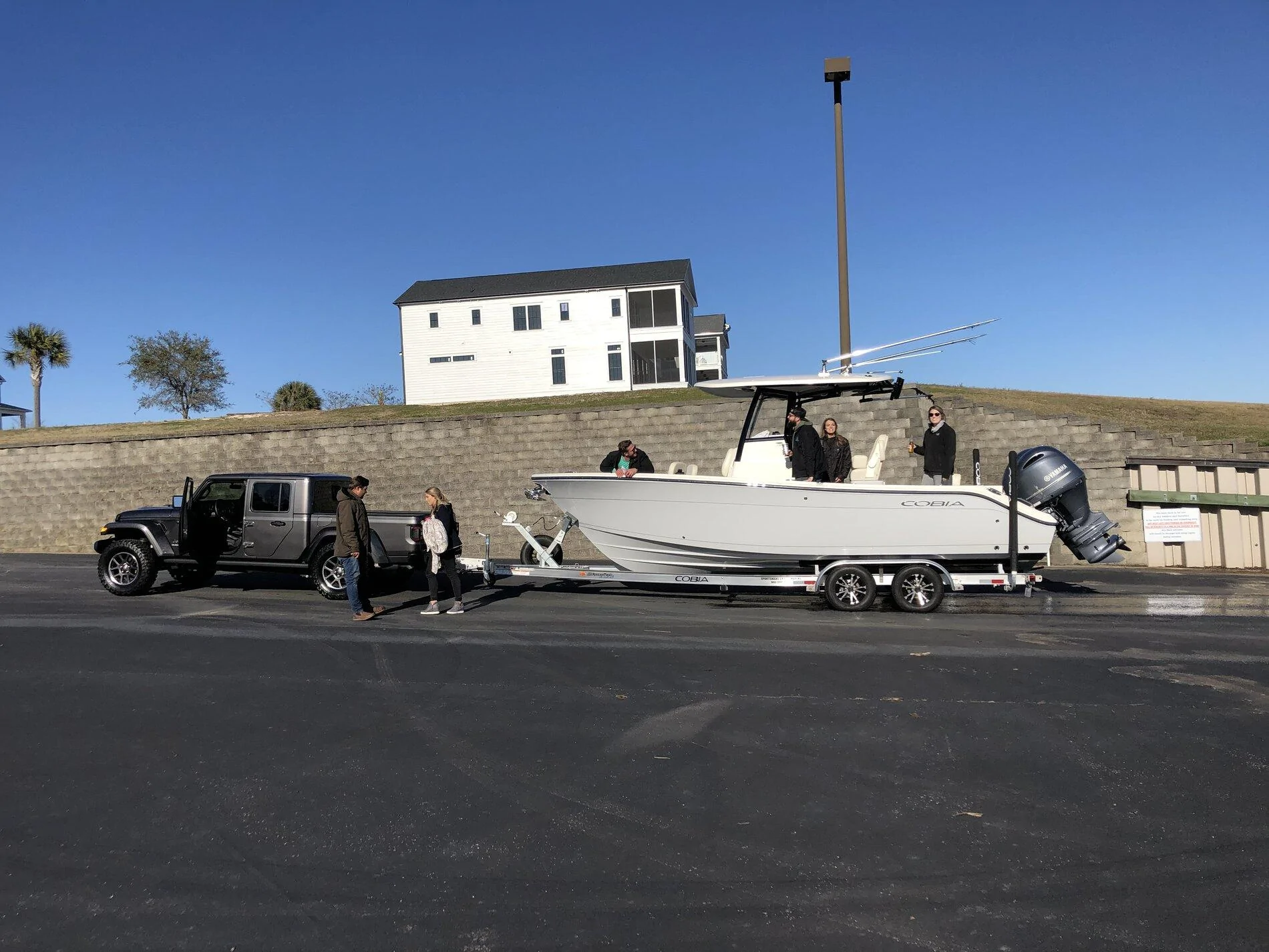

Just wanted to share my findings while towing the absolute limit with 35s.
For research purposes, and a good laugh, I decided to pull my brothers 24ft Cobia with my Overland. The boat itself of about 4500lbs, trailer 1000lbs, gear and people about 1000lbs or more, total about 6500lbs.
Only towed about 10 minutes up the road but the gladiator did surprisingly well. Unloaded and loaded with ease. I was quite shocked with how easy it was pulling it out of the landing in 2wd, the rpms never went over 3500.
I would definitely recommend some heavy duty shocks though..

Curious what speed you were up to as well as what is the highest gear you were in.
Thanks in advance

Is that with the stock 3.73’s?
Also, do you have spacers on those wheels?
Thanks in advance
About 45mph and if I remember correctly it wouldn’t shift out of 4th

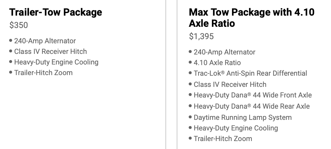

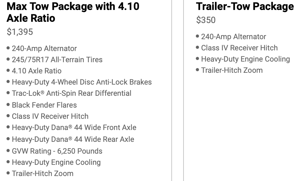

I've been trying to understand what a Max Tow package provides you over what you can get with just the standard trailer-tow package.
What is the real difference between Sport S? It seems like you have the heavier axles, similar to the heavy axles on the Rubicon, but is a trac-loc, not a locker, along with the 4.10 axle ratio.
On the Sport? The big difference is the addition of the heavy-duty 4-wheel disk brakes. So it appears that if you get the Sport S, you are already getting the heavy-duty 4-wheel disk brakes.

Higher tow rating, 7650 vs 6000. Wider axles to handle the weight. Better disk brakes. Progressive rear shocks that are firmer.
