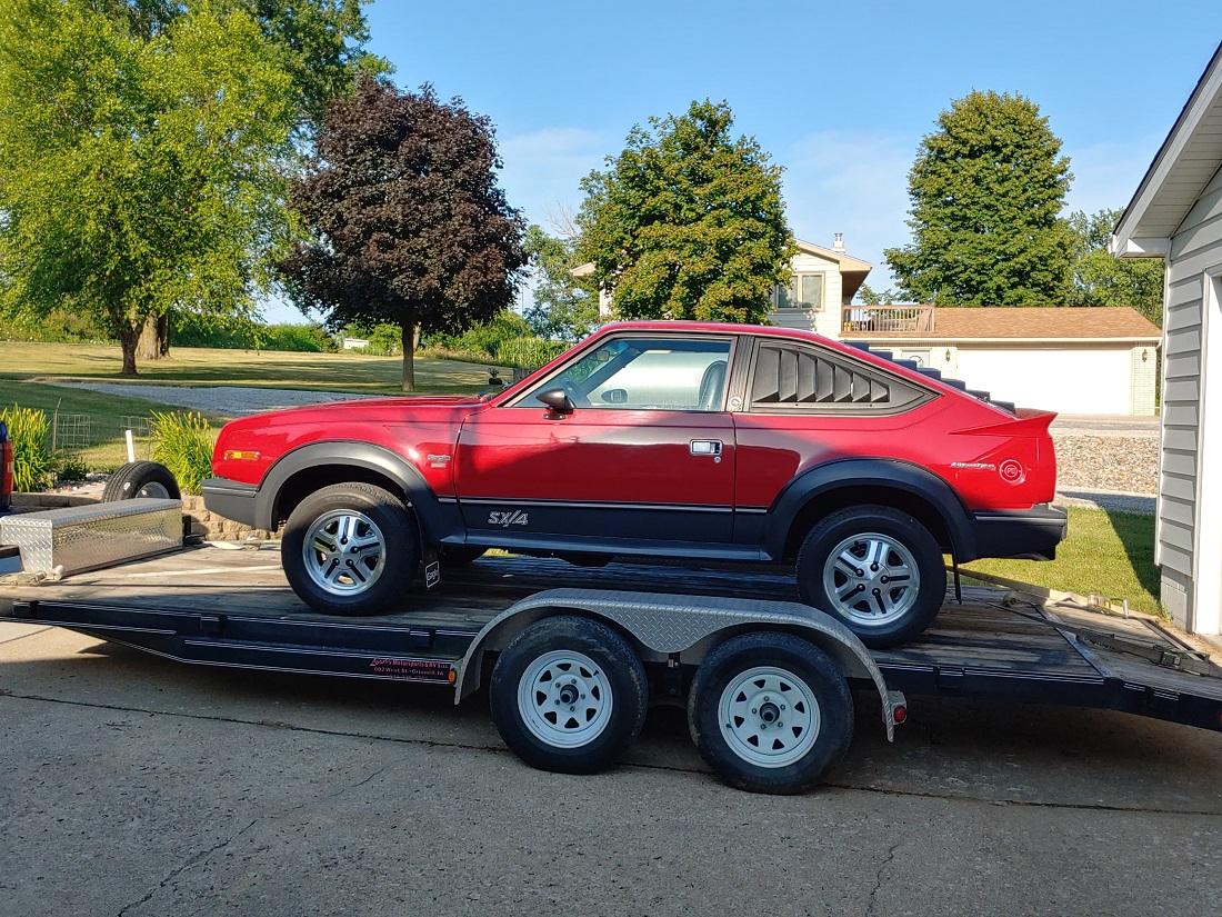

I used to haul tractors and antique engines for shows before hauling cars on trailers.
This is a 3200 pound car.
It's actually about 6" further forward than I normally load this car, I could have it a bit further back but very much further back and it didn't tow as well. It was sort of "flighty" and not as stable.
You can tell where the transfer case is by the skid plate hanging down about the position of the trailer's front axle. Then there's the transmission, engine and front differential all up there. .

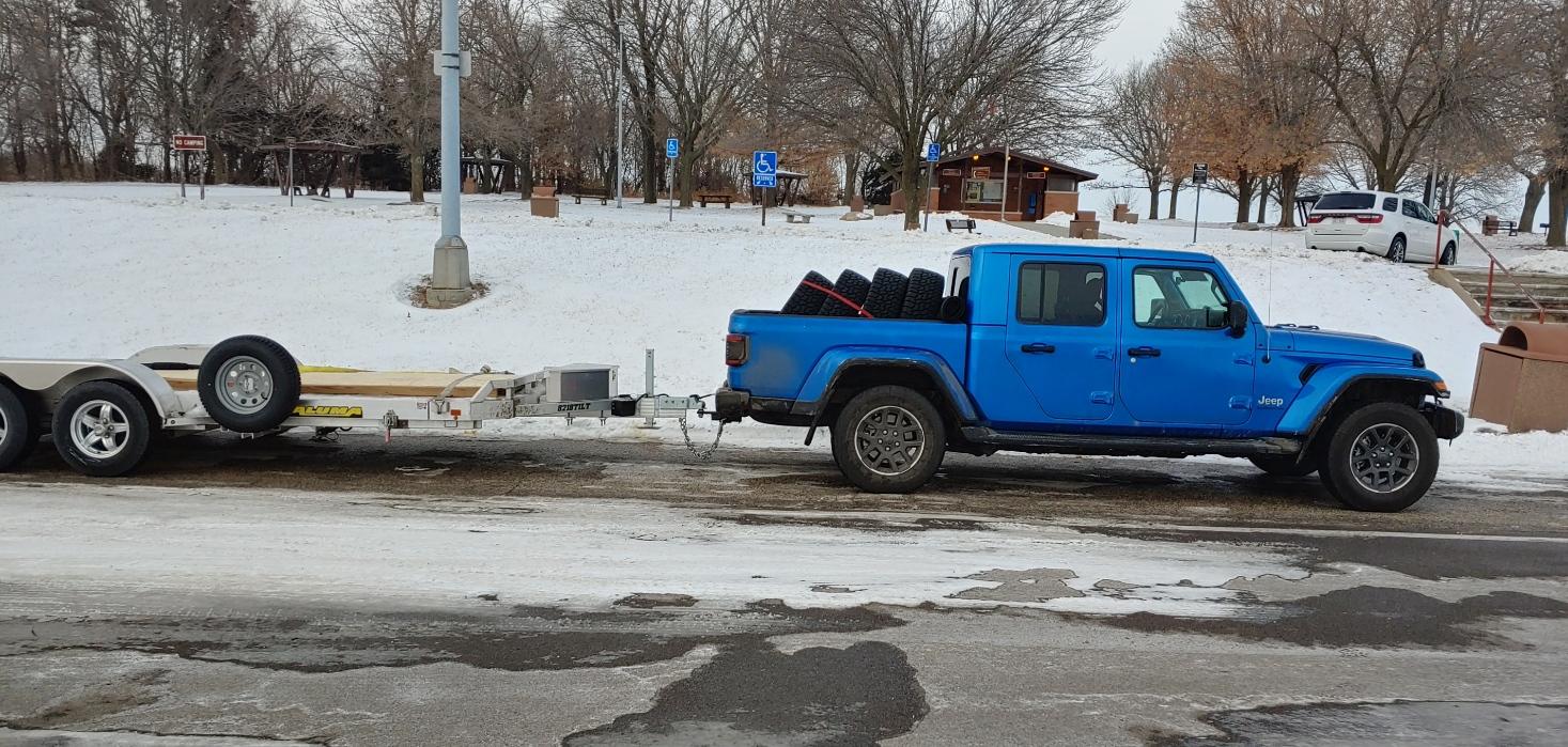

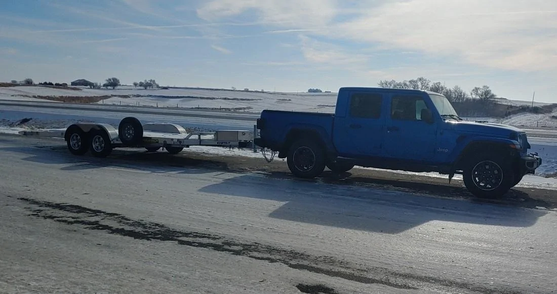

Due to the limited towing ability of the JT Overland (6,000 pounds) and limited payload, I have traded this PJ in for an Aluma. The new trailer is a tilt-bed and weighs only about 1600 with spare tire and tool box.
So I figure 1600+3200=4800 - I should be ok but I am concerned about POWER with the gearing the Overland has.
This PJ was about 2200 and I'd have been too close for comfort by the time I added any parts in the back of the truck (swap meet sales or purchases)
When my wife talked me out of the Sport S max tow and into the Overland, I explained the limited towing and did the math for her - her solution was to go buy a lighter trailer.

A good car hauler just doesn't have a lot of room to set the car back far on the bed of the trailer. There's not a lot of bed behind those axles so engine will be up ahead of the axles, transmission about over the front axle, depending on car, etc.

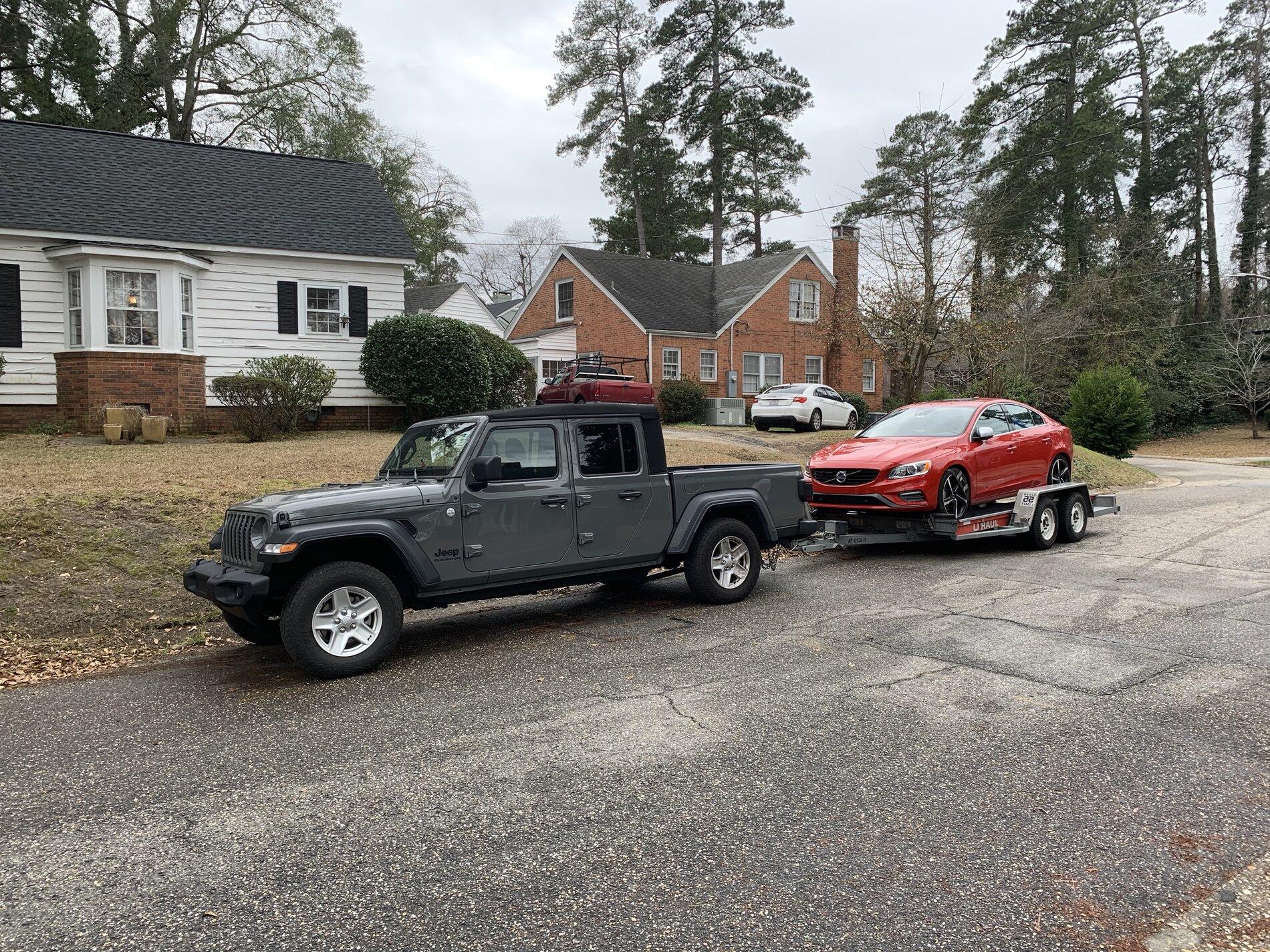

The set up I towed below was 6022lbs acording to the published curb weights. 3812 for the car. Your percentages are still higher at 5500. Like SP said you Are still way closer to your maximum percentage wise, so set up will be key to safe handling

I loved it when my wife said "go buy a lighter trailer". She also knew that I had trouble with the heave channel iron ramps my PJ had - almost took 2 guys to move one ramp - or a guy with a good back!
With a fully-aluminum trailer (except the wheels and axles), it cut about 600 pounds off trailer weight alone. My new one weighs 1500 curb weight. I figured a spare and a tool box I can carry with one hand and a few tools in it like a bottle jack and a hammer and chain and bolts, I'd add 100 to that 1500. And - no more ramps!
A couple of friends have identical trailers - the one in NY said slowly drive the car onto the trailer until the bed starts to tip back down, hold the brakes/hold the car there and wait - that's where you strap the car once the bed settles down.

As far forward as a 911 will sit on there forward make sure it’s got a full and and a spare and you mi be in a really good spot. Balance wise. That’s a guess but that Volvo’s motor was basically over the tongue so forward I bet your motor will be abou to the back axle of the trailer forward. Depending on the year. Plus if you back it on you will have to climb out of the window.
