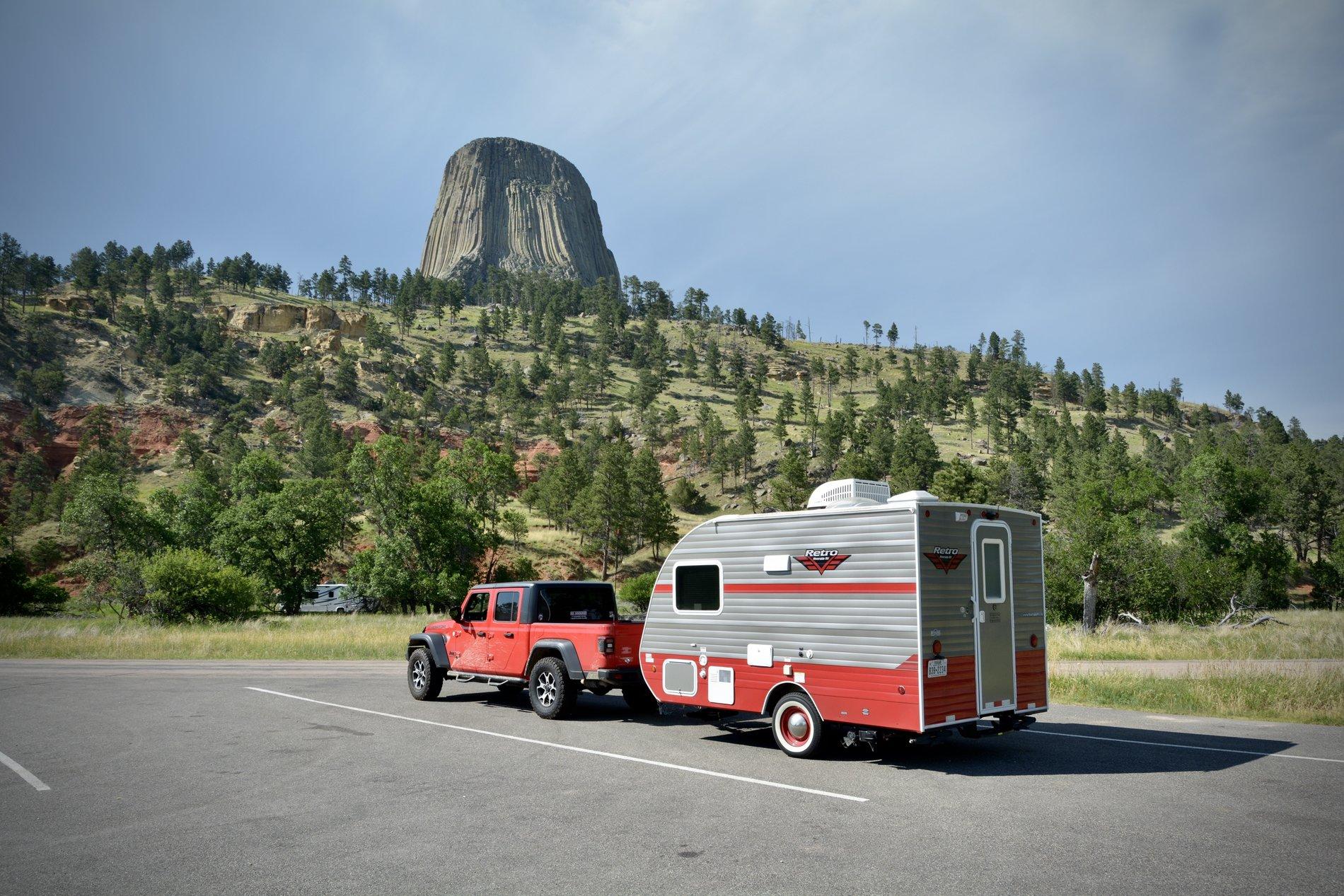

I've towed my single-axle Retro R135 literally thousands of miles without a single problem (see what I did there?). I have a Sport with the tow package (not the MaxTow). Get out there and enjoy yourself.
Jeep Gladiator Towing a T@B 400 Nucamp Teardrop Trailer (Single Axle) MVF_3878
