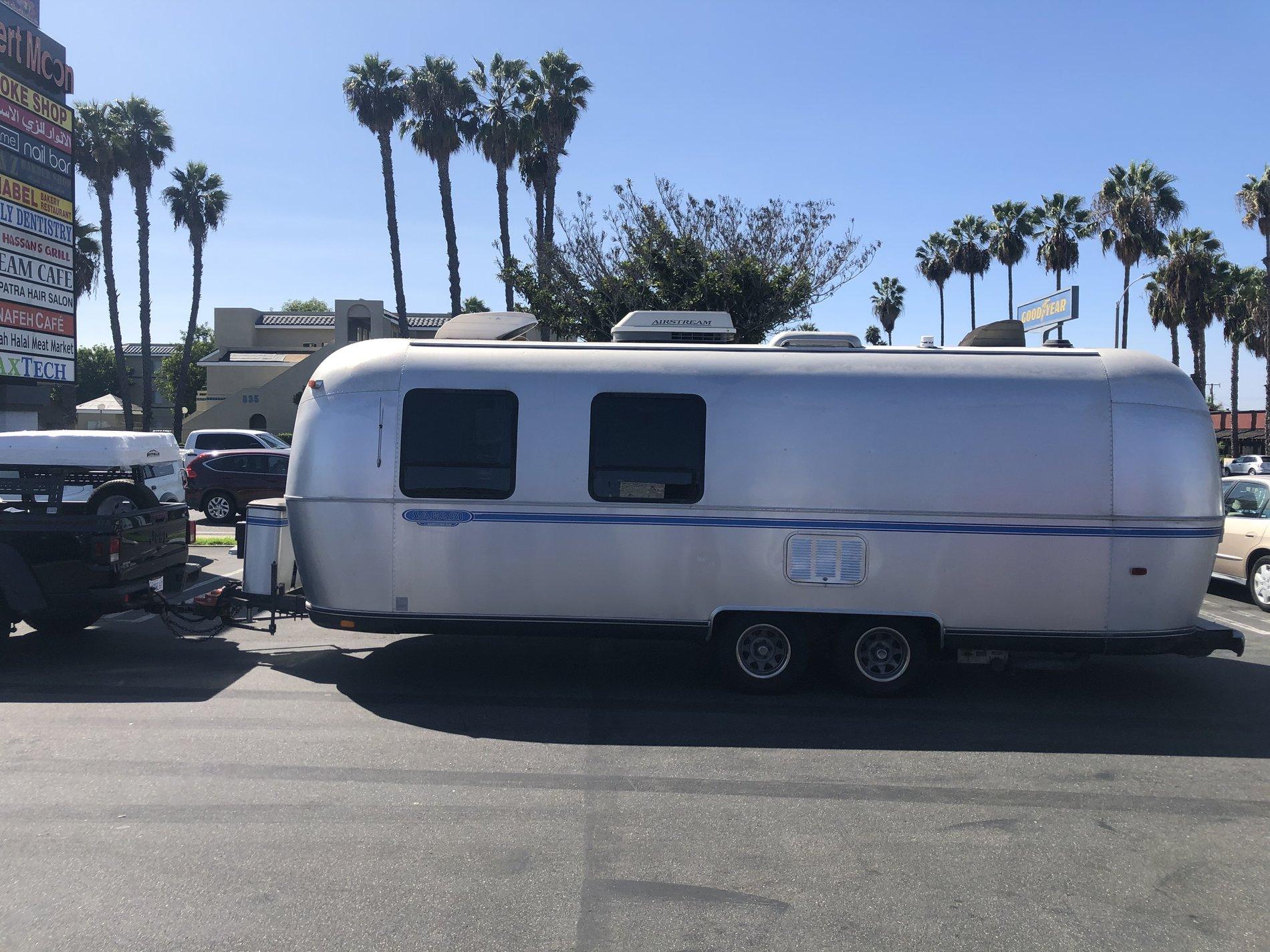

Hi All,
Newbie tower here, I found our dream airstream and bought it last week , towed to our home wout brake controller (I know it is dangerous , It was in shipment)
My hitch is a little weird it is an hensley hitch which has a fixed receiver that you cant adjust height, I have one straight hitch and one 4 inc drop, I put straight one and the trailer looked ok I took some pictures in a flat parking lot . When I was driving back to home I felt some sway in freeway , I checked one of the reasons is inadequate tongue weight. Rechecked the pictures it seems the nose of the trailer is a little up , I will do a tongue weight check but wanted to get your opinions
a) does this look straight?
b) what happens if I Install drop hitch ? I expect it to increase tongue weight (maybe I am very wrong about this assumption)
I have stock everything on sport s max tow with a bed rack and a RTT probably 250 lbs total
Here are the pictures

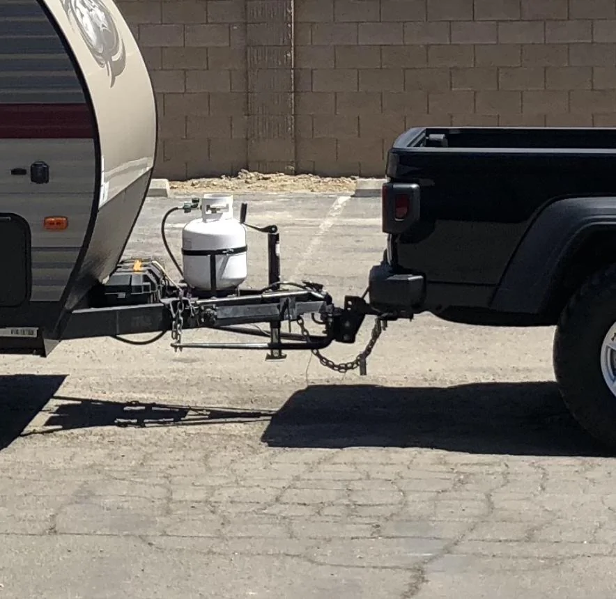

My weight distribution hitch has a anti sway brake bar that I crank down snug to mitigate cross wind shear. I also move cargo weight around so that both your truck and trailer are level. If you are tongue high pack more heavy stuff in the front of your trailer. We’ve towed our similar weight trailer with our gladiator for over 10,000 miles now and it is as good as pulling it with a full size but needs to be perfectly level. Also watch the cargo In The truck bed as that and the tongue weight can cause it to be sloppy. Good luck and happy adventures!

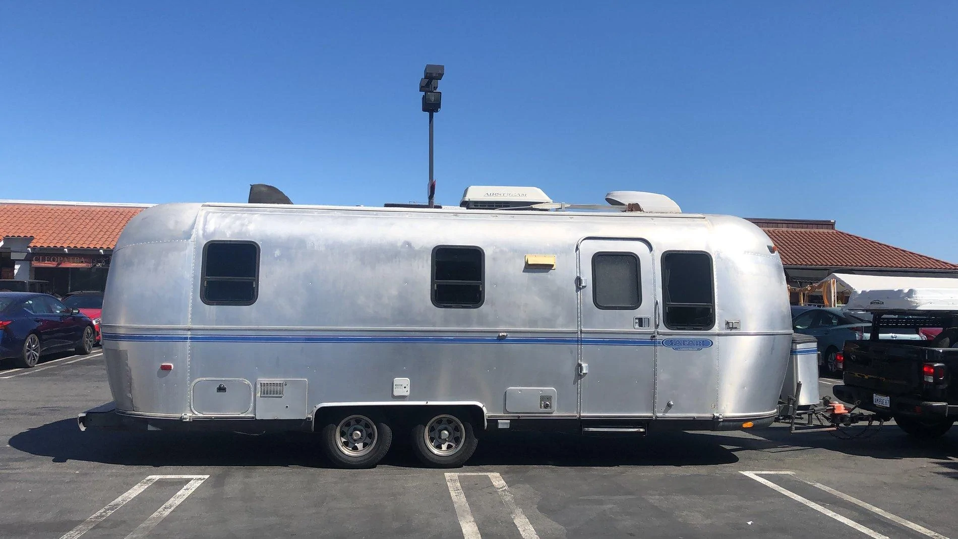

I weighed my hitch weight and adjusted load to as near 10% of trailer weight as possible on the hitch and adjusted hitch height to level the trailer. Added load leveling hitch and sway control and never had a problem towing max load.

One thing I may have gotten from your first post is that you were looking at how level it was to deterine if the tongue weight was good, etc.
That has nothing to do with it. You can tow level and have either not near enough tongue weight or too much tongue weight. So you adjust the height of your hitch to tow level AFTER you have the tongue weight correct.
You said you expected dropping the hitch to increase tongue weight - only in very extreme situations, not for towing like this. The weight would have to sit very high to have much impact on tongue weight by lowering the hitch.
Adjust weight, then make it tow level - level equalizes the load on the trailer axles. Low in the front puts weight on the front trailer axle, takes it off the rear. High in the front puts the weight on the rear trailer axle.

Thank you !! this was exactly what I was asking. I am refurbishing interior now, so I think I will have more weight after its done, I might install additional batteries which weights 50 lbs at least so I will balance it before towing
