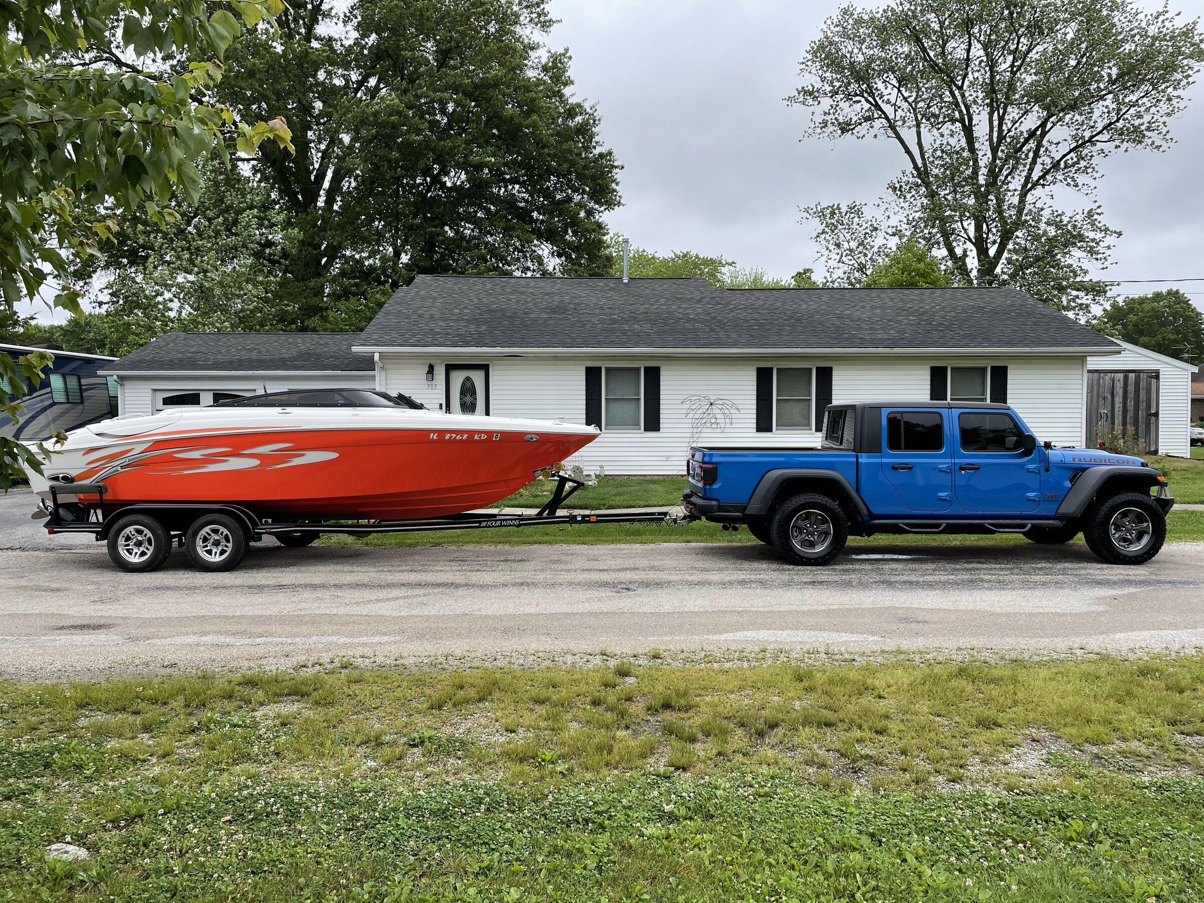

Here’s my 22 ft ski boat with my rubicon, before I added the airlift bags. Haven’t hooked up boat since the air bag install. It didn’t sag to bad without the airbags.
Jeep Gladiator towing boat AE43C9E1-9108-46A8-A6CE-F7CFF8720695
Thanks mike. Nice boat! I’m looking at getting a 23ft tidewater. What size tires are you running? I think I don’t have as much clearance on the back as you do.

In the pic, I’m running the factory rubicon 285. I now have 37/13.50s with a three inch lift and airbags in the back. We love the boat. Bought it new in 08. Cost more than my rubicon way back then.

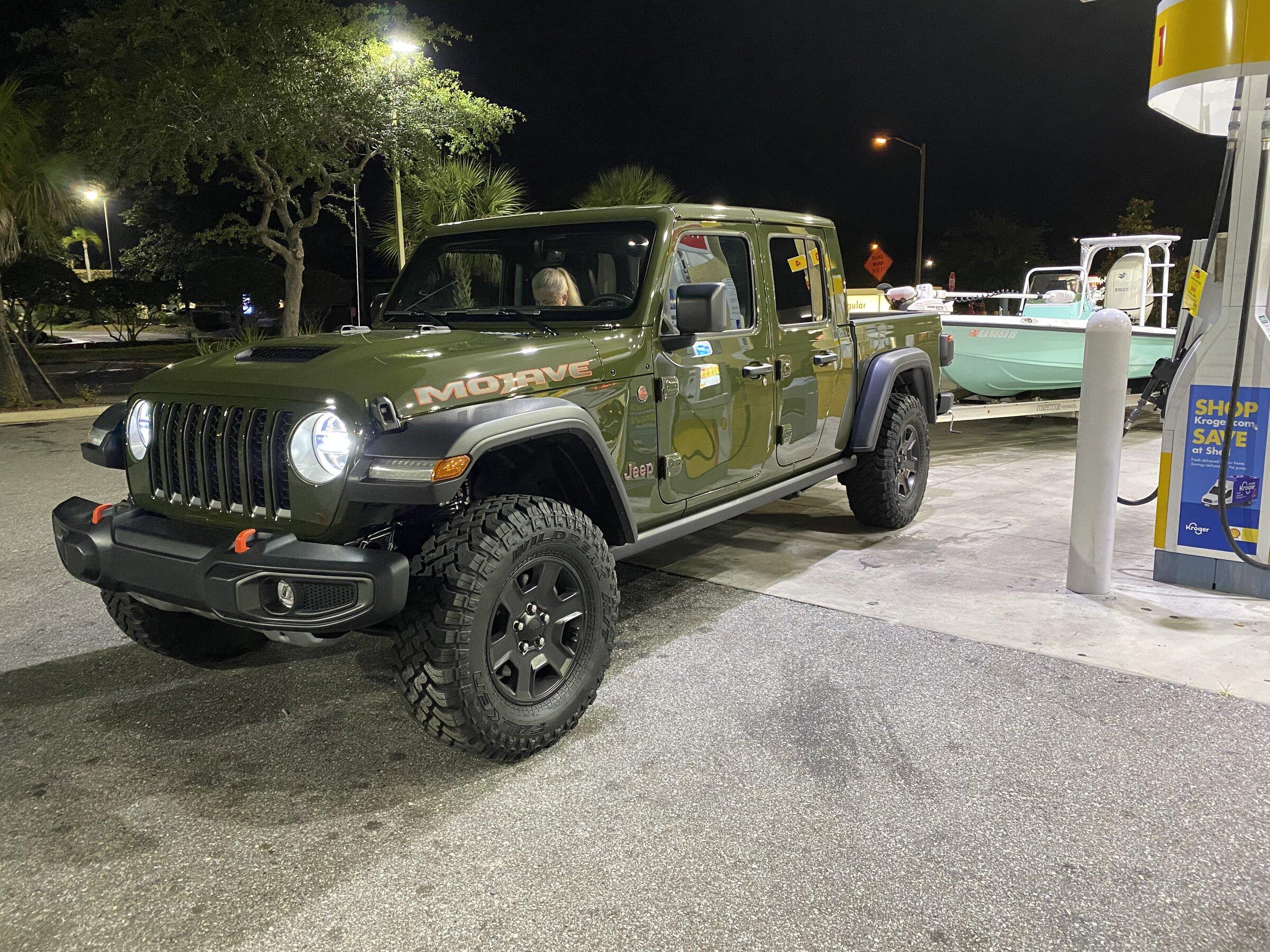

Just finished my first toe, 3200 lb flats boat. 18.5 ft, 150 Suzuki outboard. No sagging at all on my Mojave. How much does your boat weigh?
Jeep Gladiator towing boat CF990206-AF62-4EE9-9CCF-51D70DF0800D
It’s going to be right at 5000
