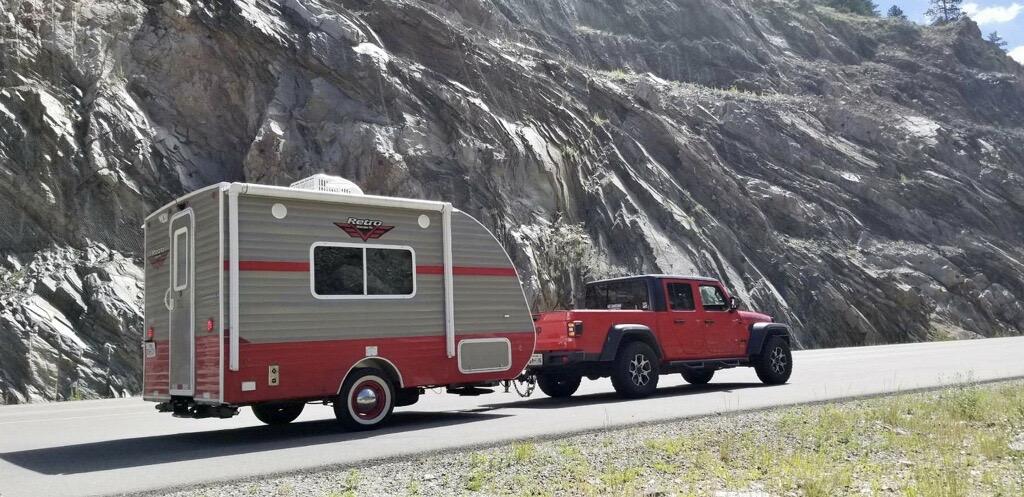

I have the Sport with the tow package -- NOT the MaxTow package. My rig tows my 3,500# trailer easily. I use the Curt Echo bluetooth brake controller.
Jeep Gladiator Towing Camper without Max Tow IMG_1447
