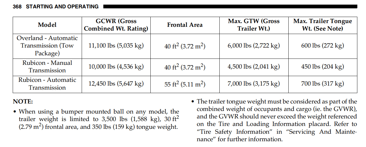

Where does it state the maximum towing capacity of the Jeep?
Advertising materials and my dealer said the Rubicon Automatic with Trailer-Tow package can handle 7K lb. I can’t find that anywhere in the manual or the tire-load info. Anyone know how I can confirm or deny the 7K number?
