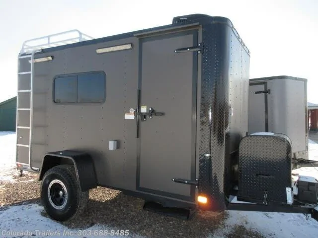

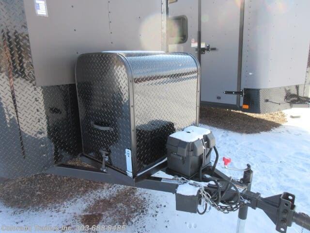

I will check in the morning on brake type but here is a pic of the rig and the tongue. Electric brakes?

Those are electric brakes. The little battery box that activates the brakes during a breakaway is the clue.

And I might add that’s a sweet little trailer. Who is the dealer?
Colorado Trailers. Check them out. At ColoradotrailersInc.com. They have some cool setups. Pricing is ok but they had the configuration and options I was lookin for.
