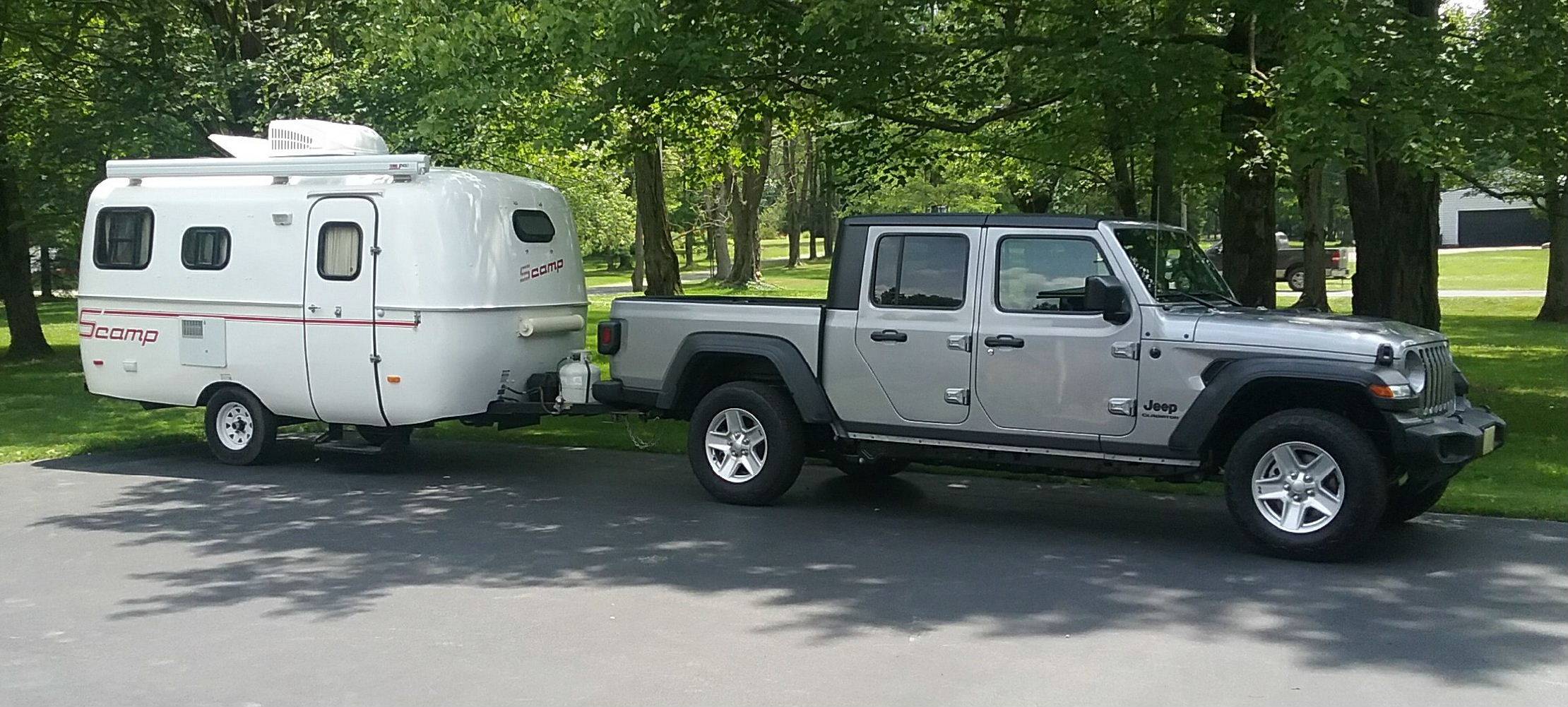

I've been towing a Scamp 16' fiberglass trailer for years with both my Gladiator I got in June 2019 as well as two Tacoma's before that. It has a tongue weight of 249# and camper weight is 2200#. I have never used a WDH just hook & go. Talk to people that have them and see what they say.
I did put Suma Springs on it. Link https://www.sdtrucksprings.com/index.php?main_page=product_info&products_id=59384

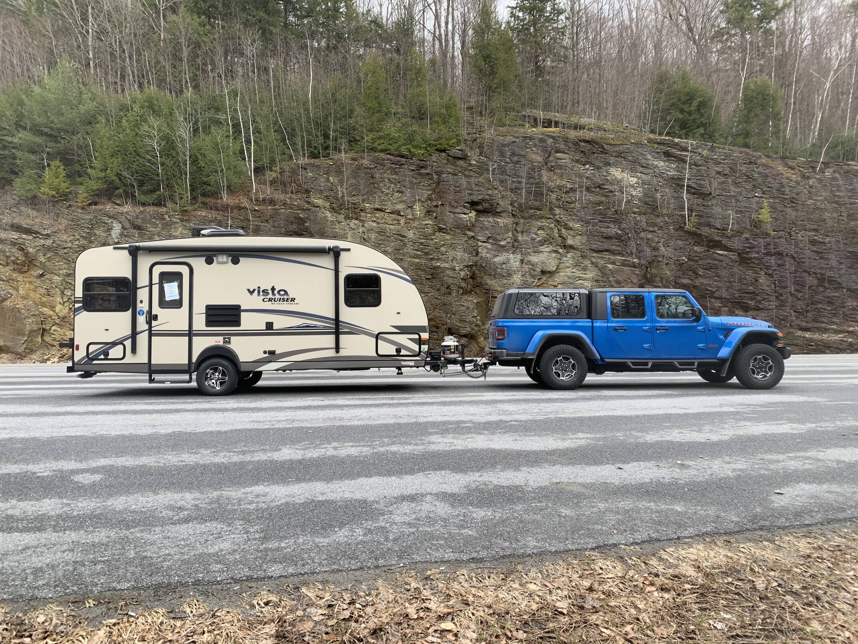

Ours.
Jeep Gladiator Towing RV with my 22 Sport ? IMG_0983
