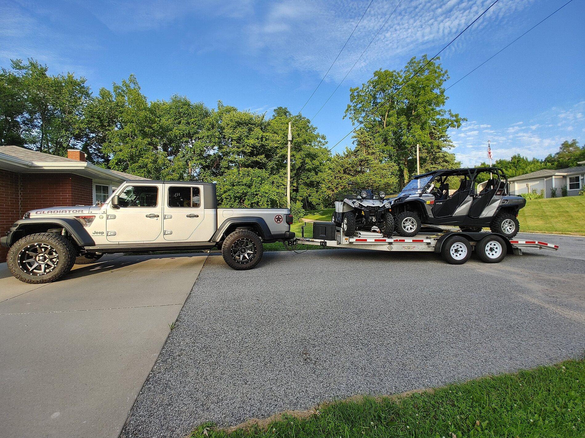

If your running stock I think 70 would be a decent ride with the tires aired and aligned properly. I am supercharged with a lift and 35s and a good trailer brake, and I pull at 70.

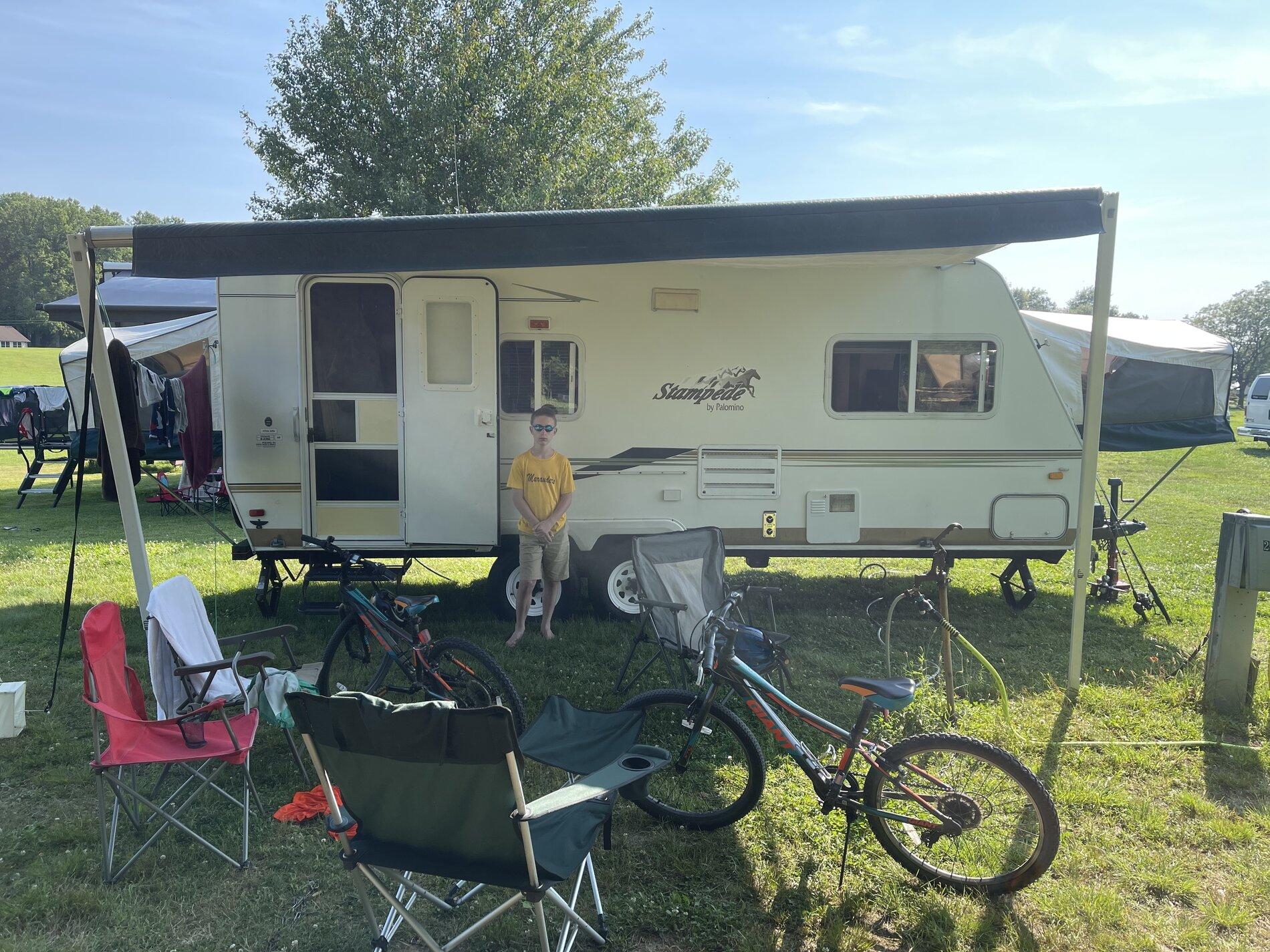

What ever you're comfy at. Me, I'm comfortable at 65 mph max in my Overland (stock with tow package) towing my 27' overall TT. I also shift manually. 7th and 8th on flat or slight downgrade is around 2,000 rpm. Lower than 58 mph, 6th at around 2,500 rpm is perfect until I'm back to between 60 and 65 when I can go back to 7th (which is pretty much where I tow anyways...8th is a rarity except for a long downgrade).
