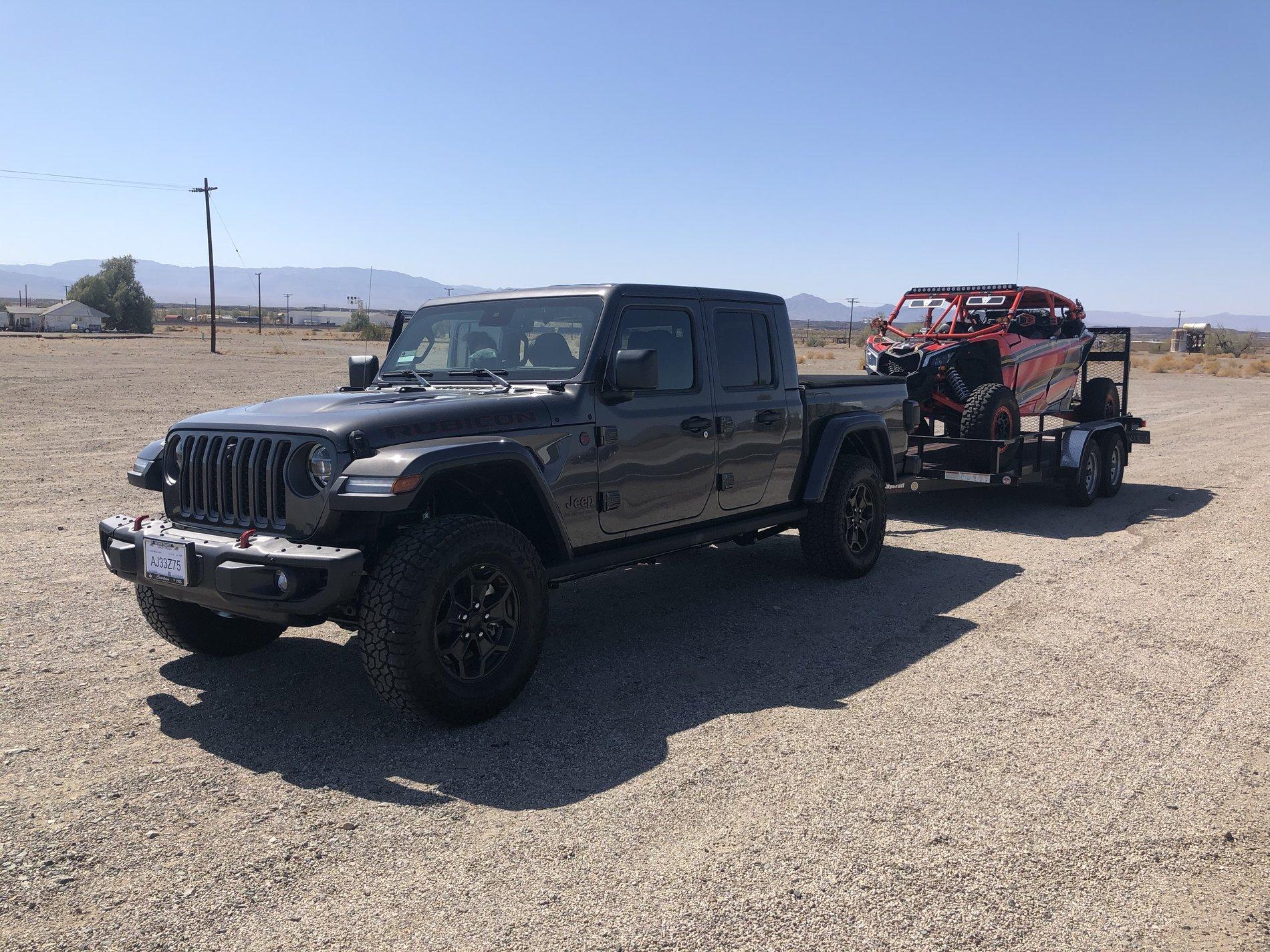

Towed my SxS this past weekend and only noticed max tranny temp hit 214. With avg of around 204. Didn’t notice any other temps.
Is that thing fun to drive around? I've never ridden in one.

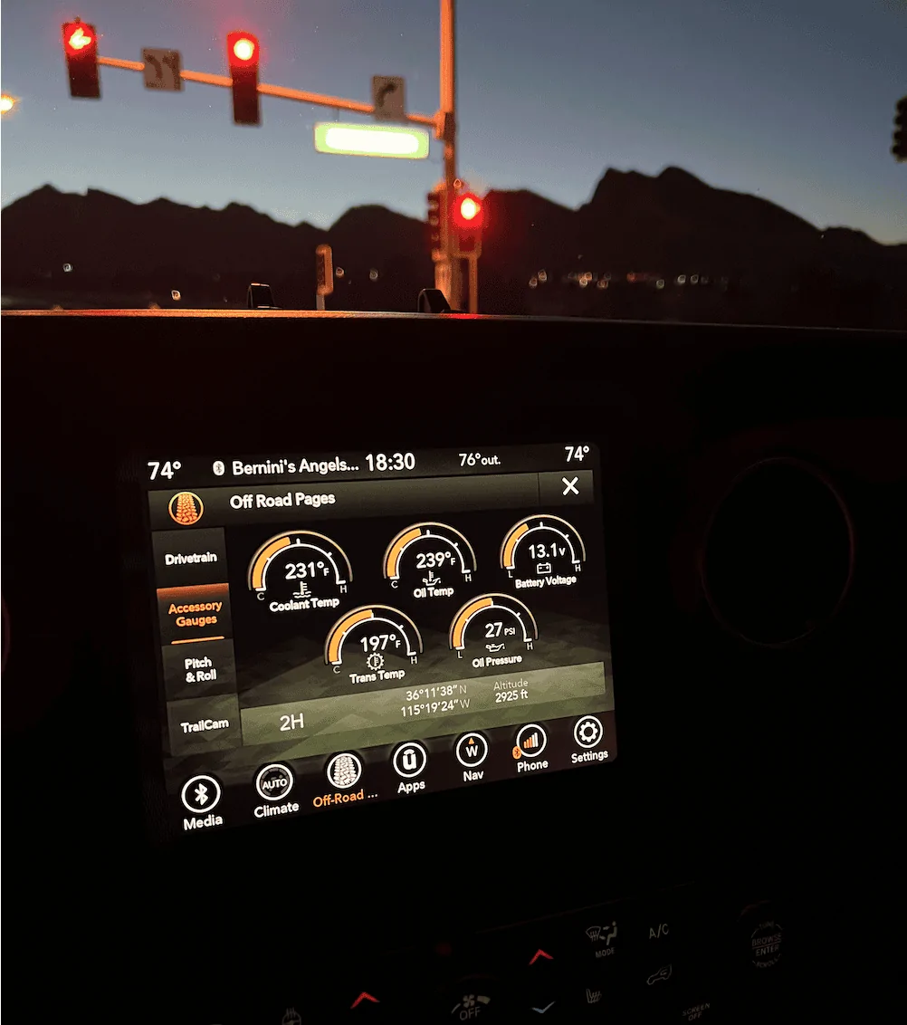

On my JLUR XR, I see oil temps 230F+ going uphill or when driving slow in my subdivision. But quickly comes down to 195-200 once I start going downhill.
This was taken in its first week when it was under 200 mile odometer going uphill on a freeway and on to the exit ramp - during the break in it does heat up but after 1500 miles or so, temps stabilize lower. (And I was not towing of course)
All normal and within spec I was told.
