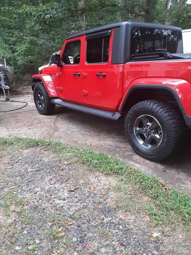

I put Rubicon takeoffs on my overland. Picked up the takeoffs TPMS sensors with no issues.
