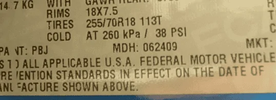

ShadowsPapa Well-Known Member First Name Bill Joined Oct 12, 2019 Threads 207 Messages 32,745 Reaction score 40,483 Location Runnells, Iowa Vehicle(s) '25 JTMX, '23 JLU 4xe, '82 SX4, '73 Javelin Occupation Retired auto mechanic, frmr gov't ntwrk security admin Vehicle Showcase 3 Jul 21, 2023 #3 GRDIESEL said: Will my ‘21 Gladiator sensors work on my dad’s ‘23 Wrangler Rubicon? Click to expand... What's the build date of your 21 Gladiator? Look on the door sticker for MDH - Month/Day/Hour Example of my 2022 - June 24th (0624 )

OP OP GRDIESEL Well-Known Member First Name Gabe Joined Apr 8, 2021 Threads 12 Messages 125 Reaction score 129 Location Michigan Vehicle(s) 2021 Sport S Diesel Build Thread Link Jul 22, 2023 Thread starter #4 Looks like it was 3-21. MDH:033003
