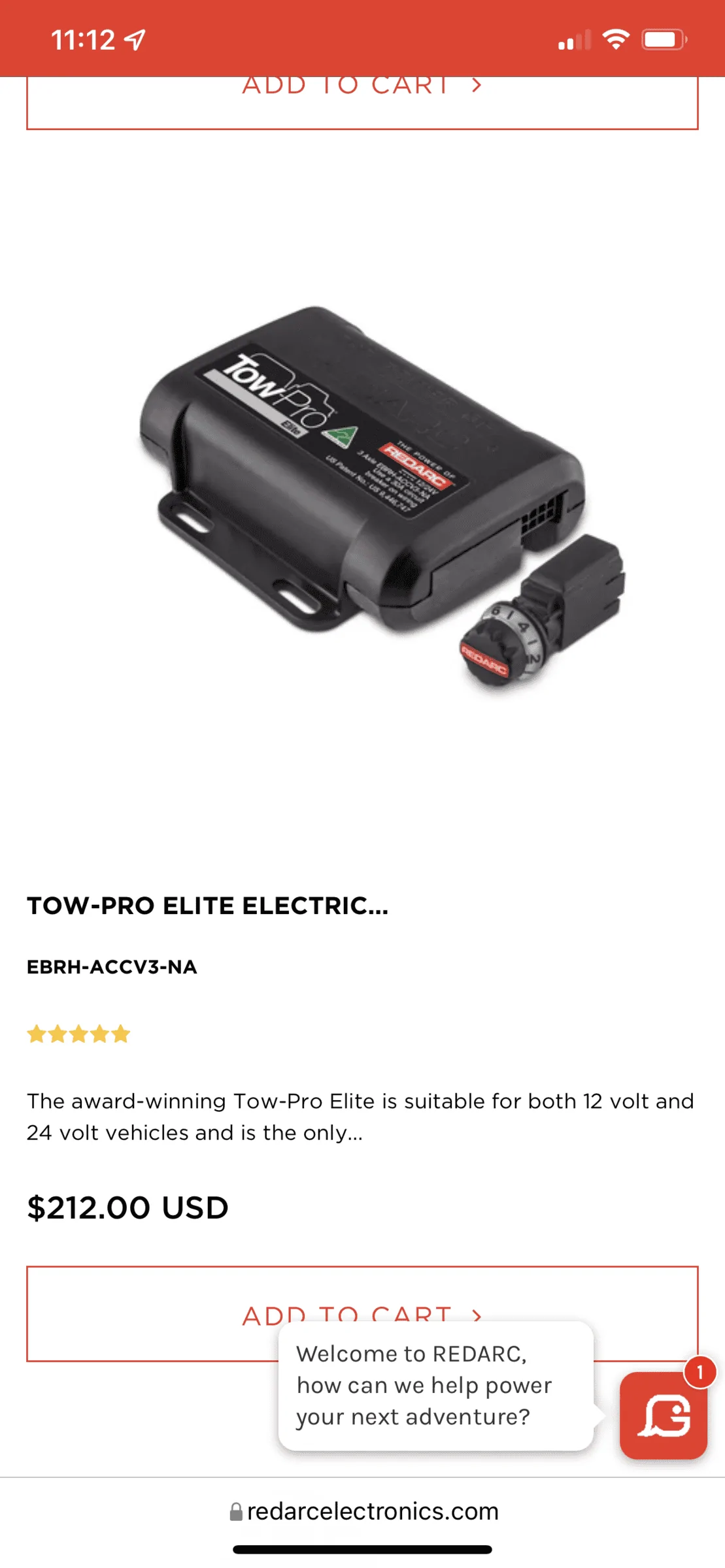

It'll work. So will any of the other third party controllers.
I like Redarc myself but anything from Redarc, Curt, or even the MOPAR unit will work fine.

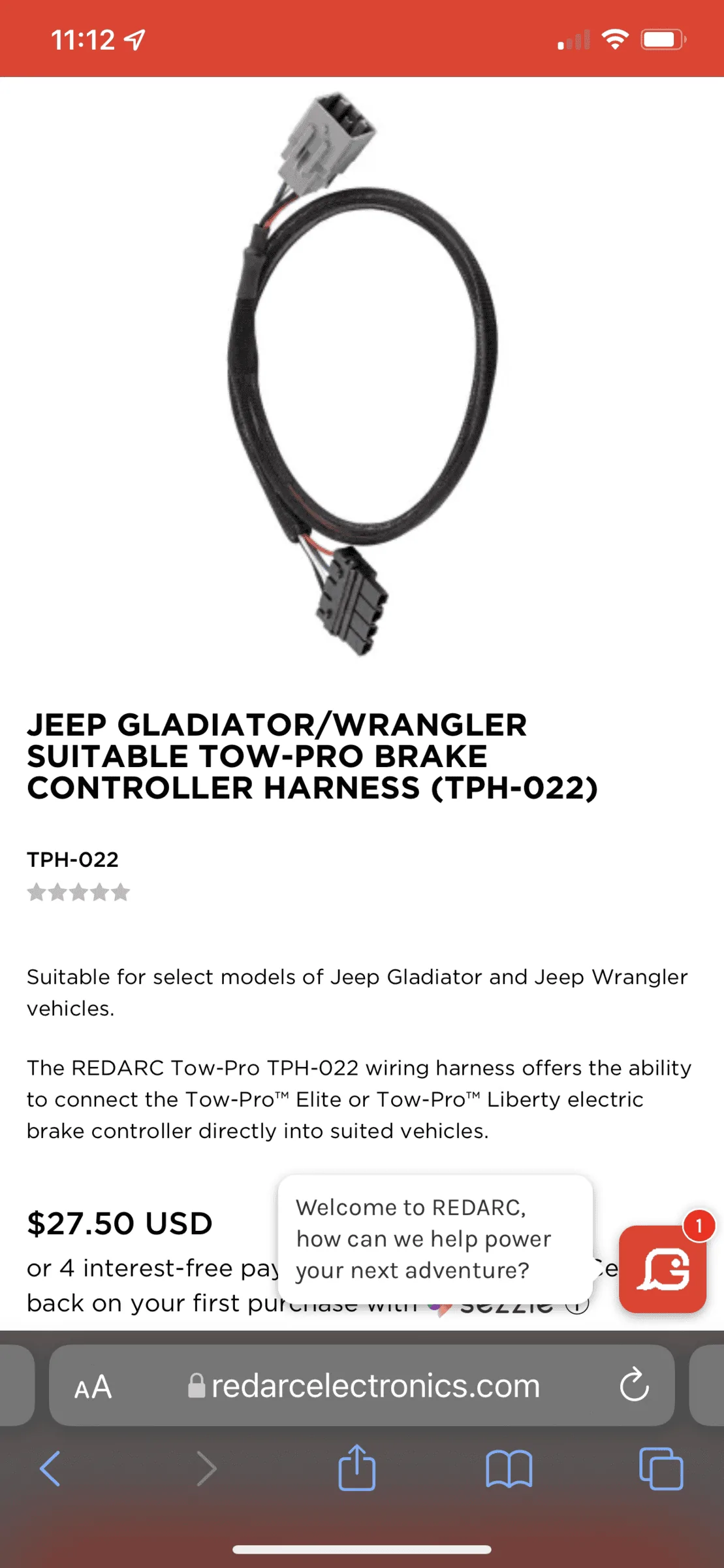

Redarc
be sure to get the correct wire loom.
