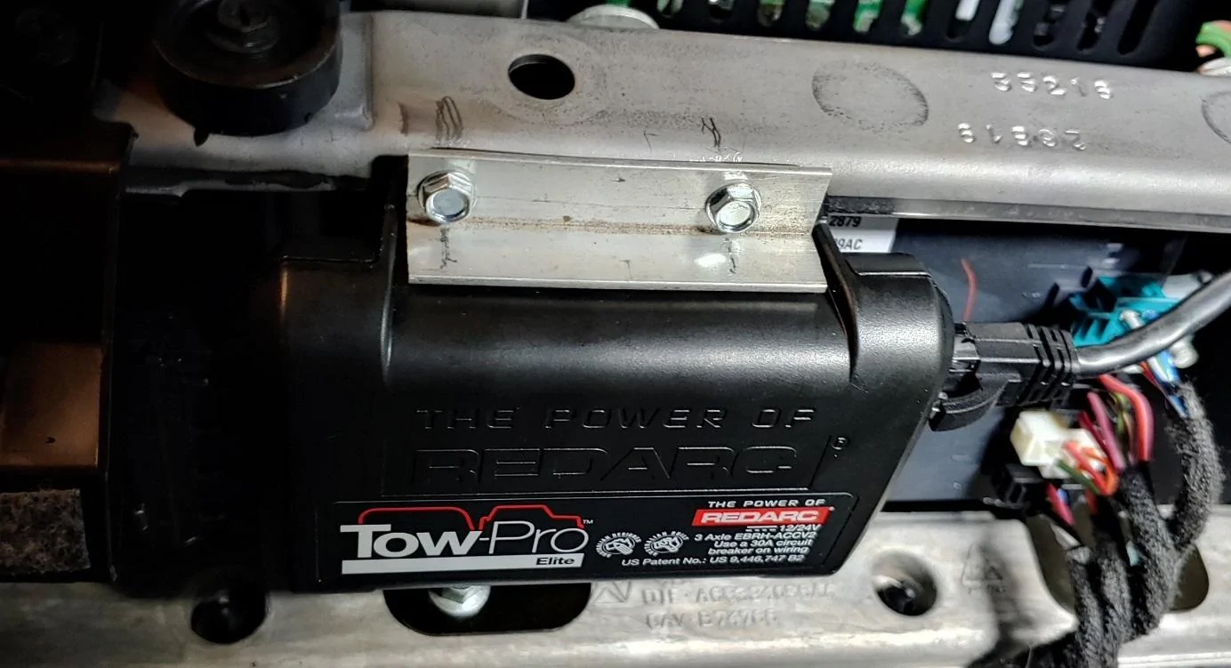

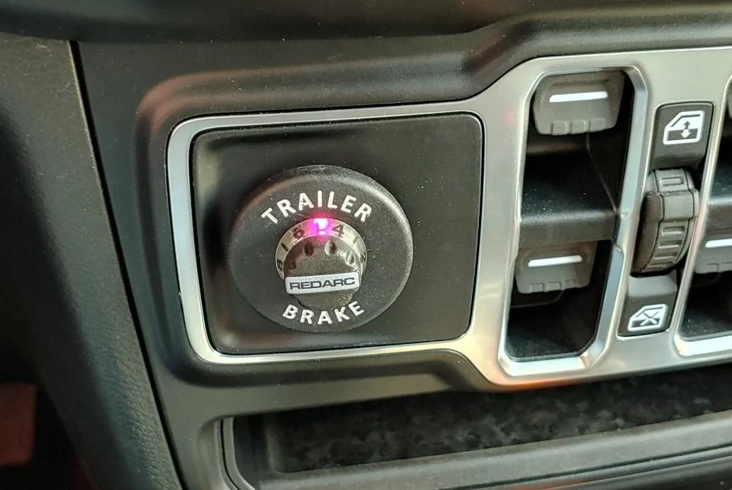

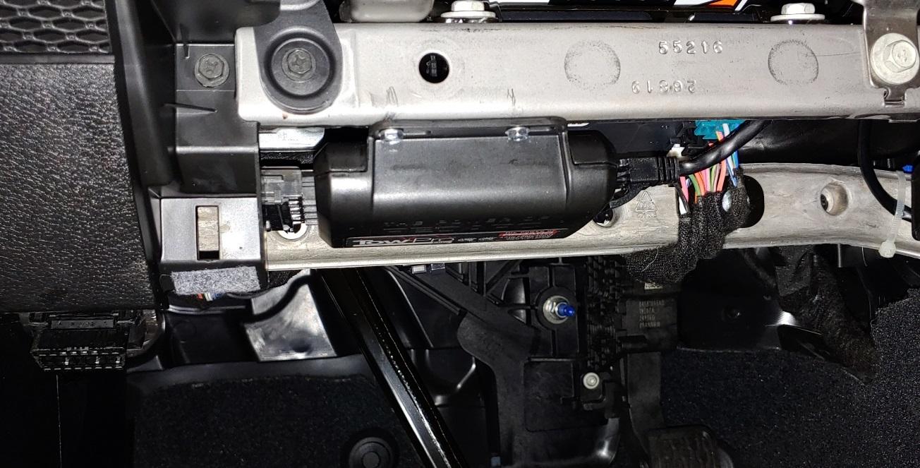

I installed the Redarc Tow Pro Elite in mine with no issues, besides having to order the correct mount where it replaces the 12 volt plug like the mopar factory one.

Jeep Gladiator Trailer Brake Controllers for the Gladiator 19-20200915_144213_HDR
Jeep Gladiator Trailer Brake Controllers for the Gladiator 13-20200915_114640_HDR
Below - initial holes and alignment - above I added a small bracket to reinforce the mounting flange and reduce vibration. No cutting of trim, no messing with any plastic panel, just drilled these two holes, that's it, the only real mod to the truck. it's up out of the way, cables easily reach fine.
