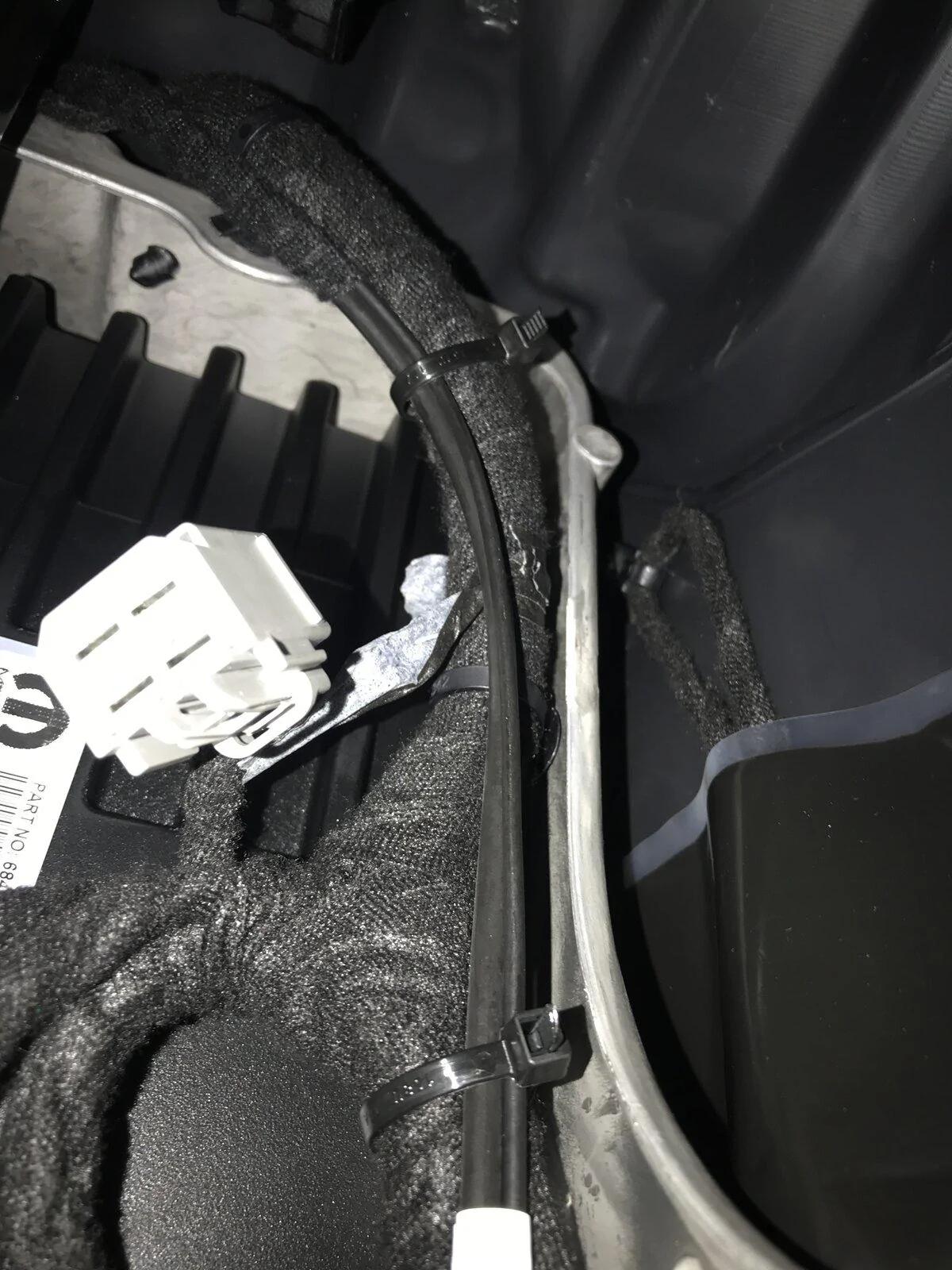

i have a 21 Overland with the tow package ... i put the Redac brake controller V3 on the JT ... the gray brake plug was VERY hard to find ... it was located nearly against the left side plastic foot panel about as high up as is possible AND wrapped to another wiring harness with electrical tape .. could not see it but could feel the plug with nothing plugged into it ... unwrapped the tape and there it was ... you can hardly get your hand where it was located

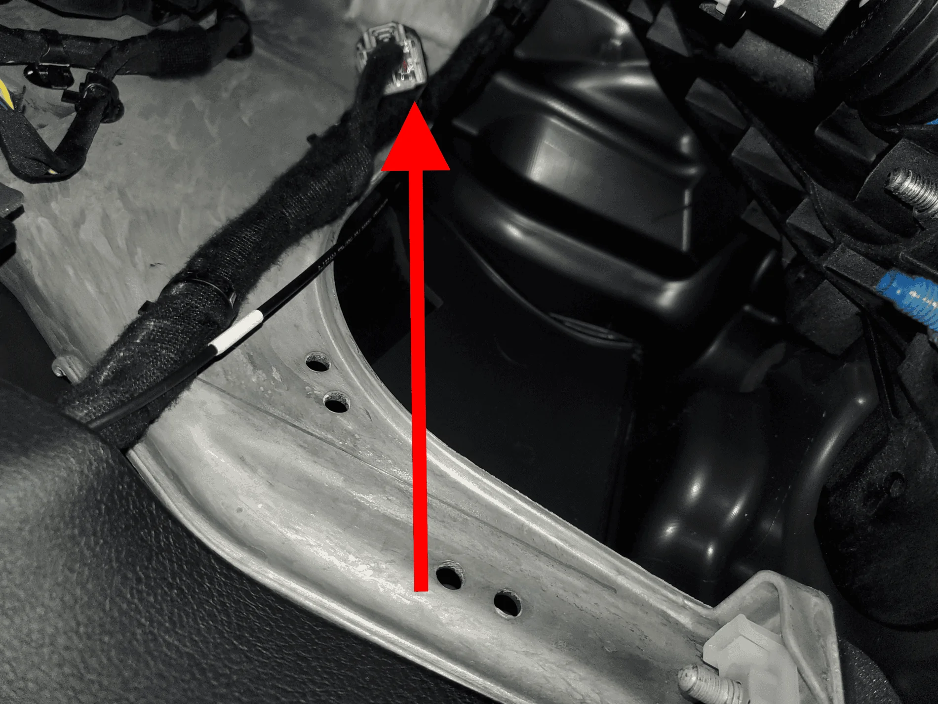

Is this it? It has a Brown, Orange , Green and Green with white strip wire colors
Jeep Gladiator Trailer Brake grey plug harness F5B87A26-599B-4750-B850-6E9C9C466A0B

Yep, if it plugs into your brake controller adapter that's it. There's nothing else up there that will.
