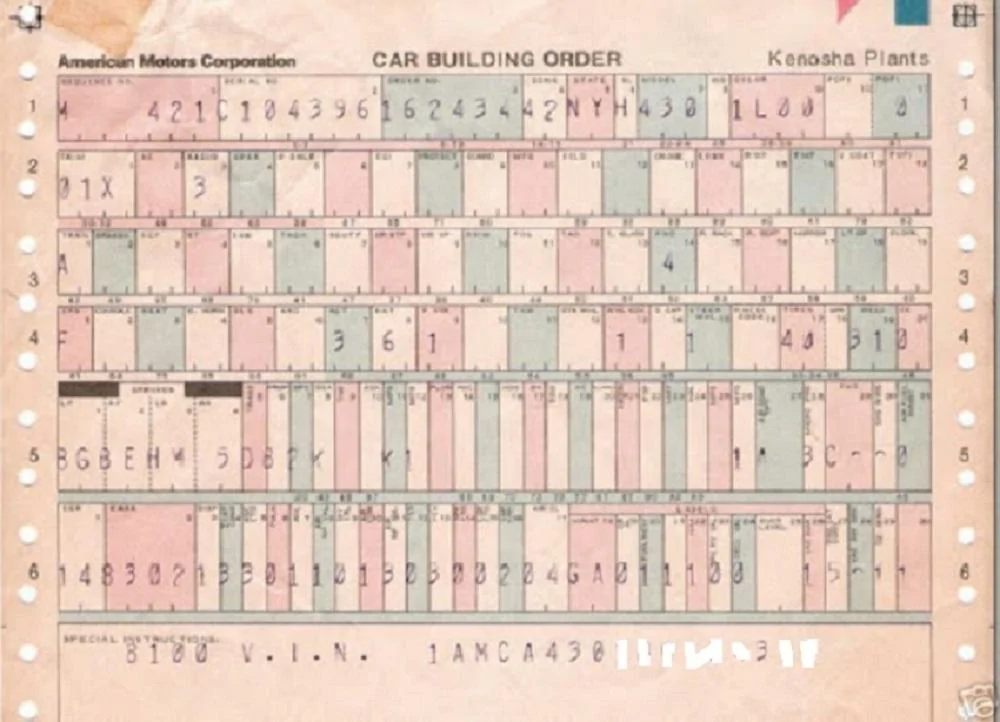

Build sheet gives a lot more detail.
You can also go online and print the window sticker - but the truck will come with one.
I ordered mine, not off the lot, so it says it was built especially for - and my name.
The PDF version you can get online doesn't have that.
The window sticker is a typical window sticker.
The build sheet is, well, a typical build sheet. Well, typical for the last couple decades I suppose.....
Go back and this was a build sheet -
