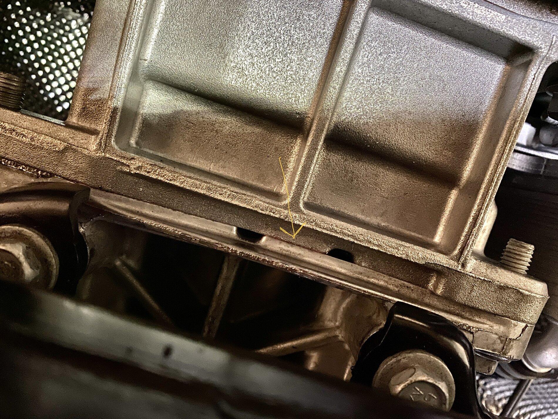

Parked in my garage after getting home from work, and noticed a small puddle under my JT. Thought it was water at first, but it was tranny fluid. Crawled under and the oil pan bolts were wet the transfer case mount was wet, and everywhere in between. Now by wet I mean it had oil on them, bolt heads were drippy. Dried everything off and it is seeping from the spacer between the tranny and transfer case, on the transfer case side.
I cleaned the whole area up and waited a while to be sure and took another look. It is slowly seeping out of the seam.
Anyone else have this issue? Wondering if I should try to tighten the bolts, even though they look factory tight.
I just dread bringing it to my dealerā€¦..they are a hack, for doing anything other than an oil change (even that they donā€™t do good).
Itā€™s hard to see in this pic, because I had wiped it off. You can just see it starting to weep in this pic.

Oil pan bolts are tight.....that is what I was hoping for.....the wind from driving got the fluid everywhere...once we let it run sitting you could see it leaking out of the seam above

man hopefully a seal to where the tranny is with the torque converter isnt leaking from there or to were the tranny mates with the T-case,cause if so.............your jeep might be in the dealer for a while man,i remember i took my jeep for the steering tsb recall it took them 3 months,but to replace my waterpump it only took them 6 days,and i was pretty impressed to say the least
also cause of that i thought my tranny oil pan and or my engine oil pan was leaking so thats were i had my whole ordeal of tightening the bolts for both pans lol

My Jeep was leaking trans fluid around 1000km. Turned out the input shaft seal was buggered. They changed the seal, pan and gasket under warranty.

Well brought my JT to the dealership yesterday. Was there about an hour and the service writer let us know that they canā€™t tell why itā€˜s leaking and that it has to go under the knife. Basically have to take the tranny and transfer case out and figure out what the cause is. At least that is what Chrysler told them to do.
Iā€™m hoping itā€™s just a bad sealā€¦..
I just hope when I get the truck back that itā€™s done nicely and not all messed up. I donā€™t have much trust with this dealership, but it would be a nice surprise if itā€™s done right.
I was told that I should know today what is wrong.
Iā€™ll update once I know what is up.

I ordered it July 31st of this year. Received it the middle of September.
I did a search and it seems it's been going on from 2018.
Usually either a bad seal that was messed up from factory or a warped transfer case.
