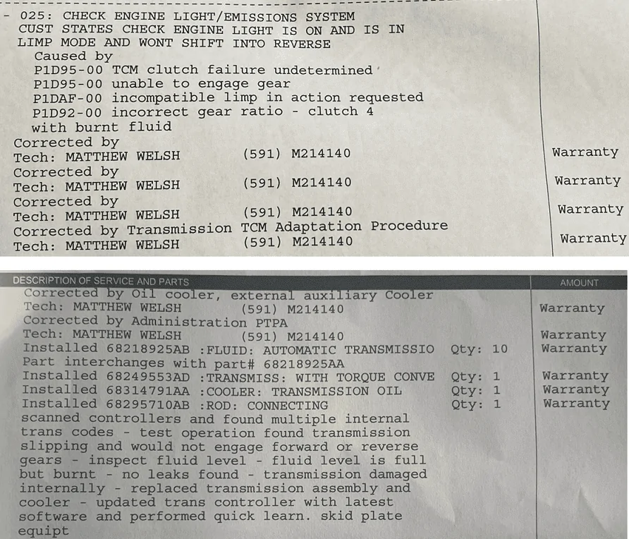

Gas
850RE
Mileage when issues started - 22k
Mileage of failure - 22k
FCA notes - dealer notes below
Symptoms - lost reverse first, eventually wouldn't shift past 3rd
