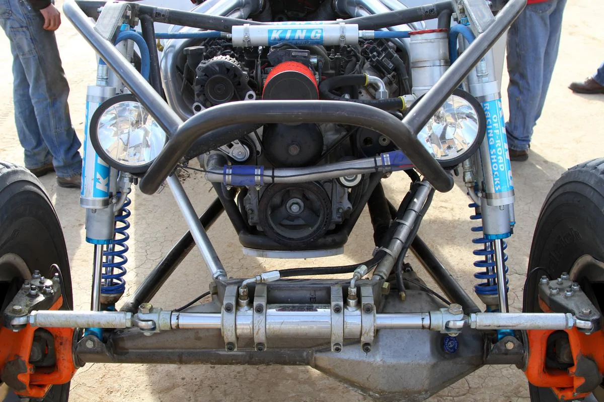

sass JT

MWD

sass JT
Bryan
Jun 12, 2019
1,688
2,880
youtube.com
MWD
That’s a sweet setup but not sure about a daily driver. If you’ve never had full hydro steering it’s awesome for a buggy but sketchy on the highway.
I was was just answering the op’s post... I’d never do that level of custom to my vehicle.
