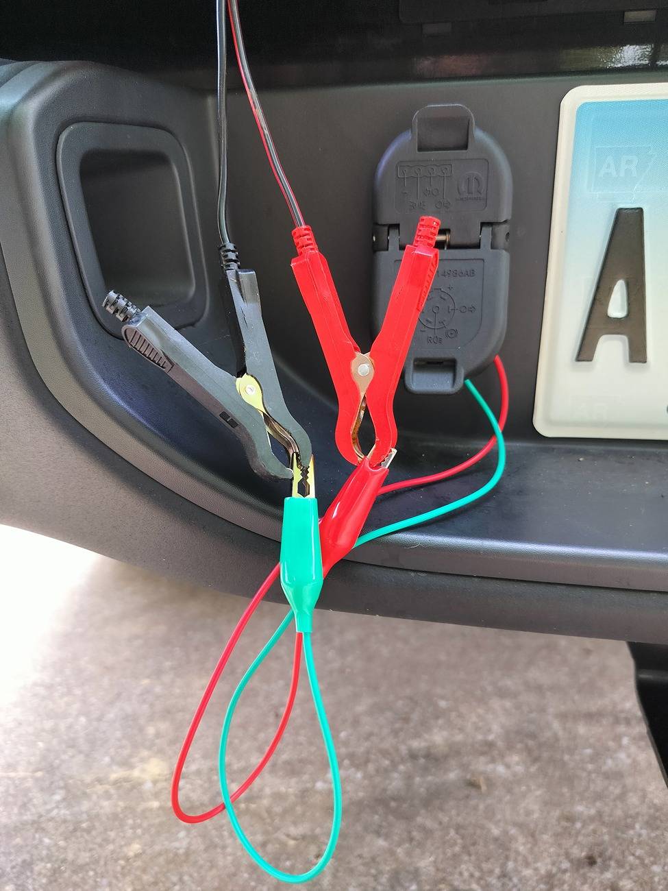

Yep it will work fine.
I don't really care about all the other stuff, but I do consider the ESS system to be an indicator and I do want it working as well.
on your 7-pin plug on the back of the Jeep, the + is always connected straight to the battery and the - is a good ground. I've seen several people wire a battery maintainer/trickle charger to a 7-pin trailer plug with just those two wires and use it as a way to hook your battery maintainer up without having to pop the hood every time. Just don't forget to take it out before driving away!

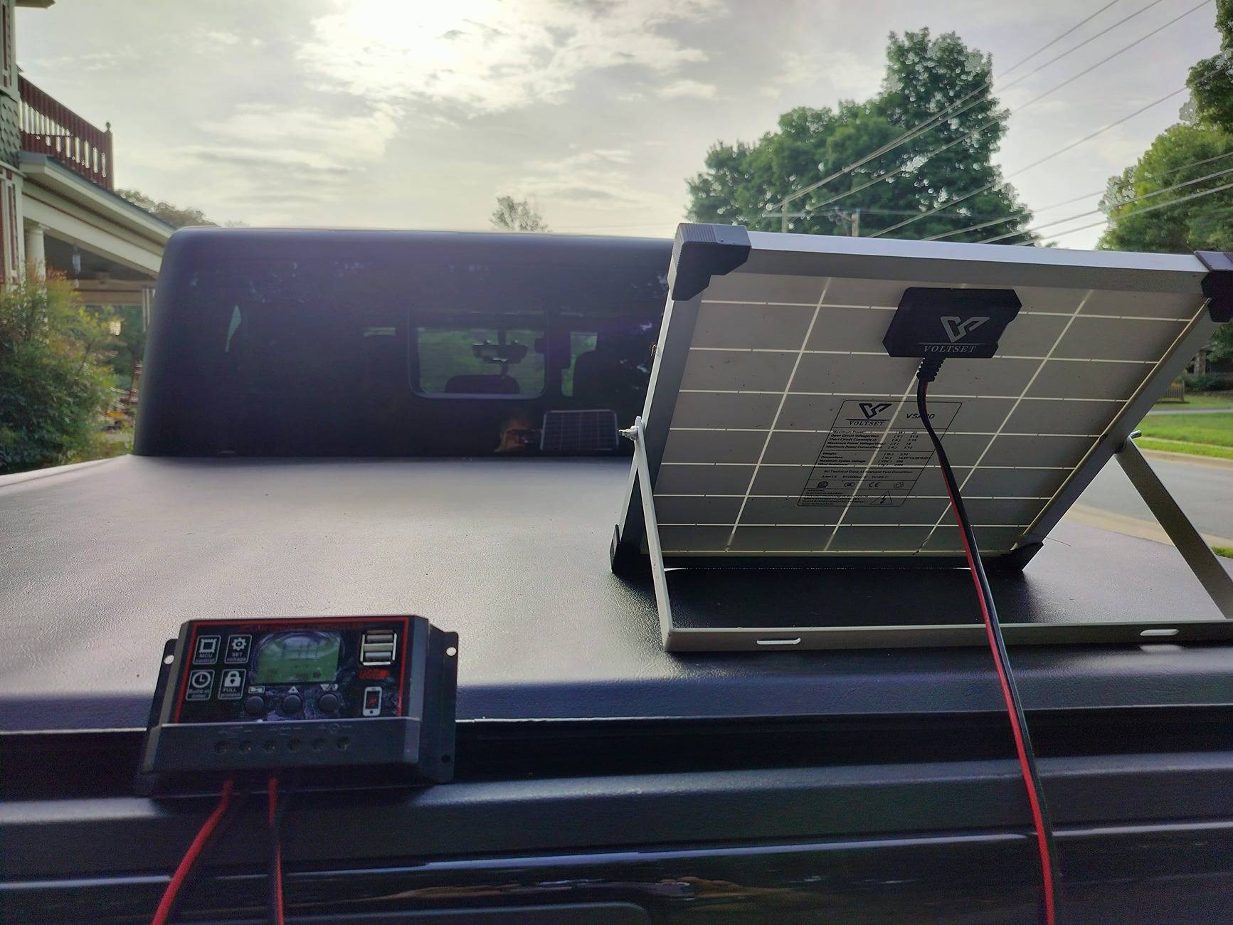

You folks are the best! Here is my jury-rigged system, which seems to be working. Now I need to buy the plug and such referenced above.
Jeep Gladiator Trickle charge auxiliary battery? IMG20240801083820
Jeep Gladiator Trickle charge auxiliary battery? IMG20240801083739
I have the wires draped across the backup camera so I'll see them when I back out of the driveway (in case I forget to remove the system).

A quick way is a 7 pin trailer connector and wire it. I wired one back before there was ones on the market for alternative uses. Main use was for a light duty 2000 pound winch power. Dang that was a long time back. 🙄
Good plan on leaving the wires that way and the solar charger controller. I had a solar charger that killed my 4wheeler battery twice... I just figured the first battery was old and quit, then replaced to kill that one too.
FYI I got a laugh out of your intro bio. :like::LOL:
