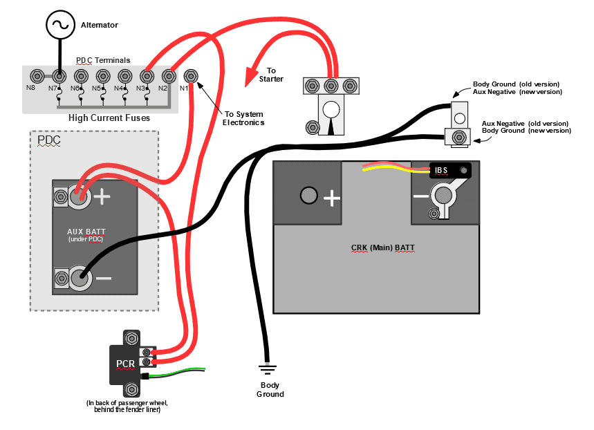

Stole the pic from the JL folks but it is the same on the JT 3.6. The main and aux battery are basically on a parallel circuit to each other.
Trickle charging to the the main battery hookup will eventually charge both batteries. Most trickle charges will charge to and maintain a 13.6V DC surface charge and will be to both batteries as they are in parallel to each other VIA the high current fuse block.
That being said, I use a Schumacher 800ma trickle charger/maintainer on my JT hooked to the main battery terminals when it sits for two weeks ever other two week and have had no issue.
Unless you got a really old or cheap Harbor Freight special trickle charger/maintainer, most of the newer ones are rated for multiple chemistry type batteries.

I'm surprised there is no battery isolator as paralleling two batteries accomplishes almost nothing except for adding a little to the amp hour capacity. The reason you would ever install a second battery is to run accessory equipment which might drain the auxiliary battery and you want to keep the starter battery isolated, always charged and available.
In the diagrams posted here if the aux battery is powering electronic stuff and you leave it on overnight or longer it will kill the starter battery along with the aux battery, so what would be the point of a second battery? Another problem is when starting the vehicle a huge amount of current will be shared by both batteries and the aux battery in my opinion is not up to that task. I believe the diagrams posted here are not complete and there is a battery isolator somewhere in the circuit, or at least I hope there is.
I can't get to my truck until next week and then I'll run some tests like pulling current from the aux battery and see if the starter battery gets pulled down with it.

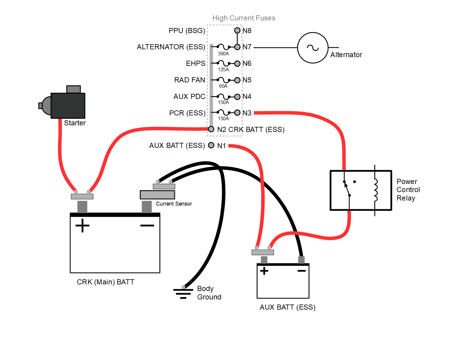

I can certainly relate to your surprise, I didn't believe they would implement a dual battery system without an isolator either, but they did. Here's my newest diagram for anyone interested.

If my testing shows pulling the aux battery down also pulls the starter battery down then I will consider installing a battery isolator and rewiring a few things.

Looking over both diagrams posted I would say (to myself) its incorrect so as not to offend anyone. The little I know is there is a programmable relay to supply some aux power all the time or only when the ignition is on, that could be the PCR shown in the diagram here. If PCR is the programmable relay it sould be between a battery and the switched aux power. The diagram for the aux battery and PCR doesn't make any sense. The PCR relay instead is shown connecting or disconnecting the aux battery from the main battery and not really controlling any electronics down stream.
Don't worry about offending me, if I'm wrong about anything feel free to point it out, but know that I've been looking at this for 3 years and an fairly confident I know how it works.
The only purpose for the aux battery is to power the interior electronics during an auto stop event, conserving the main battery power for the restart. The PCR separates the batteries during an auto stop. Otherwise, except for a quick aux battery test during a cold start, the batteries are always connected in parallel. Always means running and not running.

When you say "The only purpose for the aux battery is to power the interior electronics during an auto stop event, conserving the main battery power for the restart", that is more in line with what the posted diagram shows, meaning the aux battery is not a typical 2nd battery to power electronics in order to save the starter battery.
In that case the aux battery would provide continuous power for "something" when the engine is temporarily off during an auto stop and without the typical dip down to 11 volts or lower when the starter is engaged after an auto stop. In most of my vehicles full of 2-way radio equipment, most of the radios will power cycle if turned on when the vehicle is not running and you then hit the starter, so Jeep has gone to some extreme lengths to avoid that.
So if all of the above is true the PCR relay is not the programmable relay for aux power switches giving you continuous power or power only when the ignition key is on. Its only for the auto stop thing which I don't plan on using. This has been very interesting, thank you. I think.
It's as simple as this. The original auto stop systems used a single battery and if you think about it, the odds were very good that the battery would fail trying to restart in the middle of traffic. The aux battery was added to supply power to the electronics during an auto stop to avoid draining the main battery and reduce the likelihood of the main battery failing during an in traffic restart.
I think that part works as designed, but a dual battery system using dissimilar batteries and no battery isolator has introduced a lot of other issues.
