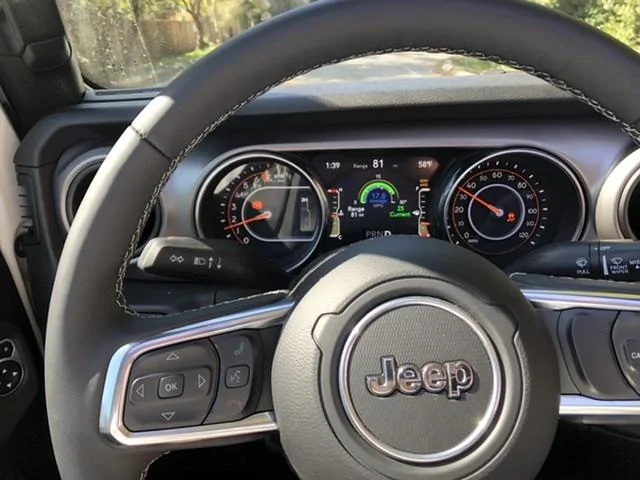

600miles on my gladiator I tried 4WD and 4WL. Bone stock.
got CEL

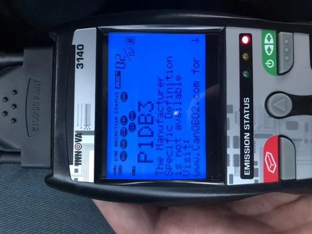

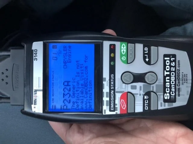

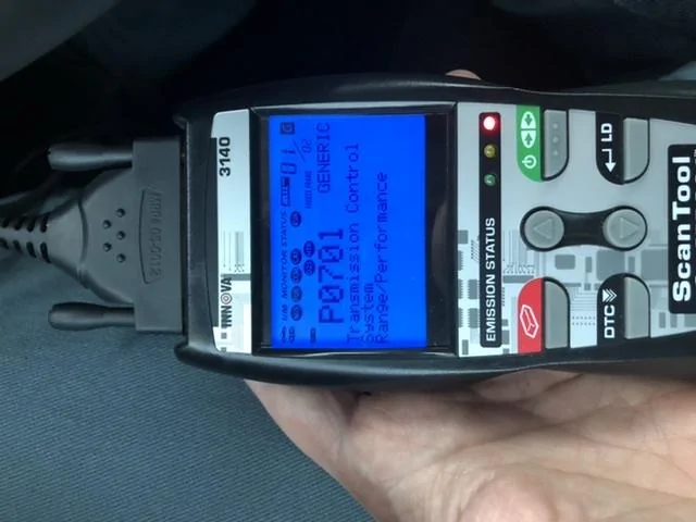

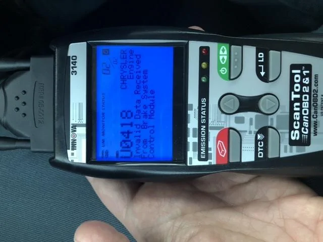

I found my old scanner, it worked fine.
u0418
P1db3
Theses seem to be associated with lift and tires. Luckily I’m still stock.
