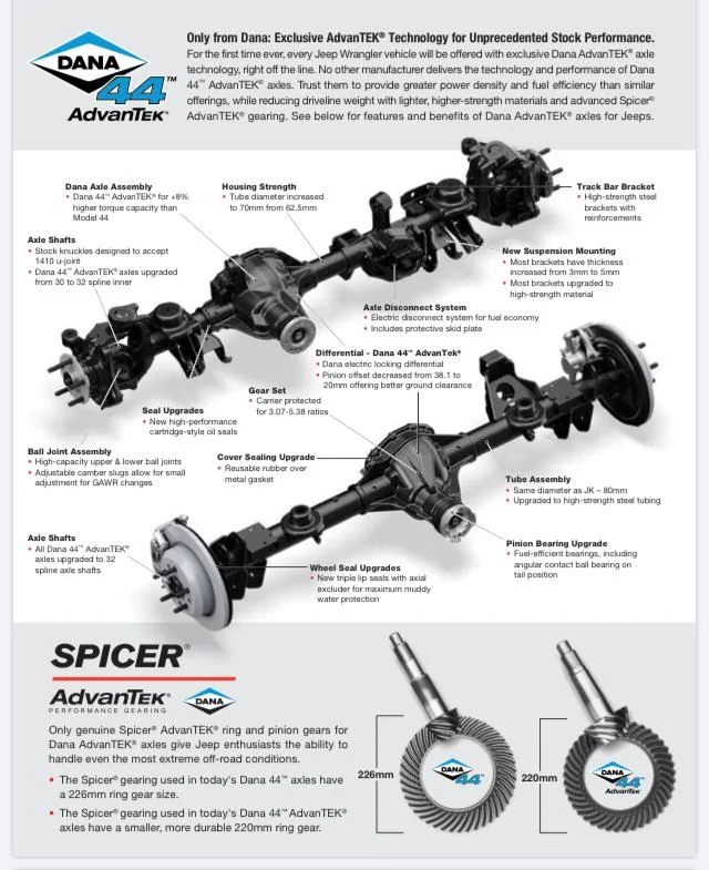

All Advantek 44s have 32 spline shafts. Here is the info on Advantek axles:
https://media.spicerparts.com/cfs/files/media/82zRkJu59KQ7gJBaf/PERF-JLADVANTEK-42018.pdf?token=eyJhdXRoVG9rZW4iOiIifQ==&store=original

where does it say 35 spline? i only see 32 spline, until your post i had only heard it used to be 30 spline and new stuff 32 spline, so haven't seen 35 mentions anywhere yet?

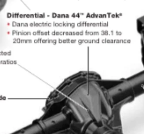

Exactly, that is the issue. Wrangler/Gladiator Non Rubicon is 32 spline. Rubicon is 35 Spline....... No Truetrac/ Gleason/Torsen support. Did you notice there is no mention of any traction aiding device.
You are incorrect. ALL Dana 44 Advantek axles are 32 spline. It says that right on the left side of the page. It mentions locking differentials right in the center. Put your glasses on...
