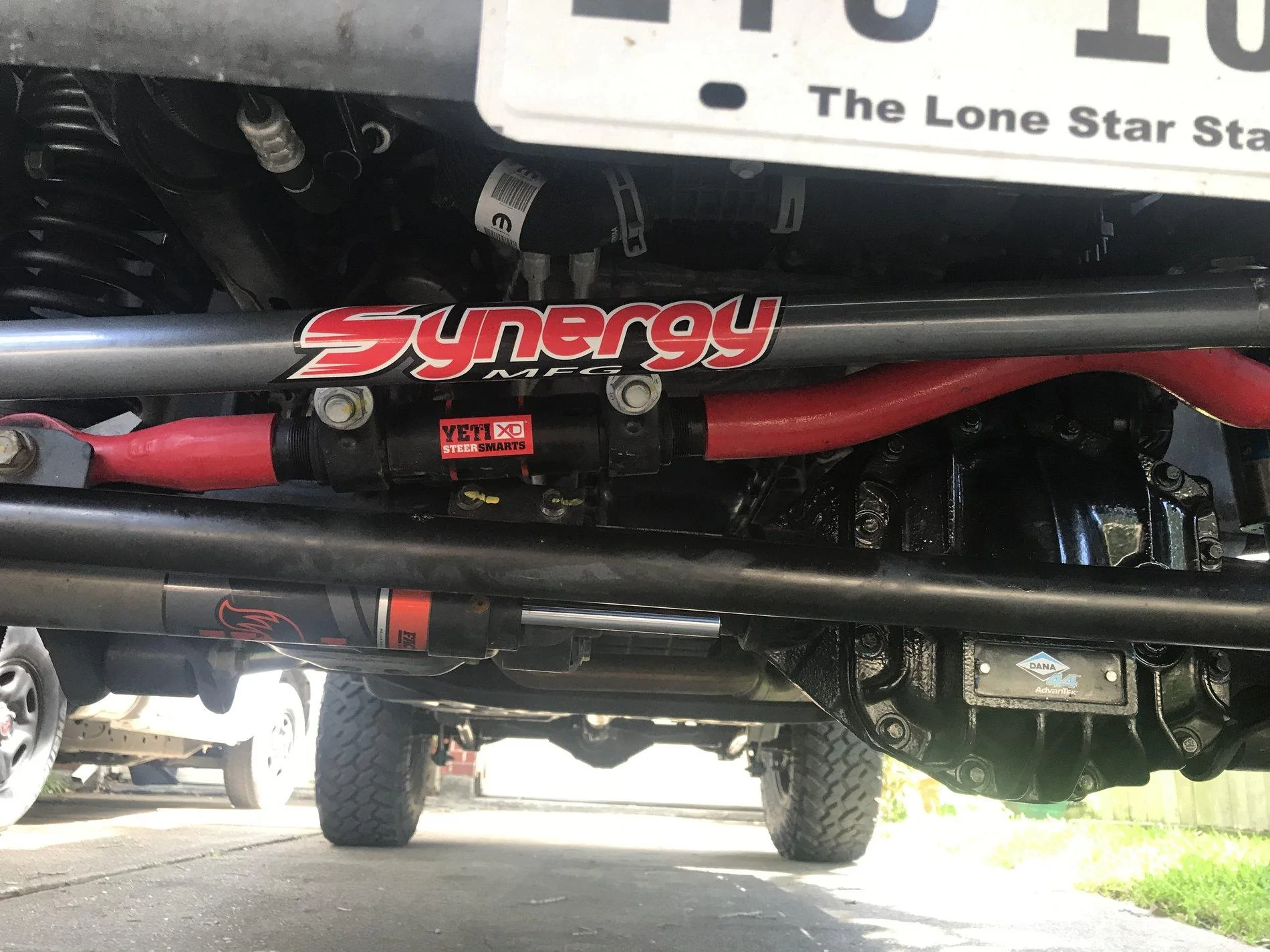

I have no experience with the Core 4x4, I have run both front and rear JKS in the past on a JKU.
JKS is good quality stuff.
Take a look a Synergy Mfg also they have a real good rep in the industry.

I will, thanks!
