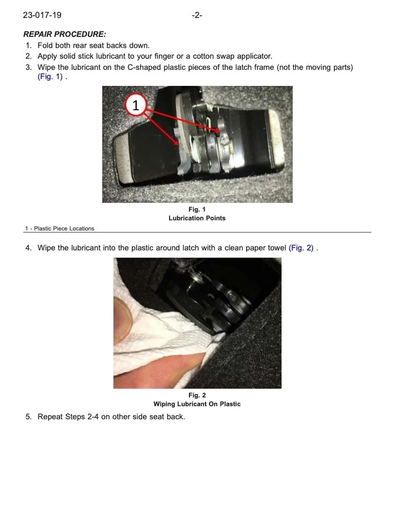

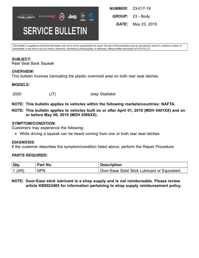

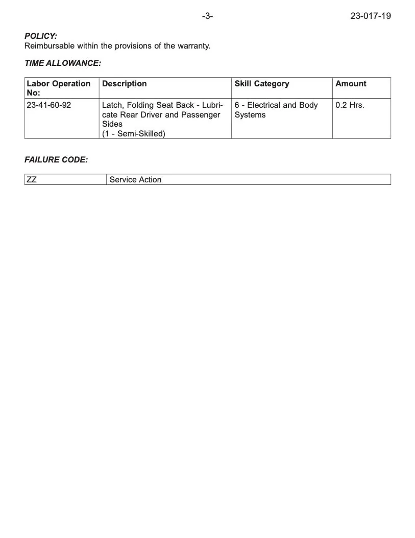

    Subject: Rear Seat Back Squeak
    Overview: This bulletin involves lubricating the plastic overmold area on both rear seat latches
    JT_tsb_23_017_19_page_1.jpg JT_tsb_23_017_19_page_2.jpg JT_tsb_23_017_19_page_3.jpg

    Too funny. I've had a squeak for about three weeks that I couldn't figure out where it was coming from. I could tell it was coming from the rear seat area. Since I couldn't pin point it myself while driving, I asked my wife to sit in the back seat to see if she could find it while we were driving. Of course with her on the rear seat the damn thing wouldn't squeak. I saw this bulletin and put some lube on the area as described in the bulletin. Yep....no more squeaks!!!
